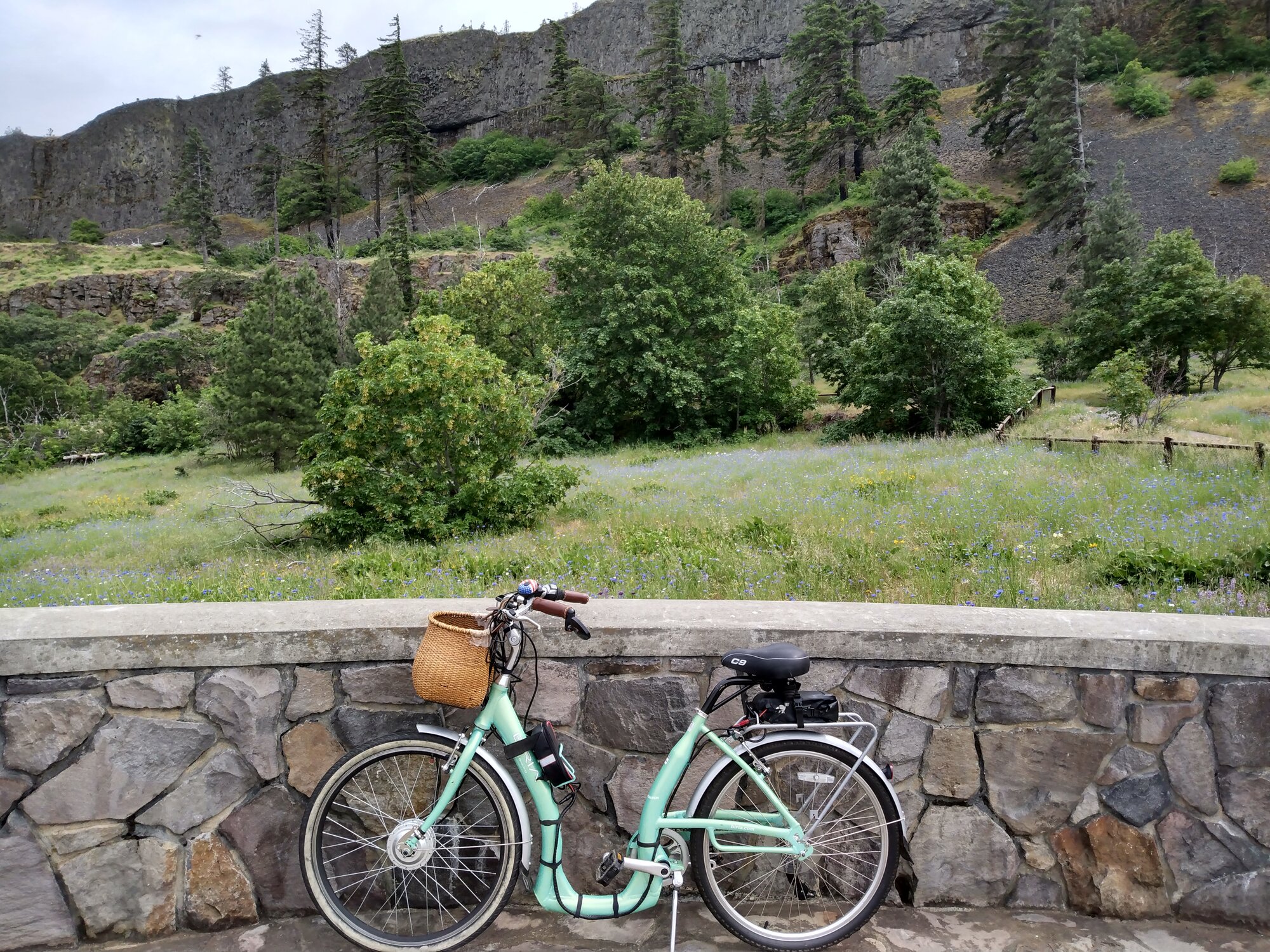

My wife's diy 36v geared front hub assist bike on a hilly route.
@EMGX, I like your wife's basket. She's got a styling bike. I bet she loves it. @Gordon71, I know that there is that whole Walmart market and internet only market. You are right that it has to be huge. That article is geared to bike shops. I am writing this as my soldering iron heats up. How is the oyster harvest this year? Do you do a chowder? What goes with it?
she does love it, which is good because it is the only bike she is able to ride anymore. She needs a throttle to get started but after that does her best and can pedal without assist on flat areas.

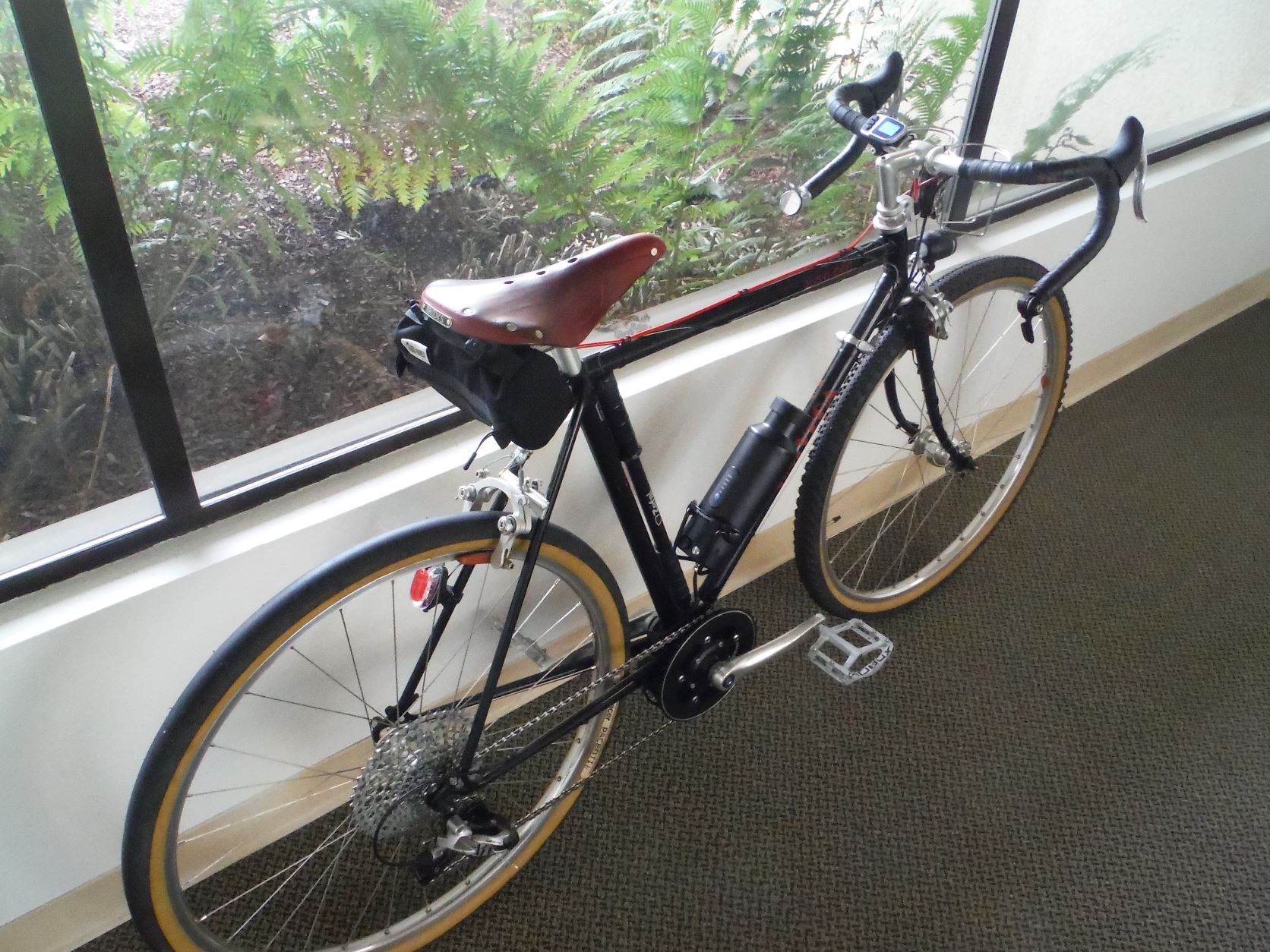

Love the classic Brookes saddle! My old butt is too fragile to break one of those in.

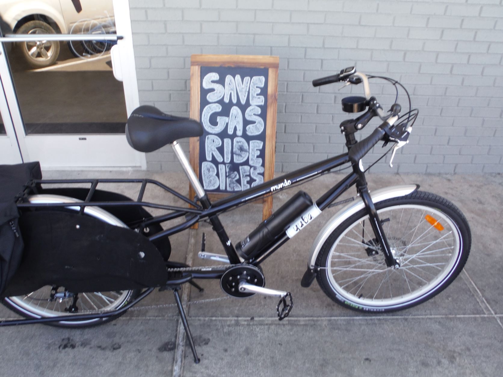

Thanks @AHicks. If I can do this, anyone can. I just came back from a follow up for a cargo bike I made yesterday. It is heavy as hell. But it also carries 200Kg, 440 pounds on the rack alone. It is replacing a second car for a young family. They have been spending $400 a month on gas. A new e8 Mundo goes for $5300 after tax and without accessories. I purchased this for less than one tenth of that. That is the kind of margin that is getting hard to overlook. The e8 has 60Nm this one has 90.
