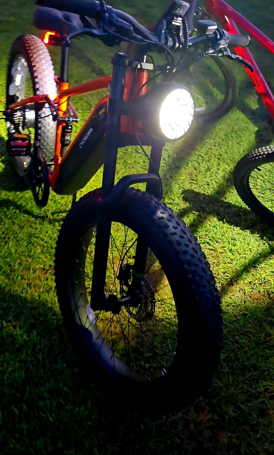

Yes I guess I'll enjoy it and just upgrade as parts break. I just got back from a night ride with my wife and 10 year old daughter. Bike lights on. Helmets on. Crisp cool air in my face and making fun memories with her. I'm definitely loving this hobby and my bike! Thank you all for your advice. Looking forward to learning more on the forum.
