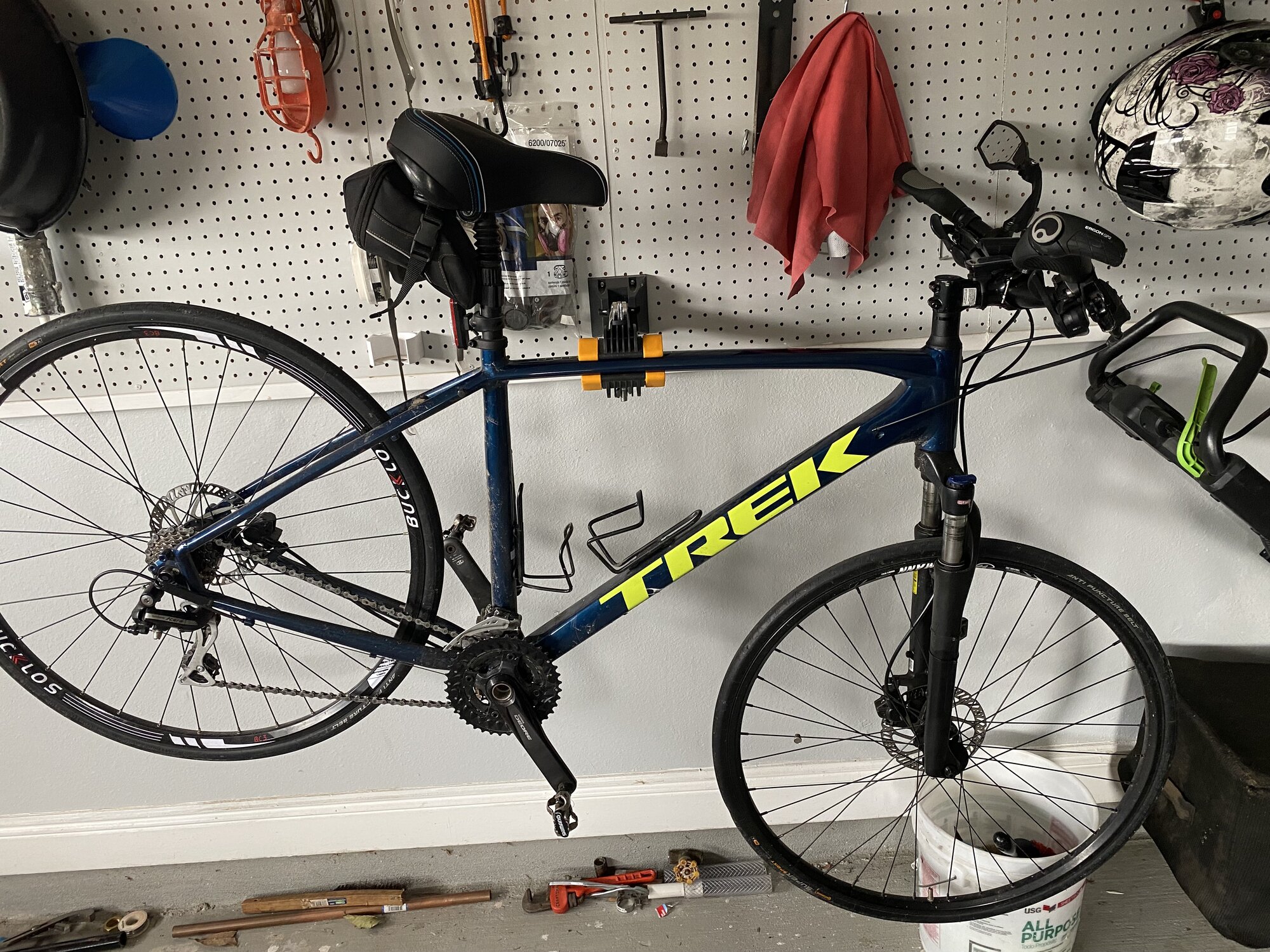

Bike: Trek Dual Sport 2
Bought from Electrify Bike Company
Mid drive Motor TSDZ2 OSF Upgrade Motor Kit 250-750 W, 860C Color Display for TSDZ2 OSF, 52v 40-AMP 17.5 Ah Jumbo Shark E-bike Battery, TRIPLE BOB MOUNT FOR SHARK BATTERIES
Bought from Luna
Luna Charger 52V Advanced 300W Ebike Charger
Biggest concern for me riding Ebike: Will power!!! I'm scared that I will use the assist more and more until I am no longer really getting the amount of exercise that I need. The beauty about going on a out and back ride is that most of the time I am riding back, I am tired. I probably would pedal less if I could - but I can't. I have to get back home. If I had an ebike, I would be lazy. Time will tell.
I will start disassembly today. I will document my build hoping that someone can find something useful.

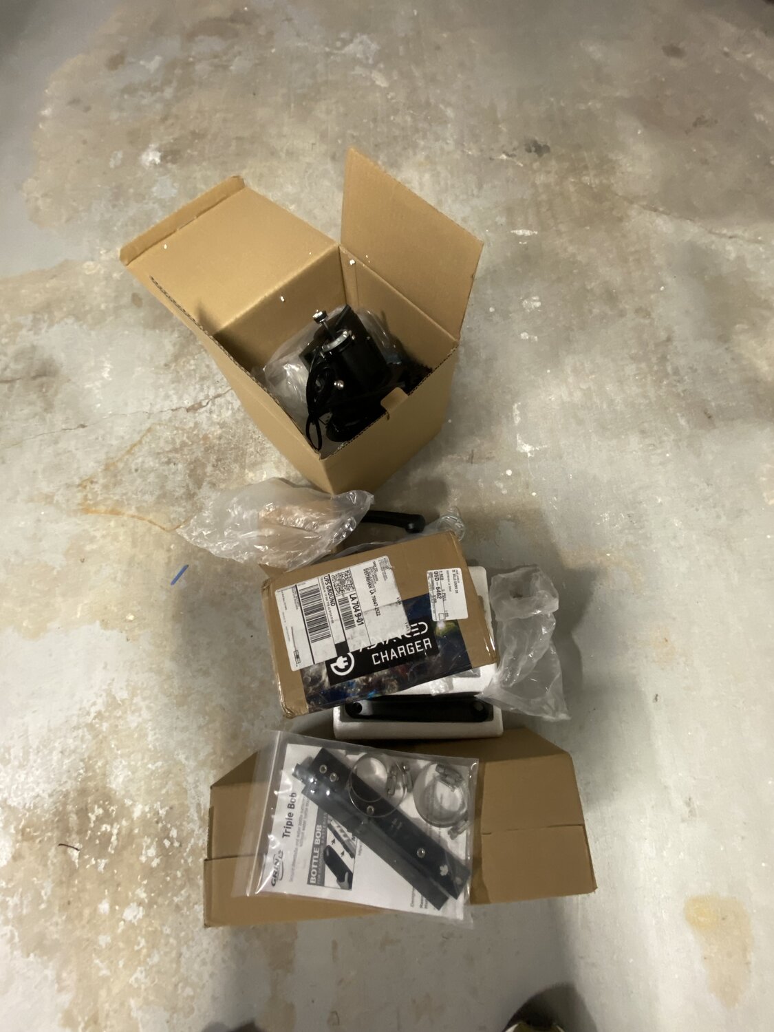

I began the install by spreading the boxes out on the garage floor.

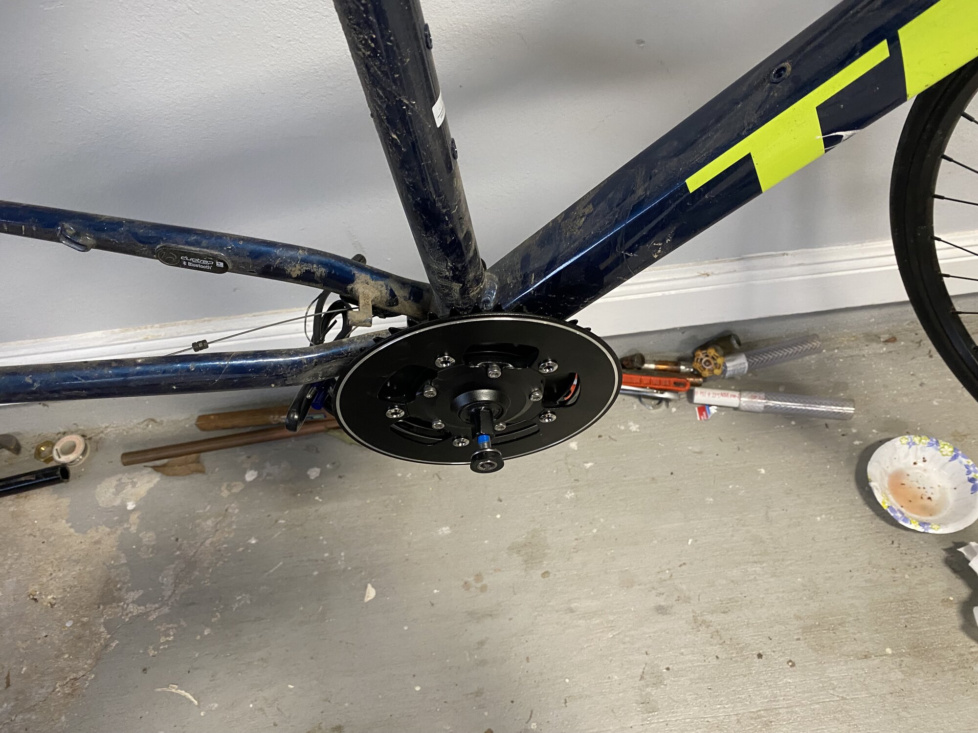

I removed the crankset and BB.

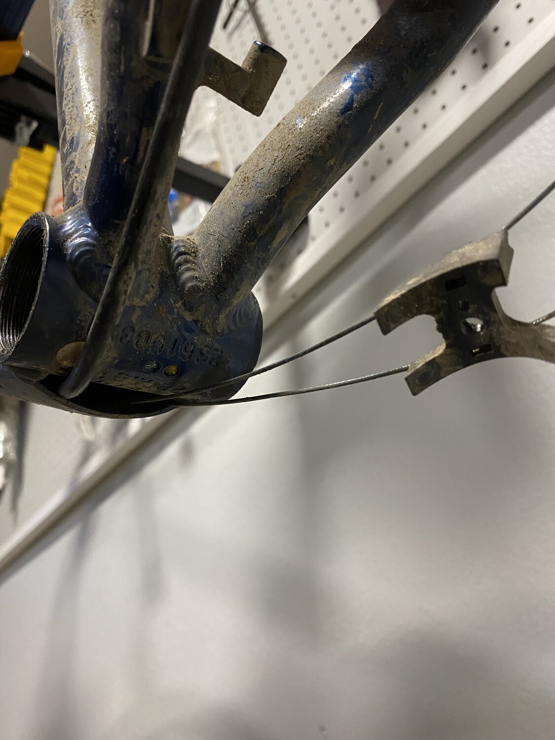

I removed the cable guide below the BB because the screw protruded into the housing. I left the cables to see if the three cables would still fit with the motor installed.
I tried to get the motor installed with the brake cable still below the BB - but it wouldn't fit easily. I probably could of forced it, but I decided the cable should be re-routed. I then had to wash my hands and look at You-tube. I never have dealt with hydraulic brake cables. I disconnected at lever and figured that I couldn't pull the cable through the frame. I disconnected the cable at the disk end, and clipped as small a piece from the cable. Hopefully it will be long enough when I re-route it.
The motor slipped right in. I installed it per instructions.

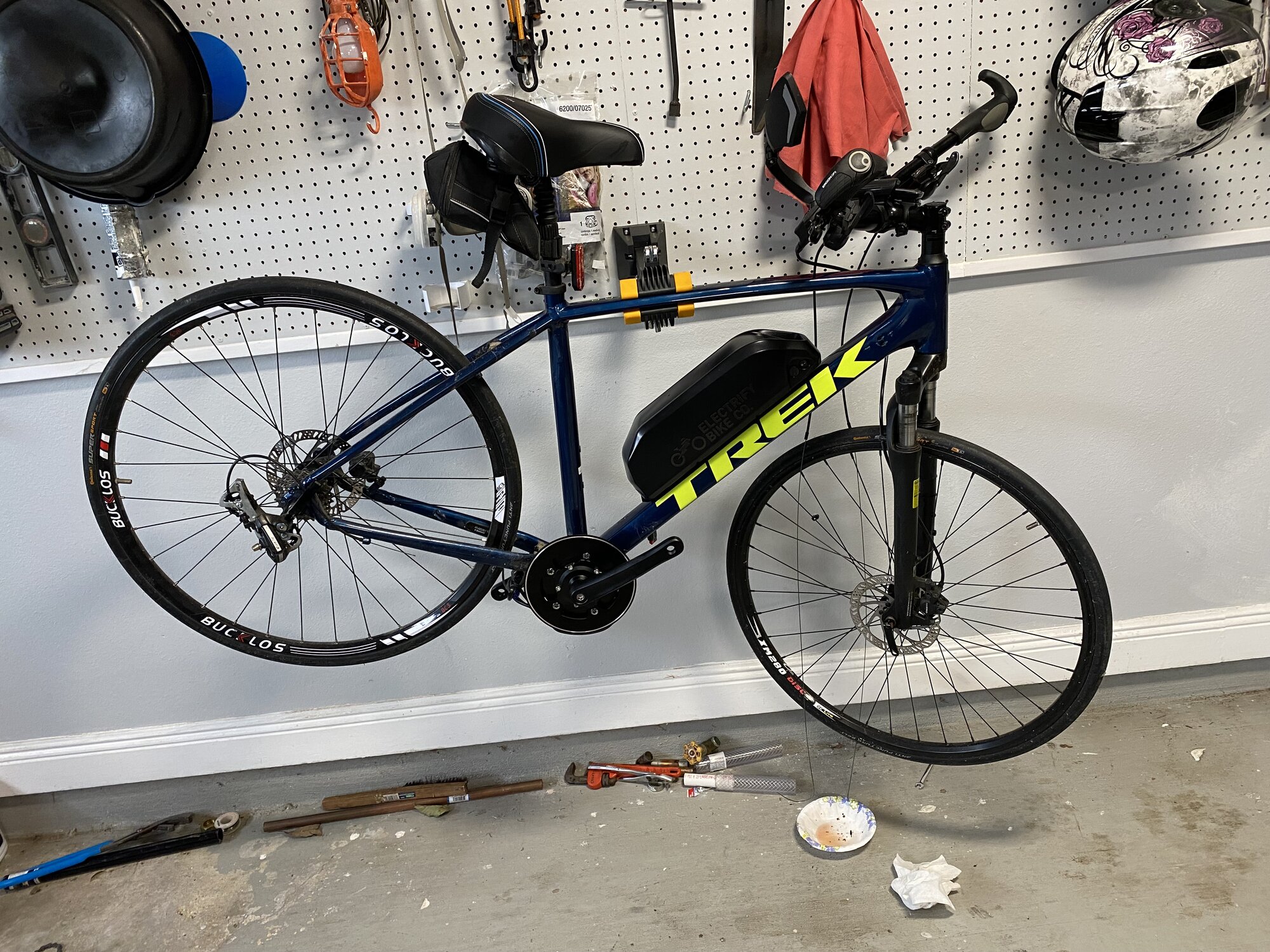

I mounted the battery to check the weight and appearance.
I decided to quit for today since I needed to buy a new shifter cable and brake parts.
