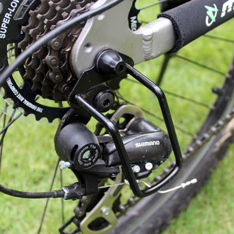

I got out in the neighborhood for a 3 minute ride. Seems comfy, think it will be fine when all is done. I found 2 issues so far…it doesn’t shift quite right and couldn’t get in to 7th gear the lowest gear. I also heard a rubbing noise and on 1st go through I don’t see anything rubbing, hoping it is the rear brake.

Check the derailleur, sometimes they come bent...
I wouldn’t know a bent derailure from a bent spoke stick so off to the LBS. also if the derailure needs replacing can it be replaced with an upgraded version?
It's actually the derailleur guard. If it is bent in towards the wheel, all you need to do is get a hammer or large screw driver and bend it back out...

With a little effort it can also be bent out by hand. I didn't have any tools handy at the time and I was able to bend mine out that way. I just braced my feet against the frame and pulled the guard until it bent out enough to let the derailleur shift to 7th gear.
Took the bike to the shop to get the derailure adjusted and deal with the scrapping noise. While I waited he adjust the derailure and allingned the brakes both improvements (meaning it was rubbing and now shifts to all gears ) but still a noise is there . He couldn’t see anything and I couldn’t either so I left the bike . Too cold to even test ride and tomorrow I hope to be cleared by a neurologist to really start full time riding again. He said he would remove the wheel and figure it out.
