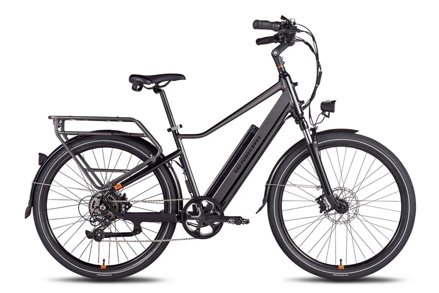

New Rad City, as expected now a geared hub
ExPatBrit
About time, looks much better.

Holy cow.....They did it, and it's right in there regarding price. They're in stock, and there's even local assembly available. This will be a home run for them....
Nice bike, but sad to see the price increase along with all the no-name (RAD) components. With all the no name components and drive train down grade I would have expected they could hold the price even in the current environment. I suspect their markup on this is now much more than in the past. Looks like a great bike over all though. Love that they went with 27.5" wheels.
The no-name components is pretty common now, as they grow their business they will contract with the suppliers to brand it as a Rad part.
My current e-bike has hydraulic brakes branded with the bike assemblers name, but they are Tektros.
The price increase is somewhat justified, geared hub, hydraulic brakes and the new wheels are great.
During the pandemic peak, used Rads were selling for more than some folks paid new.
They will sell out real quick.

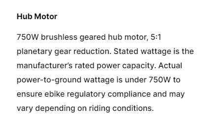

Is it a 'real' 750 hub though, or the 500w core? I thought the true Bafang 750w Hubs were limited to fat widths?
Yup, saw and wondered the same. Also saw that they were claiming the manf wattage rating as you show above. Trick here is they aren't claiming it's a Bafang motor either, or if so, I've missed it. To further add to the mystery, conventional motors (not Fat motors) generally run 135mm drop out dimensions. Here, they're saying they running 154 mm.
Dropout Width
Front: 100 mm (this is normal)
Rear: 154 mm (this is unusual)
That's kind of an unusual dimension....about half way between the conventional 135mm and the Fat 170-190mm you see. Not sure why that might be?
Ahh, I think I just read into it based on the Rad Rover history. Will be interesting to see how it tests.

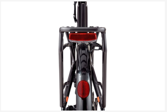

And if you look at the rear shot, it seems like it's got an unusually wide rear stay spacing, and significant offset. More than you need for just a disc brake...
It would seem if the rear spacing is in fact 154mm that it is an odd non standard spacing. Strange but along with the branded components and moves like the odd wheel size of their cargo bike that they may be looking to get some after sale action going from their brand loyalists. Need a new derailleur? Might as well get one from RAD etc.....

The custom motor and drop out spacing go hand in hand. The motor wires are on the non drive side and do not come out through the center of the axle. This requires some extra space I guess with their motor. Looks like they took a page from the Grin motor design book, but probably not for the same reasons.

Same motor as the new Rover 6 Plus. The cable entry on the brake disc side is better IMHO much easier to switch out the freewheel. As to the rest of the components until someone gets their hands on one we don,t know. I suspect it’s private label stuff.
Bafang makes a motor with cable exit on the left side also, this could be a clone or not. I do see the spokes are thicker on the rear wheel. Not sure if they did that on earlier models. I have heard of broken spokes on older RADs.
