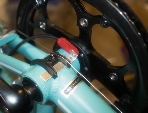

Have you checked the PAS sensor on the pedals? If it is a two piece unit with a separate magnet disk, one common problem is that the disk slipped on the pedals and is positioned too far from its sensor, They can be found on either side of the pedals,

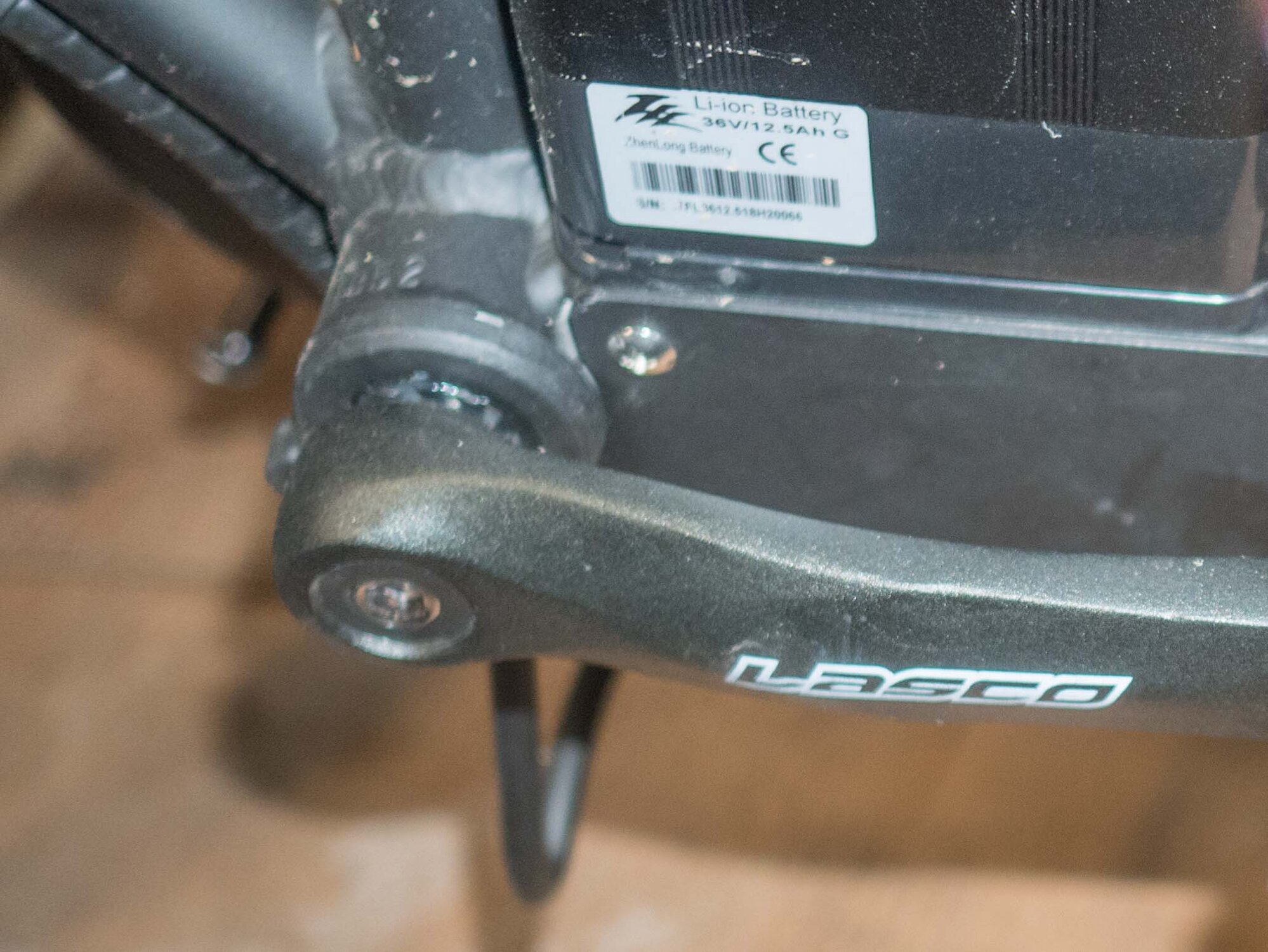

The pedal sensor is on left crank but I can't see a magnet anywhere on wheel where else would it be?

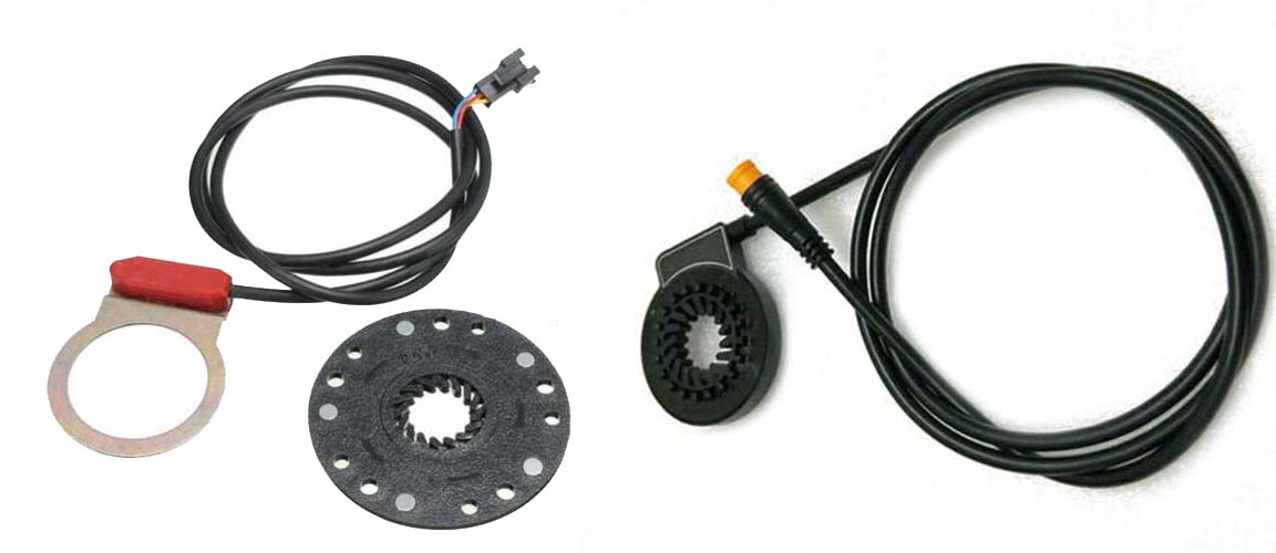

If it;s a one piece unit, the disk is enclosed in a housing like this one. There's not much to check visually on one of these. I have seem the plastic that grab the axle deteriorate with age, and then they slip and don't turn.
If you still cant find it, show us a picture of the left side of pedals.
There will be a cable coming out of the unit. The electrical check starts by following where the cable connects to the ebike electronics and making sure the connection is intact. If that looks good, then the next step ,if you don't have an electrical background, is to buy an exact replacement, These are fairly common on ebay/amaxon.

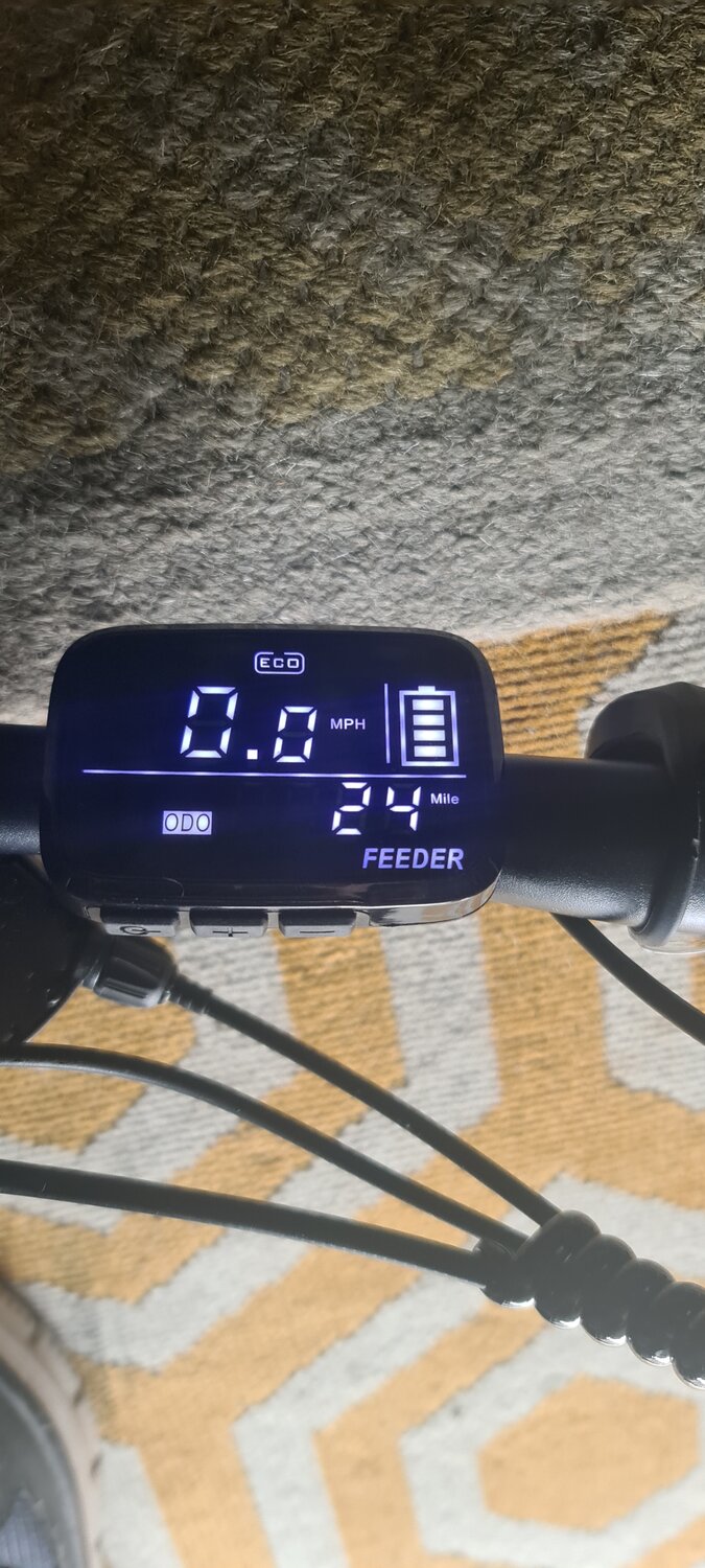

There are some scenarios where you could have been fooling around with the controller settings and turned off pedal assist. You have to find the manual for your display to see if you did that,

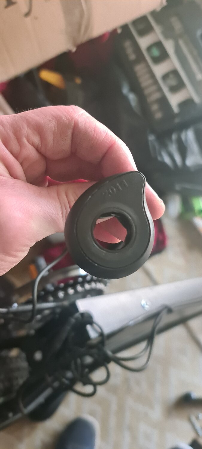

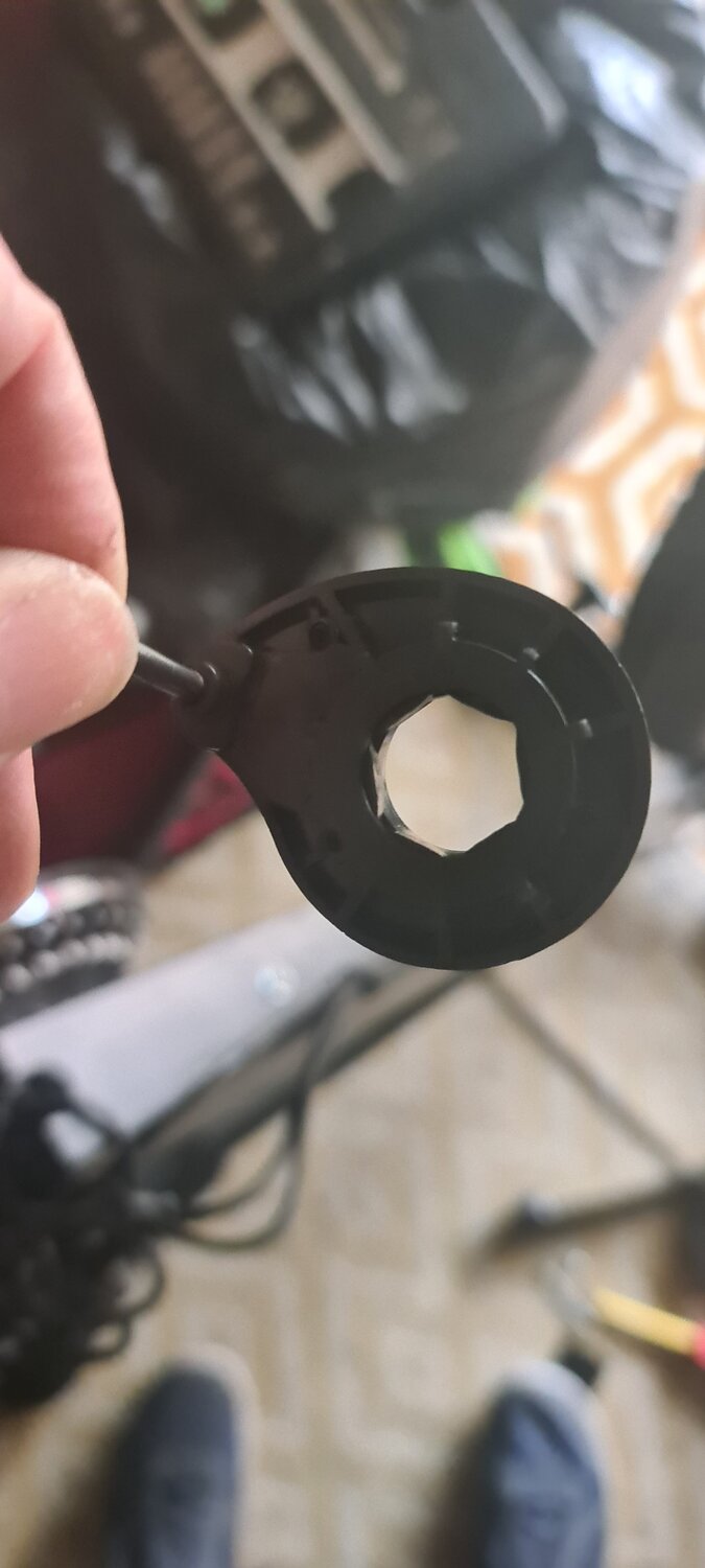

I have taken sensor off I unplugged connection and reconnected it and refit sensor but still nothing pictures of sensor and control panel attached.

If you lift the motor wheel off the ground, and turn the sensor with your finger, does anything happen?
You probably want to try a new sensor. There's only three wires in the cable..^5V power, ground, and signal, The signal will toggle between 0 and 5V when the sensor rotates. Some of them have an LED that lights up to indicate they have power, Don;t buy that type unless yours is like that,
Do you mean when sensor is on crank or like in the picture in my hand? I've ordered a new one anyway just to see if it is a sensor issue
@harryS is spot on in all regards here. I once worked on one where pedal assist did not work in the lowest power level. There can be weirdness like that as a factor that is not linearly logical in diagnosis. It was a warehouse closeout for a reason.
Well it's not working on the crank. Maybe it's slipping. Won't happen with your fingers turning the center section. Make sure your helper has the wheel is off the ground (being an optimist),
Ye I recon its not turning on the crank it's probably slipping
An idea maybe I could try is put some electrical tape on the axel then put sensor over that then it won't slip maybe
Does it have to fit on crank in a certain direction
Yes, that is very important. The idea of having a friend lift the rear of the bike is very good. That way you can test it with your fingers and mark the left outboard side with tape before installing it.
Use something like silicone gasket sealant to secure it. That would work much better than tape.
The new sensor I got was a much tighter fit but the connector was a female not male so I've put silicone on old one to see if it stops it slipping
