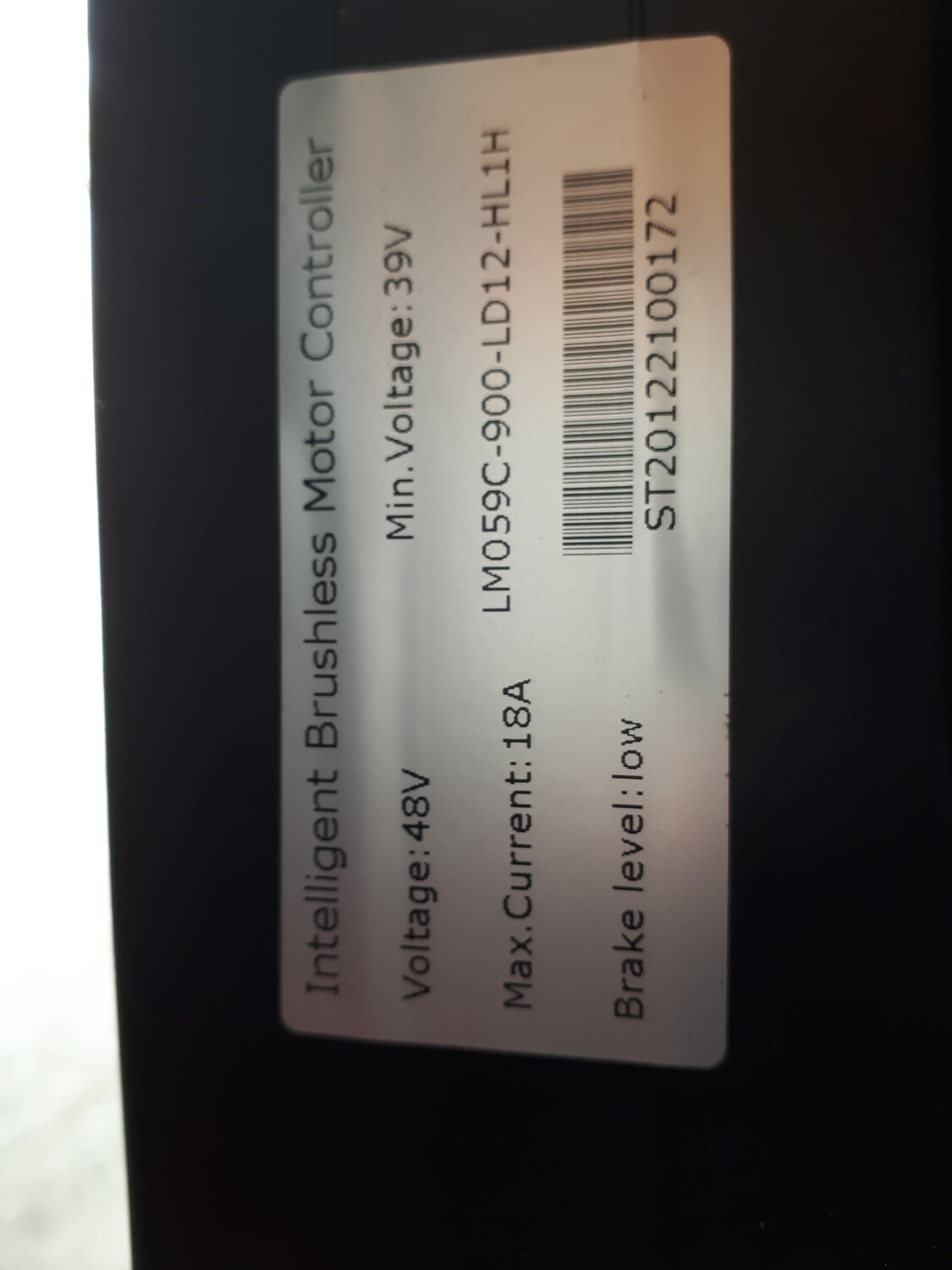

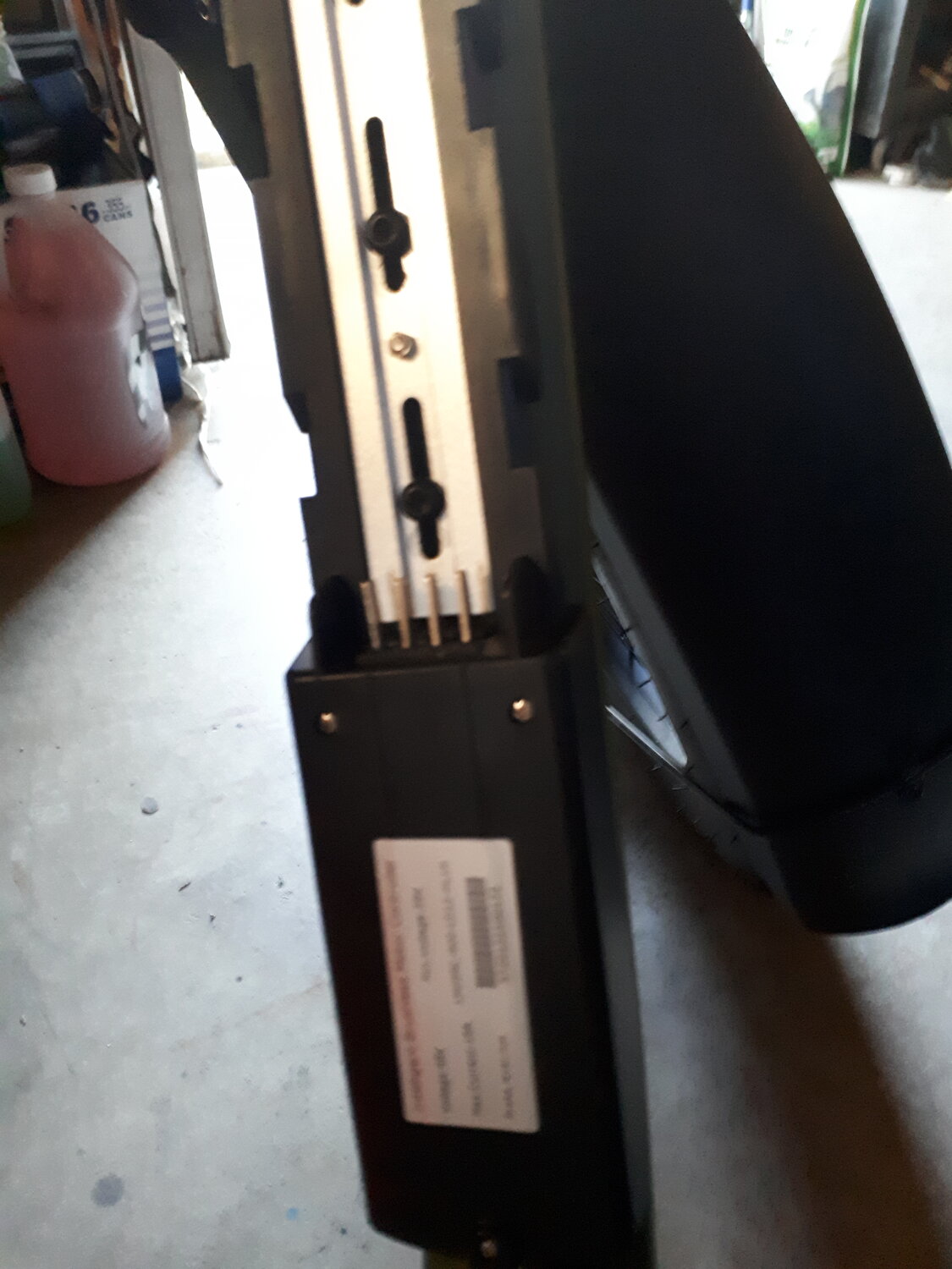

I am having a hard time finding this controller. I sombody could help me locate replacement that would be great.
A picture of the middle of the battery cradle isn't enough info. You want to open up the cradle and have a picture looking at the controller and showing its connectors. You also want to describe the display that it's using, and controllers are display specific.
Sort of like this model, which is only for KT displays, and certain Hailong battery cradles.
