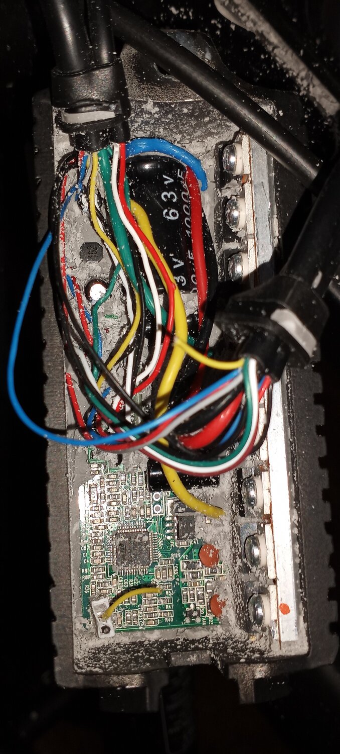

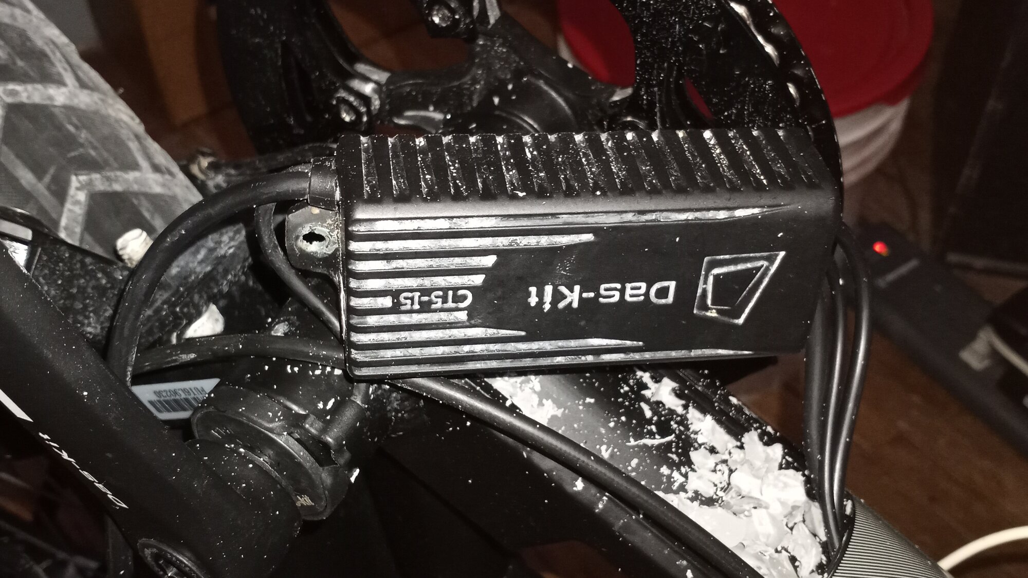

I have a Das-Kit powered ET.CYCLE T1000 and I'm pretty sure it has the same controller. CT5-I5
The controller is fully potted and you can't see any of the components inside.
The good thing is that the controller is as tough as nails and the box is solid cast aluminum.
Chances are that your controller is fine.
I suspect that the brake switch or wiring is shorted.
If the controller thinks a brake is on, the motor is disabled.

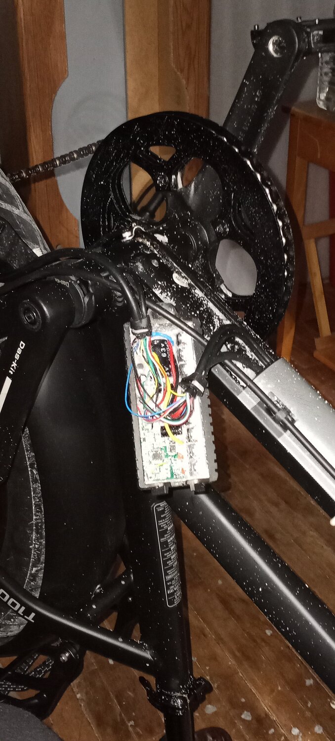

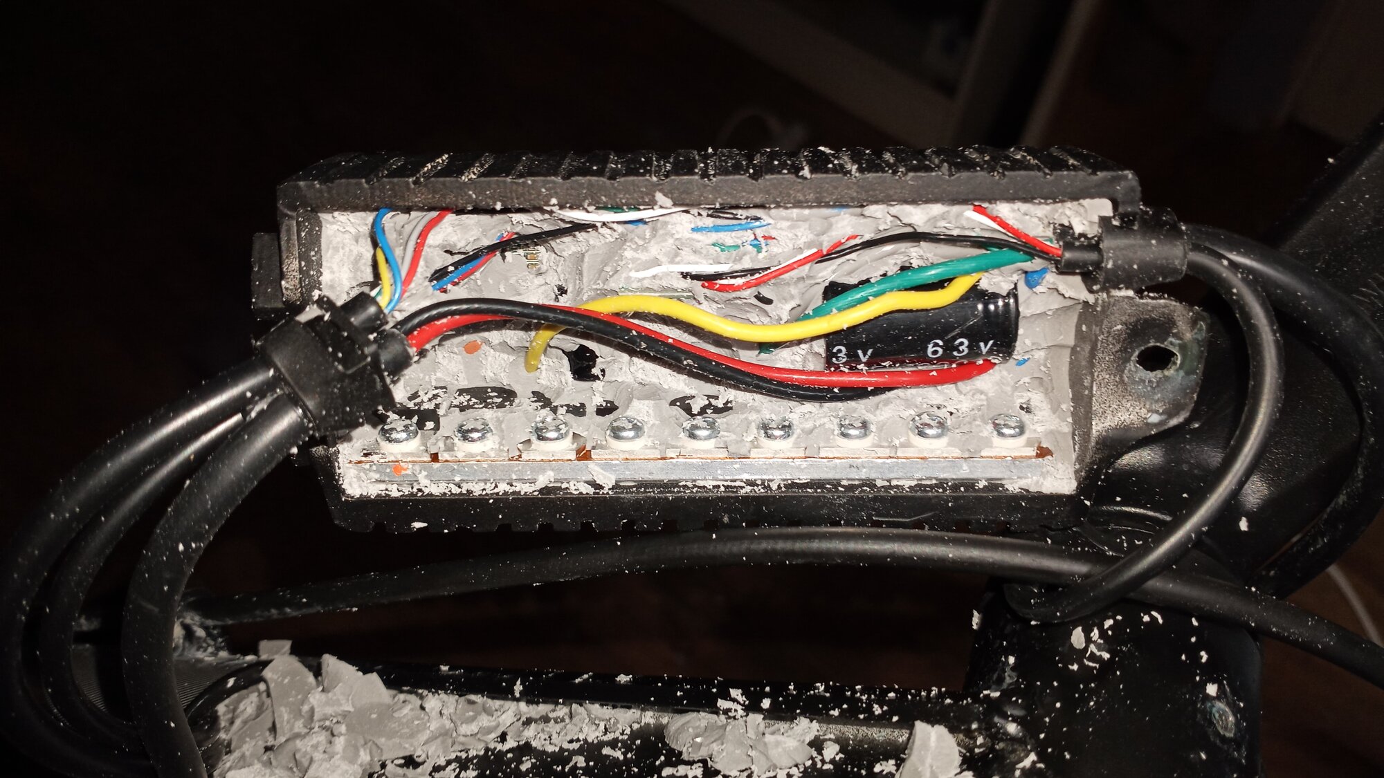

I had to use a dental pick to dig out the potting material to get at the wiring.

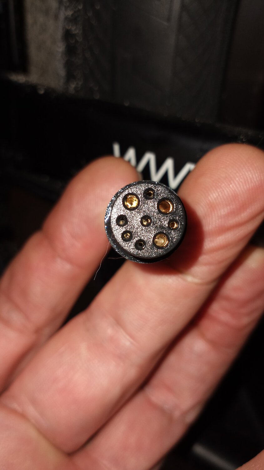

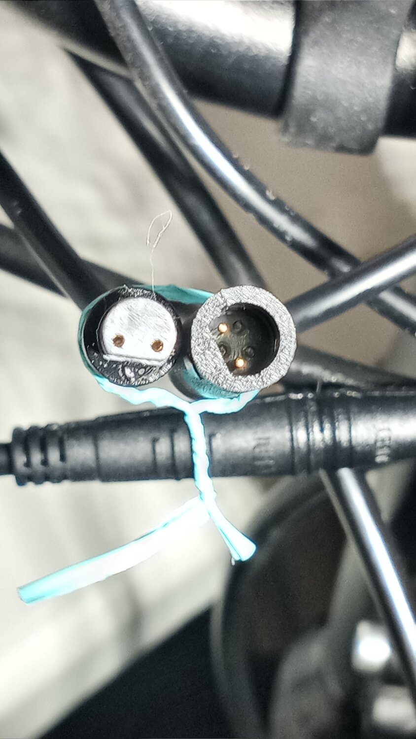

Check your motor plug for bent pins or corrosion.

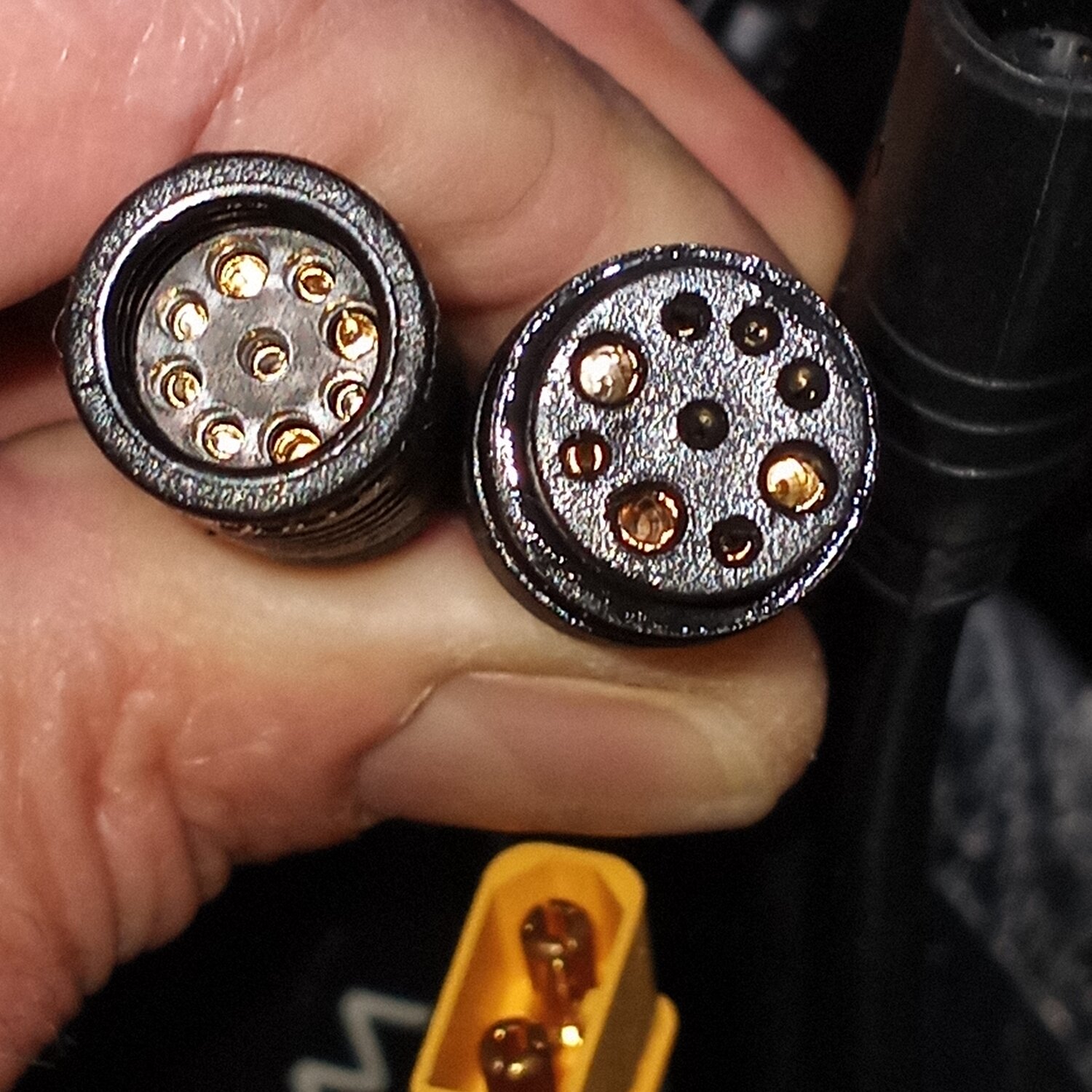

My T1000 has a bigger motor and a different motor plug, so I had to cut the cable off and wire it into my new controller.
If your speedometer is working, then the speed wire from your motor is connected and working.
I figure that either the controller is not sending the power to the motor, or the power is not getting through the motor cable connector.
Make sure it is clean and all the pins are making contact.
Make sure it is fully seated.

I ran into problems when my motor cable connector was different with my bigger 750w motor.

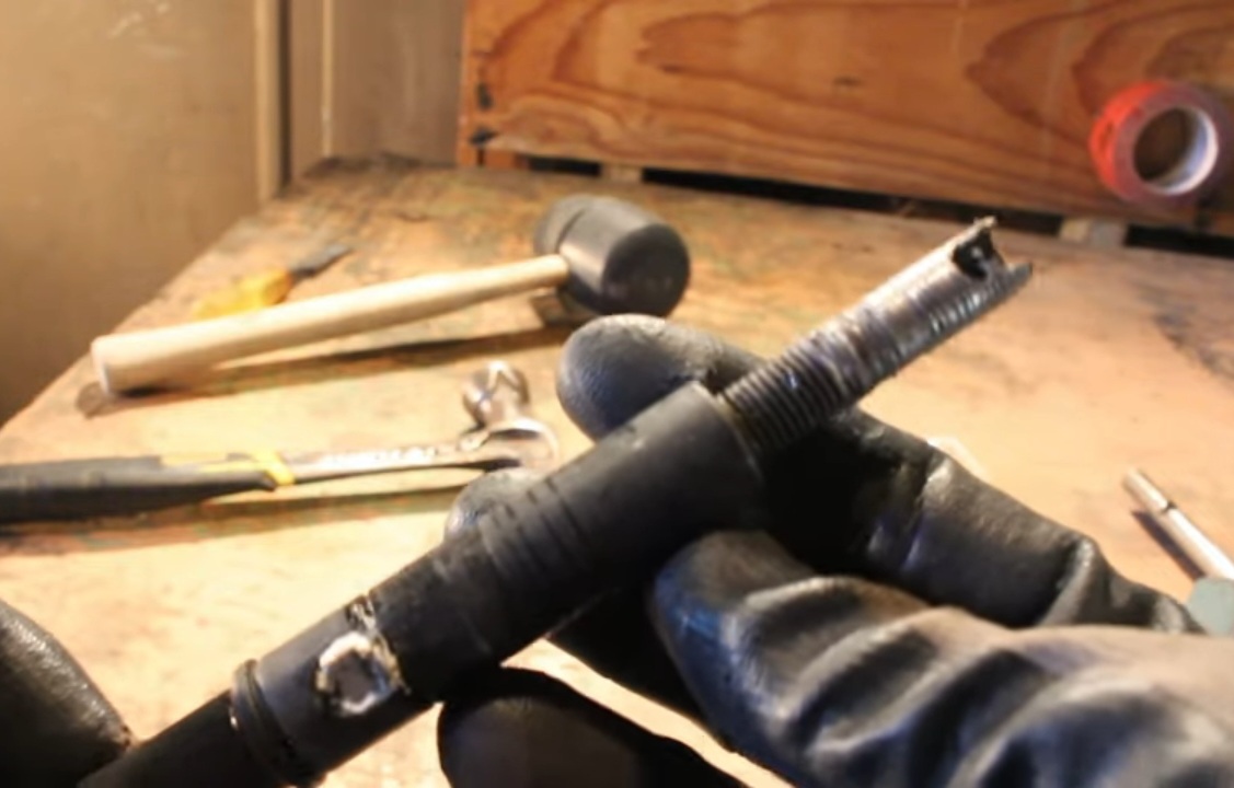

The hub motor axle is hollow, with the cable running through it.
(I took the picture from YouTube)
If the axle snapped, it could cut into the cable shorting out the controller and burning it out.

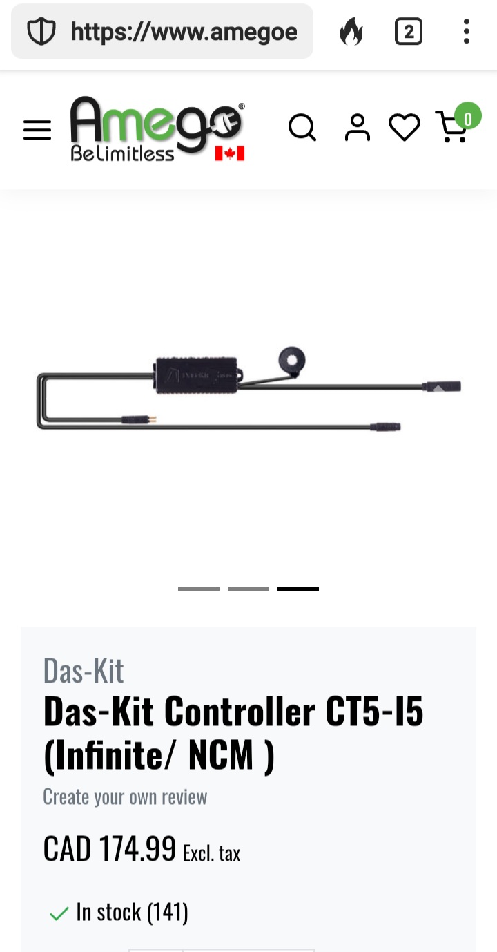

A new controller from Amego in Toronto is $175.
(The one for my ebike is $20 more and includes a light output)
