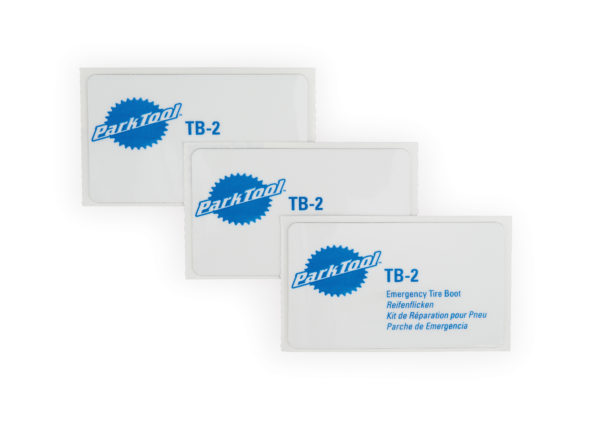

And, now, I will find something to toss in the bike bag to create a boot/patch, probably an old piece of inner tube. (and I just had to check that 'boot' was the correct term for patching a gashed tire)
Here’s what I carry in my tool kit:
