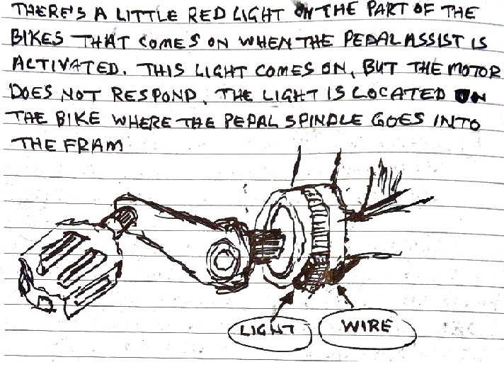

My Pedego Element motor stopped responding. The LED shows no error, all connections have checked and cleaned, including the battery posts, the indicator light by the crank lights when the assist is activated, but the motor does nothing.

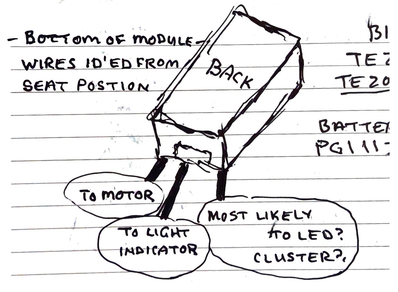

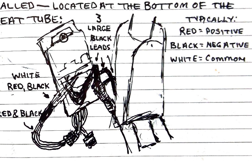

I took the controller out just to see if anything was awry, but there's just the module and leads, so aside from identifying the indicator light, motor lead, and possibly the lead to the cluster, nothing could be done.

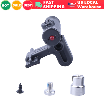

Try disconnecting the brake cutout levers. Just the electrical not the brakes themselves.
You know, PedalUma, I saw another lead coming out of the controller box that went parallel to the motor lead, is that what you mean?
If I disconnect the brake cut out levers, I'm wondering what's that going to do. But first: where are they, and is this a fix or a diagnostic process?
🎵 Tell me more, tell me more. 🎵
Okay, when you pull a brake lever it cuts the motor. Sometimes that fails and the motor is always cut. This is diagnostic. It could be the left or the right. Then order a replacement set from someplace such as eBay that uses the same connector. You will still be able to ride the bike but just don't throttle and brake at the same time. Kids in the snow would do that by using the front brake and giving it gas.

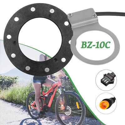

Okay. So we eliminated an easy one. Sometimes displays fail. It is pretty common. First check to see if the (PAS) pedal assist pickup is within the thickness of a nickel (2mm) from the magnet (Hall) wheel of magnets at the bottom bracket. Next, see if the speed sensor pickup is aligned with the wheel magnet and also about 2mm away. Adjust these if needed. If still nothing, try using your wife's display on your bike. These are the easy things to check first.

Is the PAS located where the indicator light is? The light is near the bottom bracket? Where are the magnets? Are they, like, on the bearing area? And the speed sensor pickup- where is that?

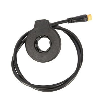

It looks somewhat like this. Look where the pedal arms, crank, attaches to the bottom bracket shaft.
This kind is sealed so you cannot adjust it.
