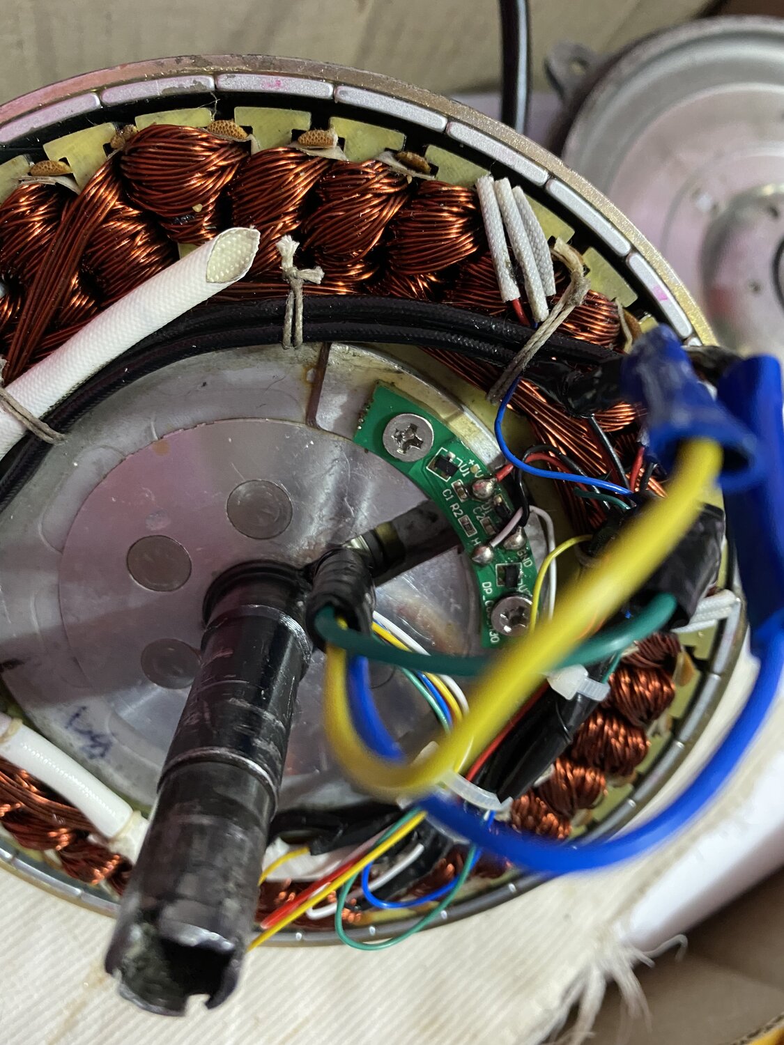

I duoubt that anyone on this site has attempted a motor cable replacement specifically for a BH ebike, but if so does anybody know how to dissasamble the motor ? I'm halfway through almost , i may hav to wait until Monday when i can reach my contact in Spain @ BH headquarters for an instructional vid.
The new Higo 9 pin cable i had obtained it already.

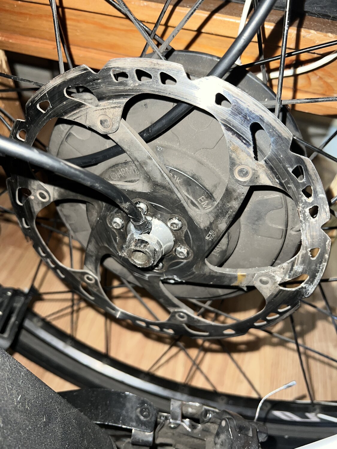

Thankfully it happened after 18.000miles, it is an issue , i think for all ebikes that don't have Torque Arm . If the wheel is not properly seated in the axle then once you ride the ebike , the cable will pull .
Btw., For anybody that wants to do this , this cable install is pretty straightforward ( as long as you have the instructions on how to take the hub apart) , it doesn't take long is probably an 1, 2hour job so basically you just need a new cable and then to have a few tools: scissors tape , string cord to pull cable, solder gun, etc and some WD-40 or electrician lubricant.
The cable is 10-25$.

Problem fixed !!
Parts cost: 10.99$(new motor cable(
Savings : 500$(a new reliable 1kw motor)
