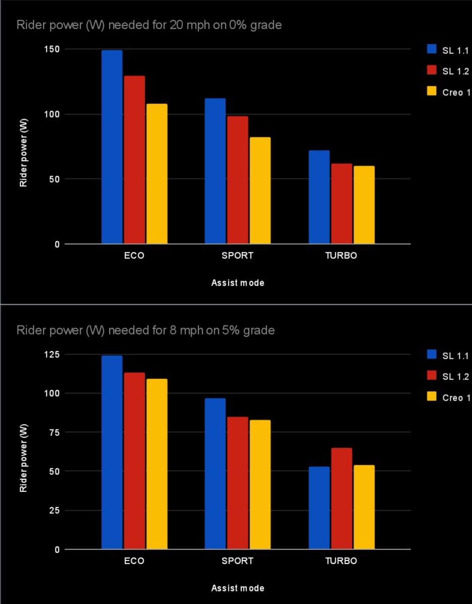

Graphical results
These bar graphs the show the rider power Pr needed to hold scenario speed, with the dash above and the climb below. Blue bars are the stock SL 1 (SSL); red, the modified SL 1 (MSL); and yellow, the Creo 2.
NB: When visually comparing the dash and climb graphs, note that their vertical Pr axes differ slightly in scale.

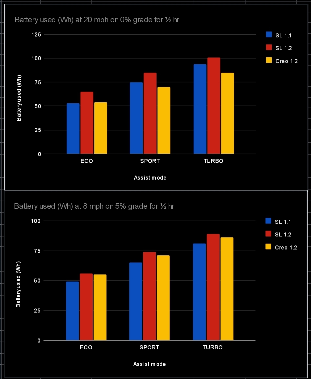

These bar graphs the show the battery consumption Cu in Wh in all 18 cases — again with the dash above and the climb below.
NB: When visually comparing the dash and climb graphs, note that their vertical Cu axes also differ slightly in scale.
Bottom line
Relative to the SSL, the MSL would save you a little effort in all but the TURBO climb. But it would burn more battery in all cases.

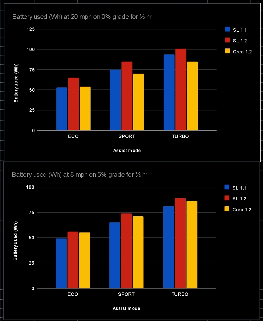

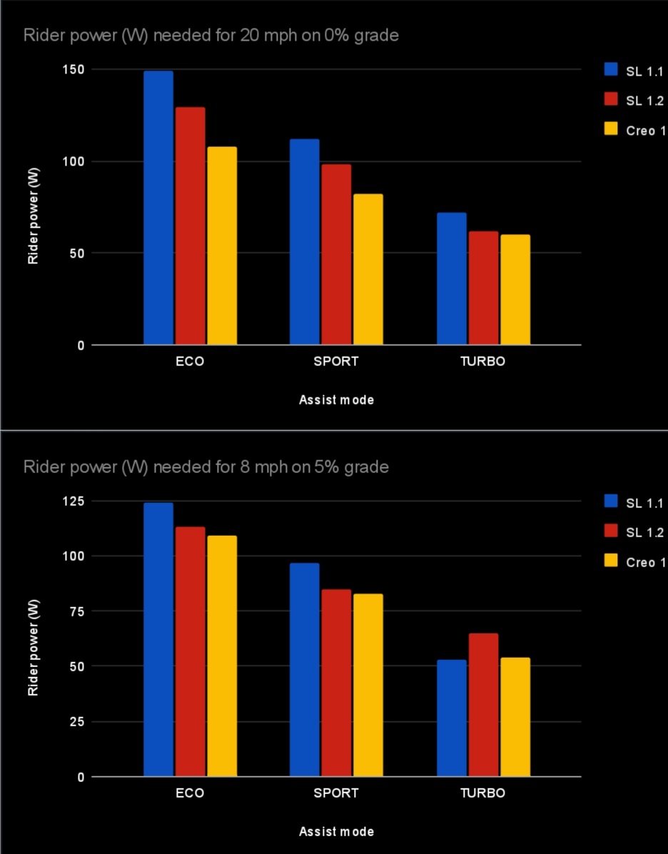

When I do that with the Creo 2 Carbon Comp — the version graphed above — the yellow Creo bars become just a tiny bit shorter than the red bars of the modified SL in all 18 cases graphed. This reflects a gross weight advantage of only 2% for the carbon Creo with an 87.3 kg rider (me) onboard.
That tiny rider power and battery consumption advantage for the carbon Creo 2 would probably be lost with the alloy version, so just read the red bars to evaluate the suitability of a flat-bar alloy Creo 2 for your riding goals.
It bears repeating that the graphs above assume a full tuck on the drop-bar Creo 2. The more you sit up from there, the more the Creo's rider power and battery consumption advantages go away — at least in the 2 modeled scenarios.
