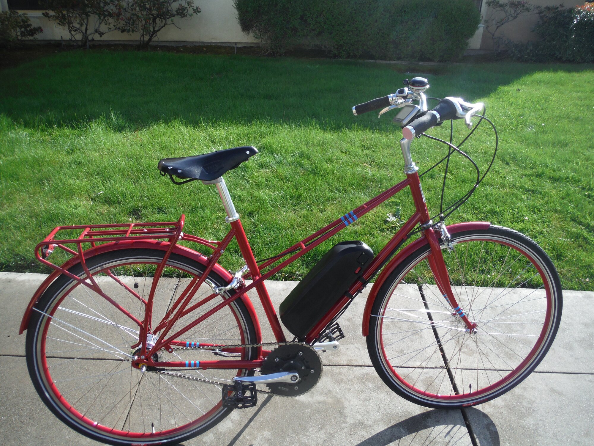

that would be easy to get on but can you imagine riding that 50 miles or climbing 20% grades on?
Not 20% grades, but a front hub conversion like this should be quite comfortable on milder hills, I’d talk to Grin Tech in Vancouver who are great at specialist conversions.

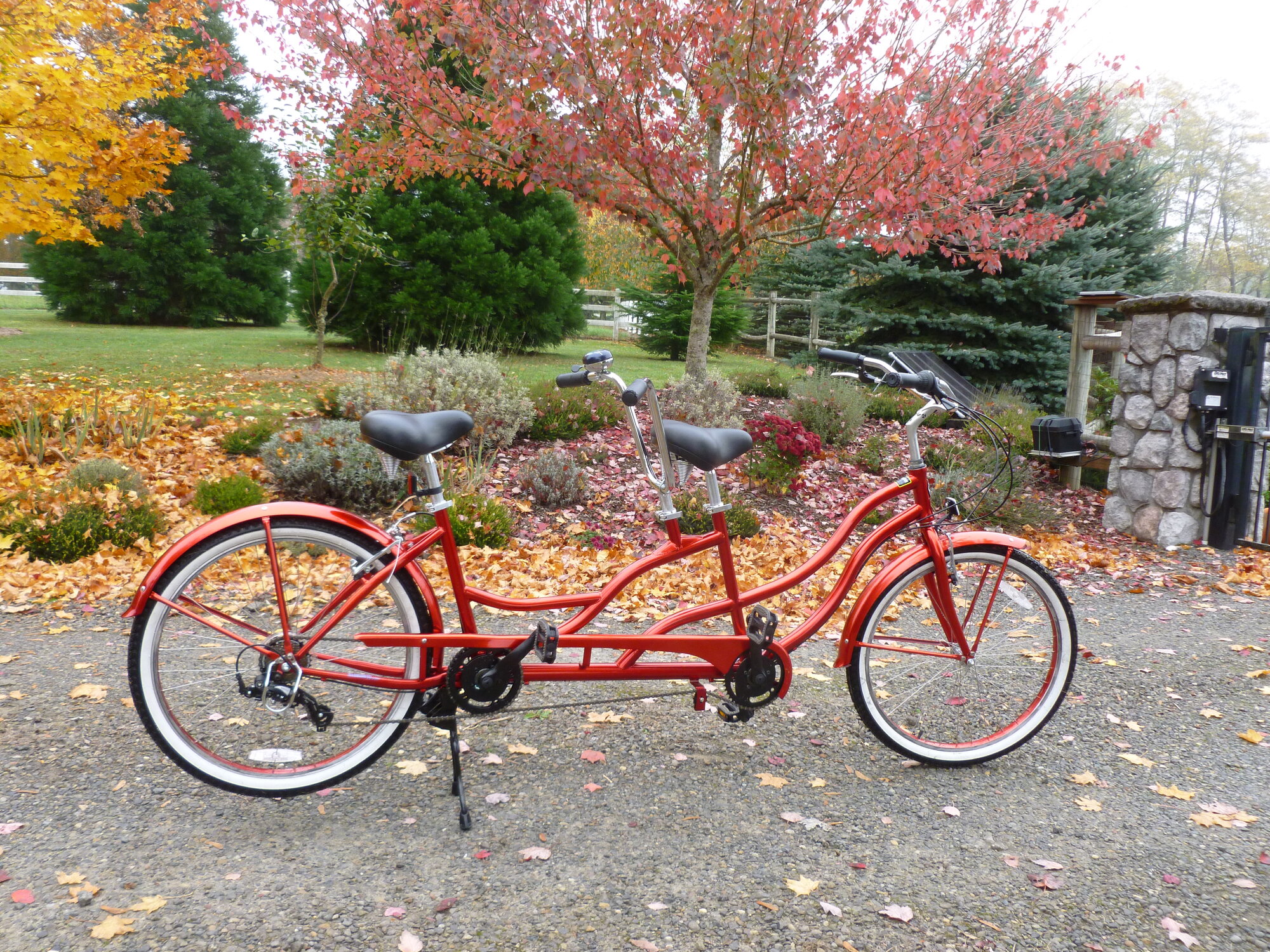

I would not want a front hub on a tandem the front slips too easily as it is. we have to be so careful on hard packed trails as is. we have done 3000 feet in 40 mile rides with lots of 15% or more grades.

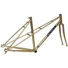

I would say have your BF look into welding on twin mixtie top tube bars. These could on your bike extend from the seat stays to the steer tube, with a couple of cross members. The front of the rack could also have twin bars that connect to the seat tube at the seat stays. Most racks do.

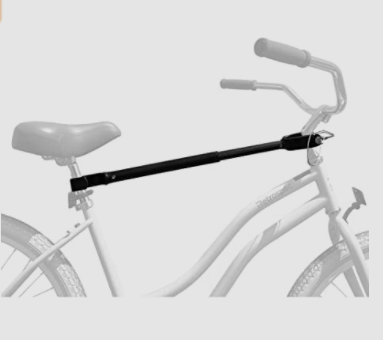

Does anyone have suggestions for minimizing frame flex? My fiancé is in the machinery/engineering sphere and has suggested making an attachable padded 'top tube' that could be screwed on, but that is all I've got. It would be cool to hear from someone who has done something similar or dealt with similar issues.
Retrospec Bike Rack Cross-Bar Top Tube Adjustable Adapter​

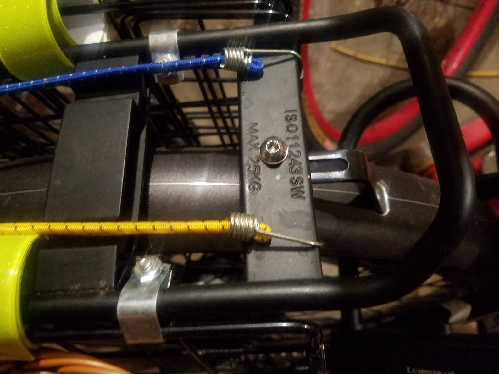

I have an Ariel Rider C class, which is a step through. It has a built in (or on?) rear rack, to which I've added a top trunk and folding baskets on each side. The top trunk never carries much weight. I regularly load the folding baskets up with groceries which can be pretty heavy--beer, milk, etc. Often, the extra weight is all on one side, and I never notice any problem whatsoever from that. I have never noticed any sway or wobble that seemed to result from the step through configuration. In fact, there's not much movement at all in the frame. The battery is on the front of the seat tube, making the frame resemble one of Rad's bikes (don't know the model name). That puts the weight low and centered. Also has a mid motor. I do carry a bag on the handlebars, but it doesn't carry much weight. I have never had the front wheel threaten to lift, even though this is a very short wheelbase bike with an upright riding position (which I really like, as my wrists and hands used to get painfully numb after some distance).
My wife and I both pedal step-thrus (only mine is an ebike). To transport these on a platform rack, we needed to equip both bikes with that type of removable top tube. Worked great for our purposes, but I can't see it doing anything for frame stiffness, as it isn't attached solidly at either end.
My ebike is an Ariel Rider C class. I have a small trunk on the rear, and folding wire baskets as panniers. I use it often for grocery shopping, and have never noticed frame flex. I may not be loading cargo as heavy as you are carrying, though.

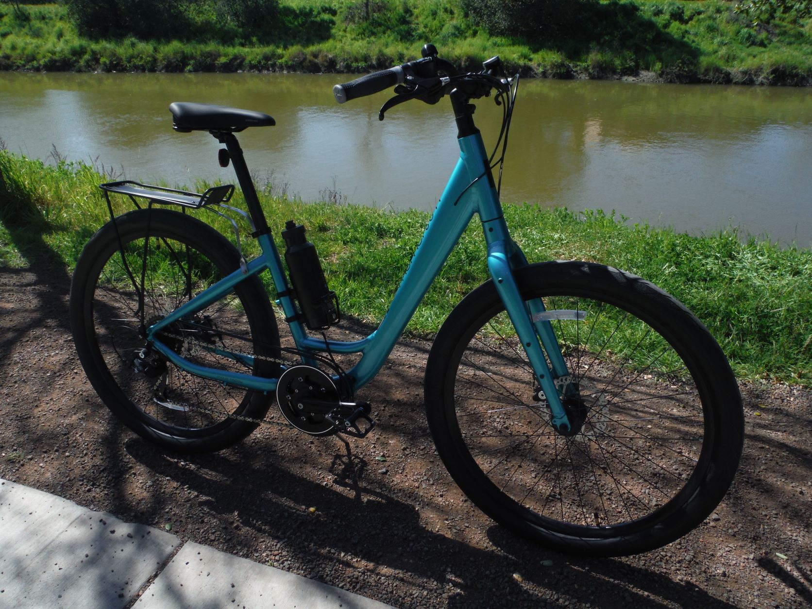

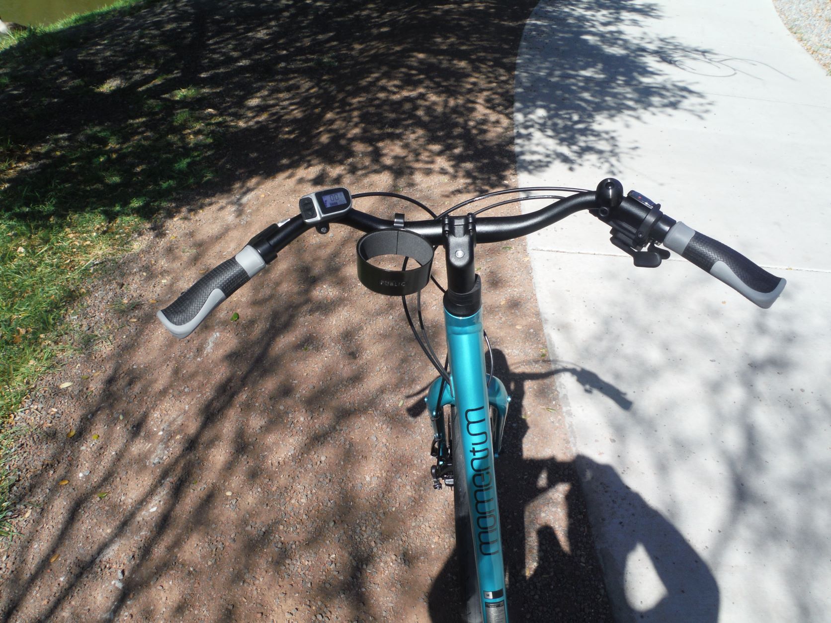

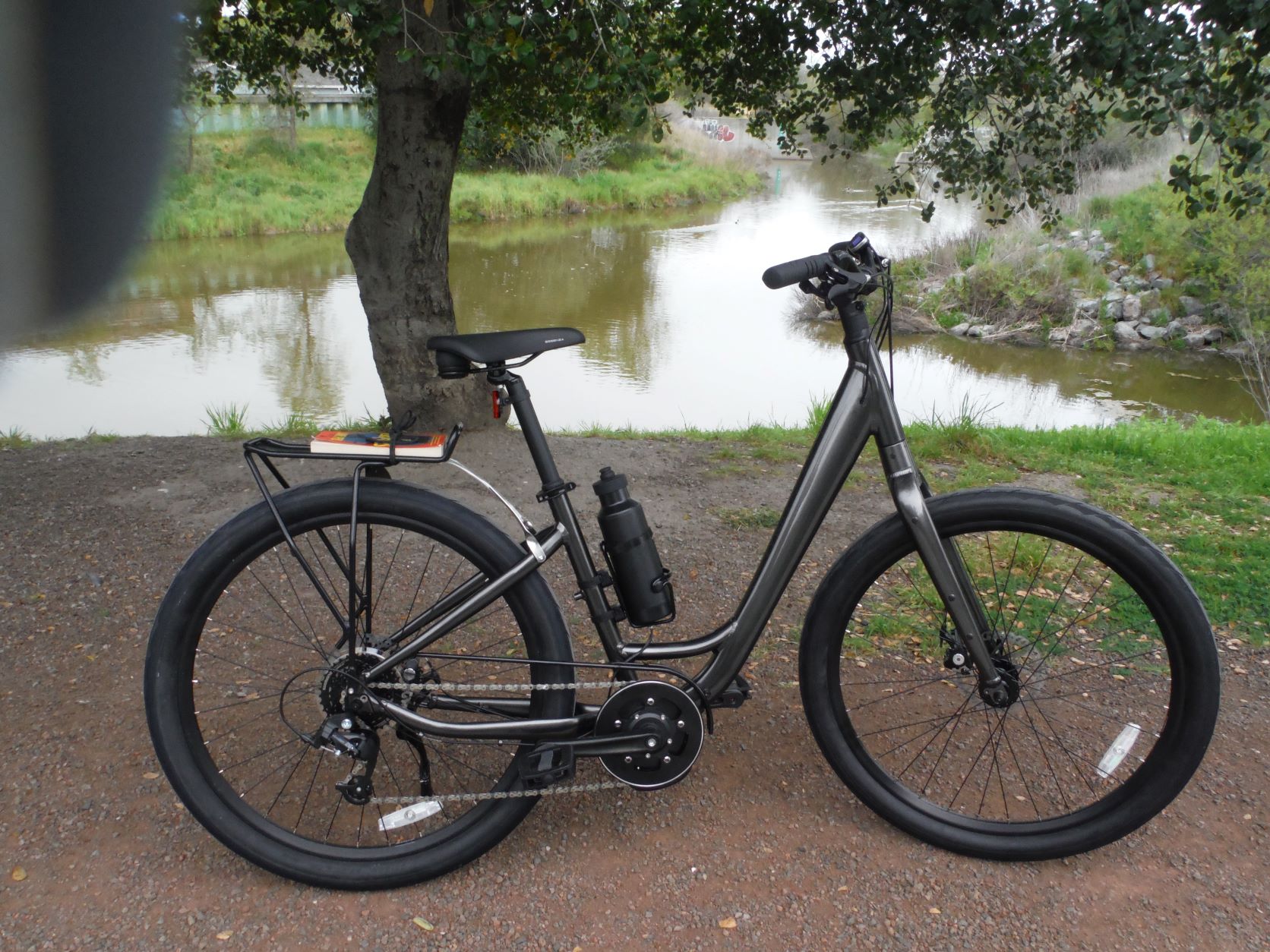

A frame adaptor is only for hanging a step through on a rack. They have nothing to do with the structural rigidity of a frame. I have only experienced a noodle-like twisting flex in a steel Mixite. If your frame has flex like this, use a different frame. This bike is nice. It feels like a Como. Note the lack of ugly wires. It is a mid-drive. I started with a Giant Momentum Vida frame. The ride is smooth. The red one had that wet noodle twisting flex. Part of the problem was the older style, heavy battery.
