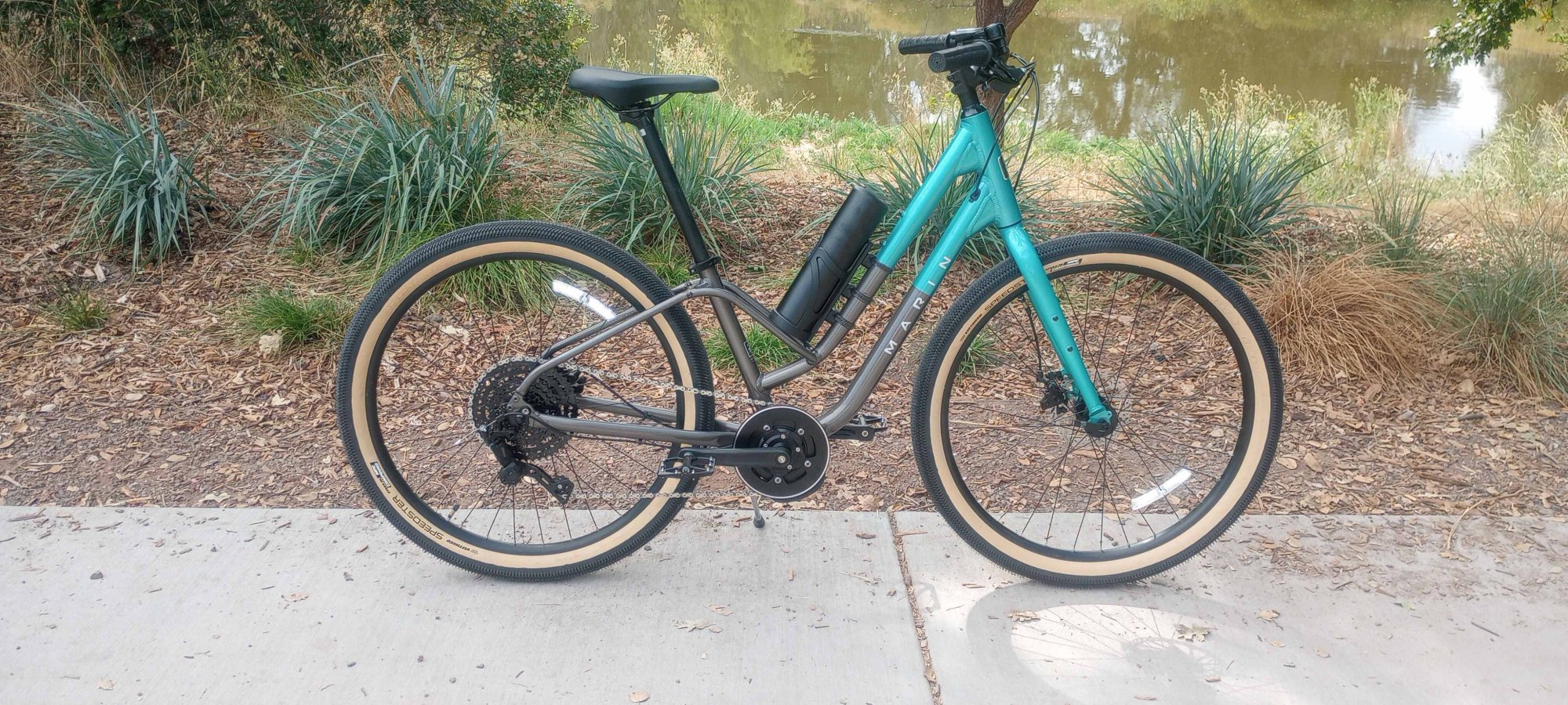

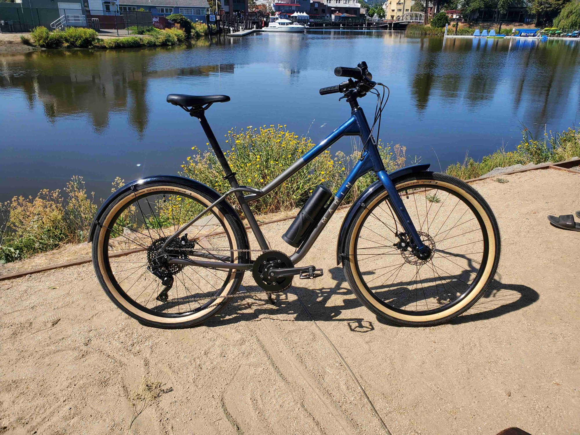

I have converted several Marin Stinson 2 bikes with torque sensor mid-drives. The bike is a modern take on the classic beach cruiser. It is foot forward, comfortable, with a long wheelbase, and has a wide range of gears. Stinson is a popular beach north of the Golden Gate. This is a cruiser meant to also take hills. They are about $750 these days. It has wide tires on 750b wheels and has simple mechanical disc brakes on a modern aluminum frame. Just make sure the bottom of the seatpost is well below the top tube. The minimum insertion line does not account for that. The ride is similar to the Specialized Roll. It is setup to get front and rear racks and fenders.

I broke the frame! I learn best when I screw up. It was at the minimum insertion point mark on the post, but that was above the down tube. It suddenly got all spongy, starting to wobble, then cracked. Marin Bicycles has a huge warehouse in my town, Petaluma. It is filled with frames of all sizes and models back to 1986. They offer a full lifetime warranty on all their frames. I simply took off the motor system and reinstalled the original parts. The dealer photographed it and I got a new frame the next week. Then it was a matter of moving the components, adding a longer, thicker post, and reinstalling the through frame conversion. I rode it for another year then put it back to the original parts and sold it to a barista, Marco, who loves it. The motor system went to another bike. Here is a step-thru version. Yes, the seatpost is way too high at the minimum insertion mark. I have long legs.
The owner was sold a $16500 bike that could not take her hill. She was promised it would. She had to walk it 2 miles uphill. I got her a full refund and she purchased this bike for $650 at the time, across the street. I converted it and it climbs anything, just fine. The bar is more backswept than the original. See any ugly wires or connectors? Not using any zip ties on a conversion is like skinny dipping. To see the thread, search for Custom in the title, and by user PedalUma, to see a full build process.

my kind of bike,steel frame?

have to say I really like it,my thing is long wheelbase though.cause when I am chugging up the steep hill to home base the front end gets very light.

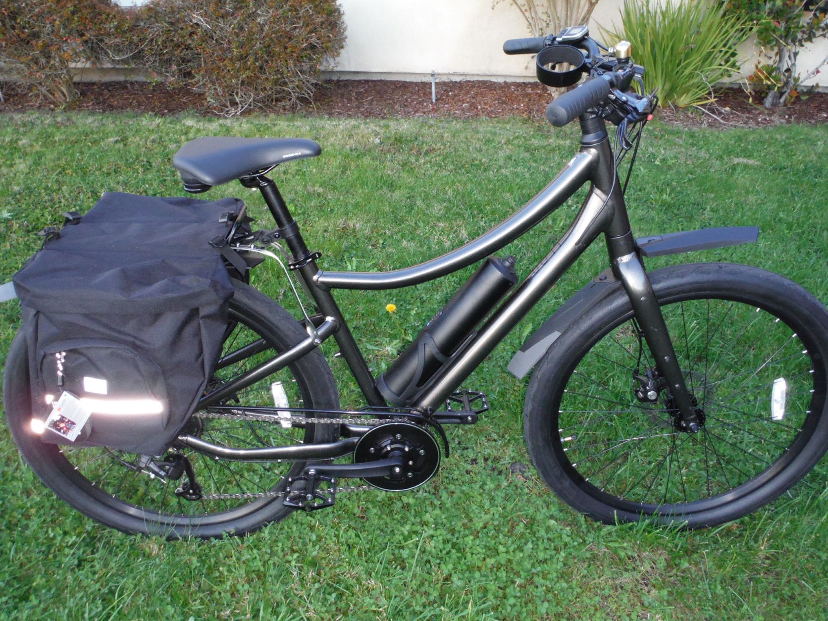

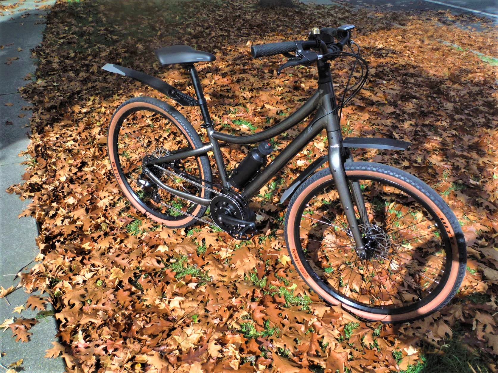

Those are lightweight aluminum bikes from Marin. I also did a bunch of similar ones from Giant that are no longer made but demo bikes are still with retailers at steep discounts. Those are call Momentum Vida. They came in low-step and mid-step. Some are still out there for about $550.

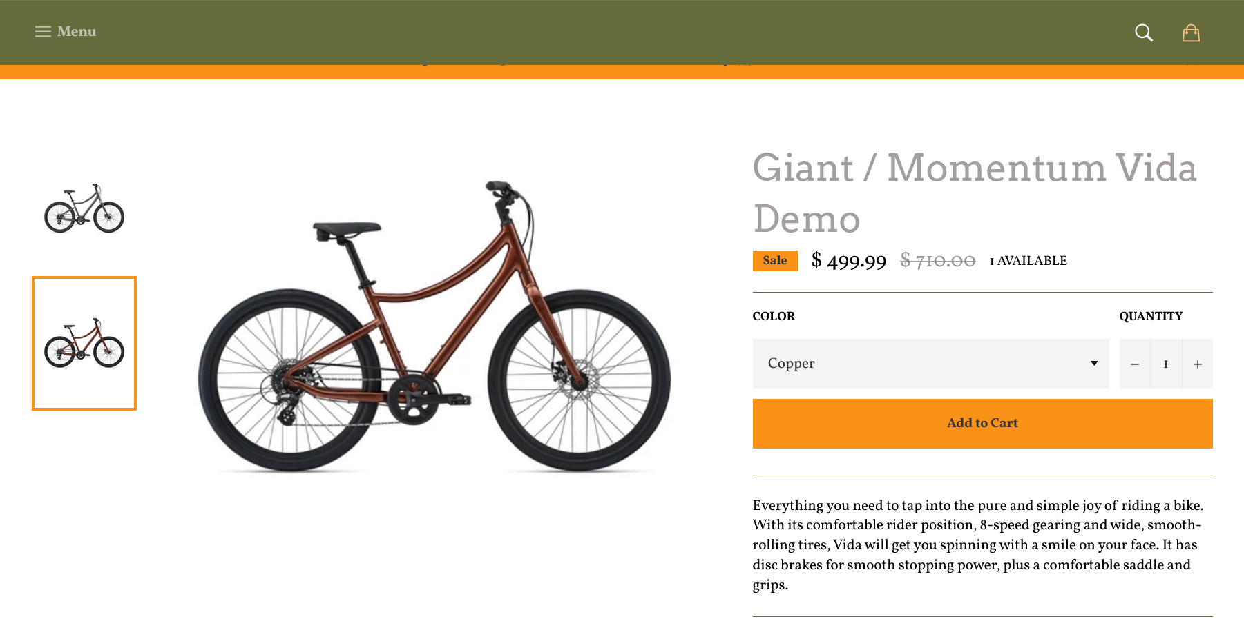

The shape of the frame of the bike of the 3rd pic caught my attention, its not common at all, looks really nice
As I mentioned, they are no longer made but new showroom "demo" bikes are available. If a bike on the showroom is tagged as a "demo" bike than it can be sold below MSRP. I do not know the size or the terms, such as shipping, on this particular bike.
