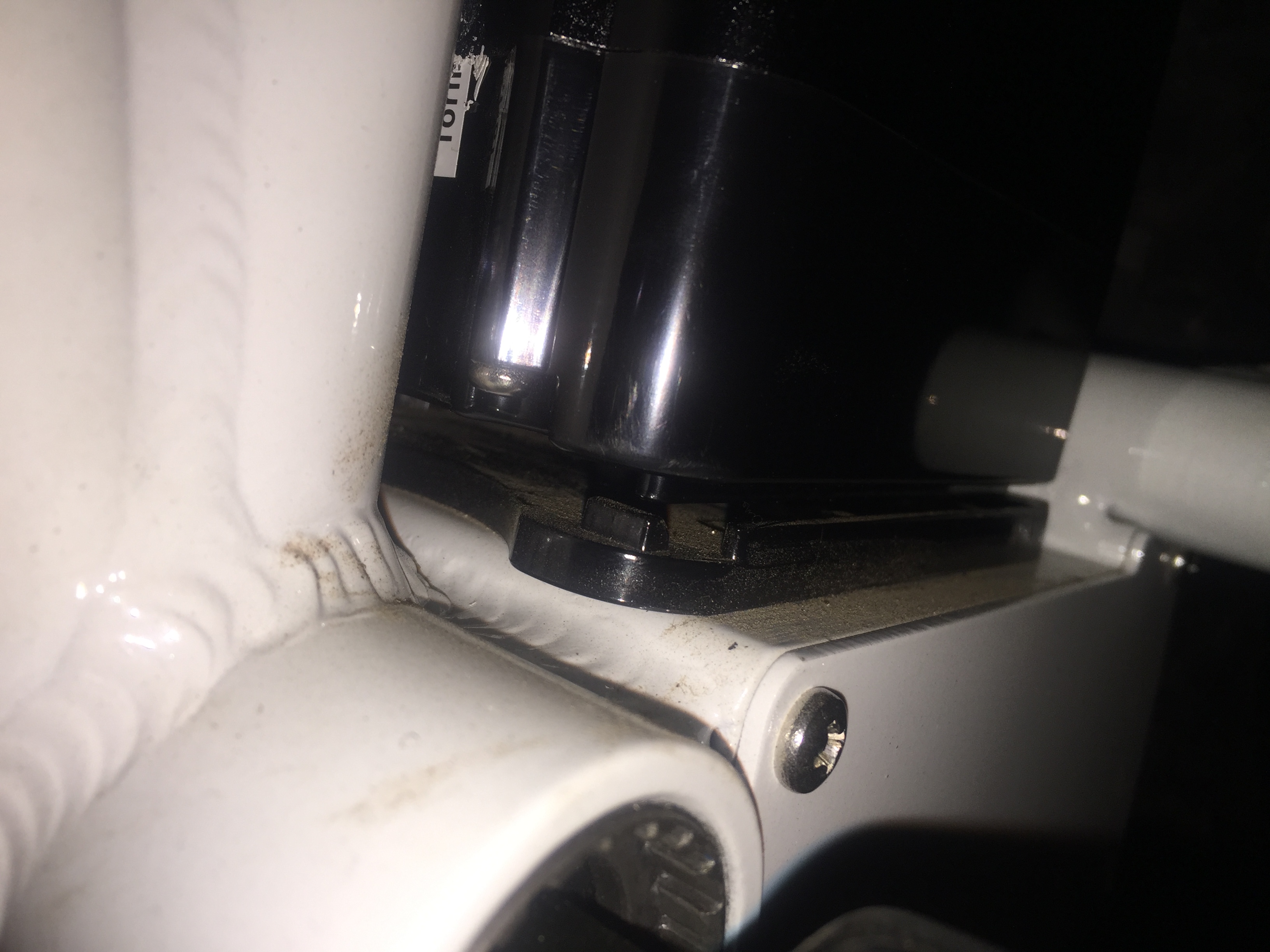

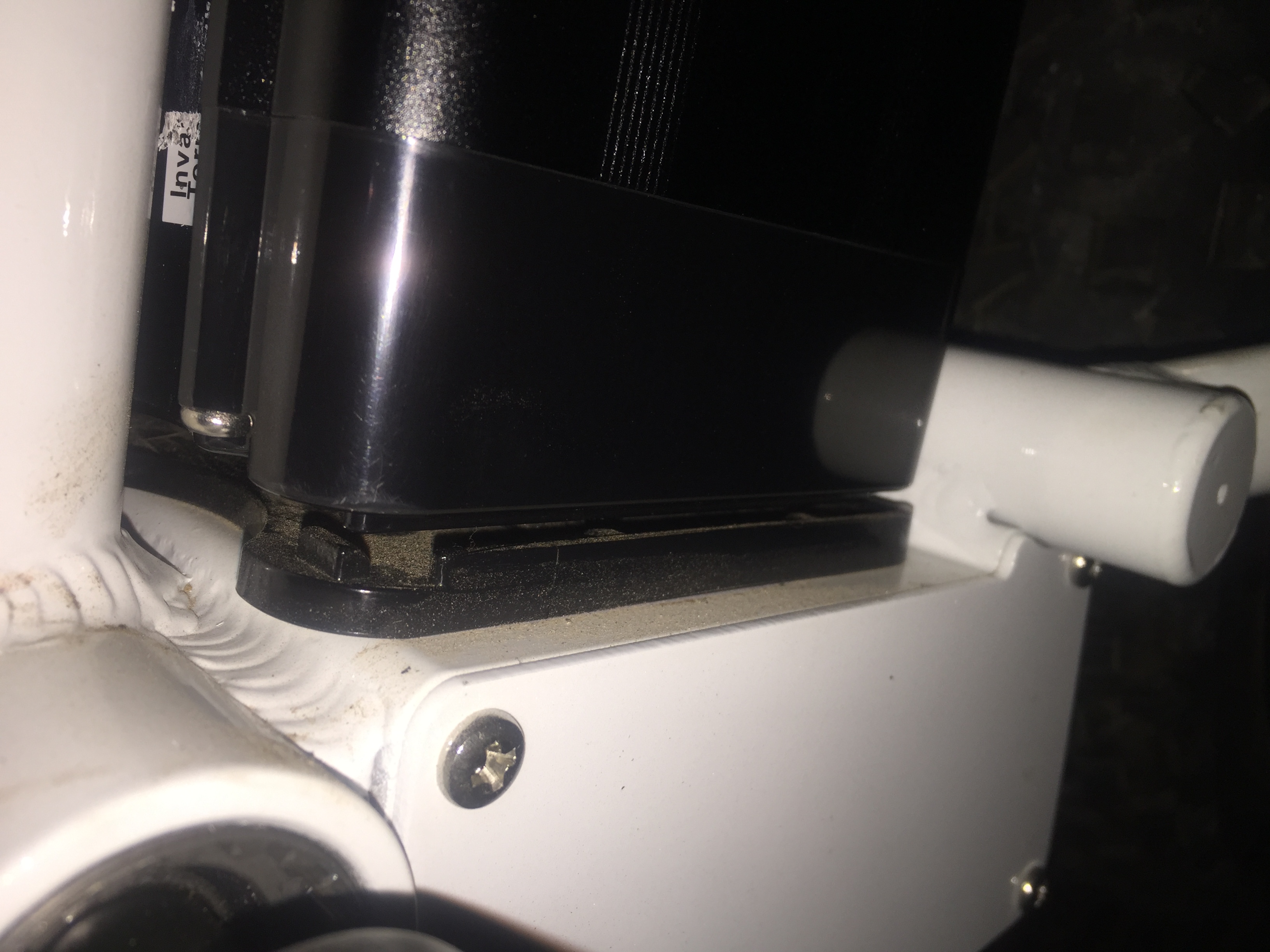

my mini battery has not seemed to sit right in the holder since i got it
it sits about 1/2 in or a little more above the plastic thing on the bottom, looks like it should slide down into that but it doesnt
we also had 3 complete power cut outs on a dirt road that was not really that bumpy or bad, like the battery is losing connection
on mine the battery slides in and sits above the plastic piece and then i have to lift it a little to lock it, so it is even further out of the bottom slot
can anyone else look at theirs and let me know how it looks
will try to post a pic of mine here

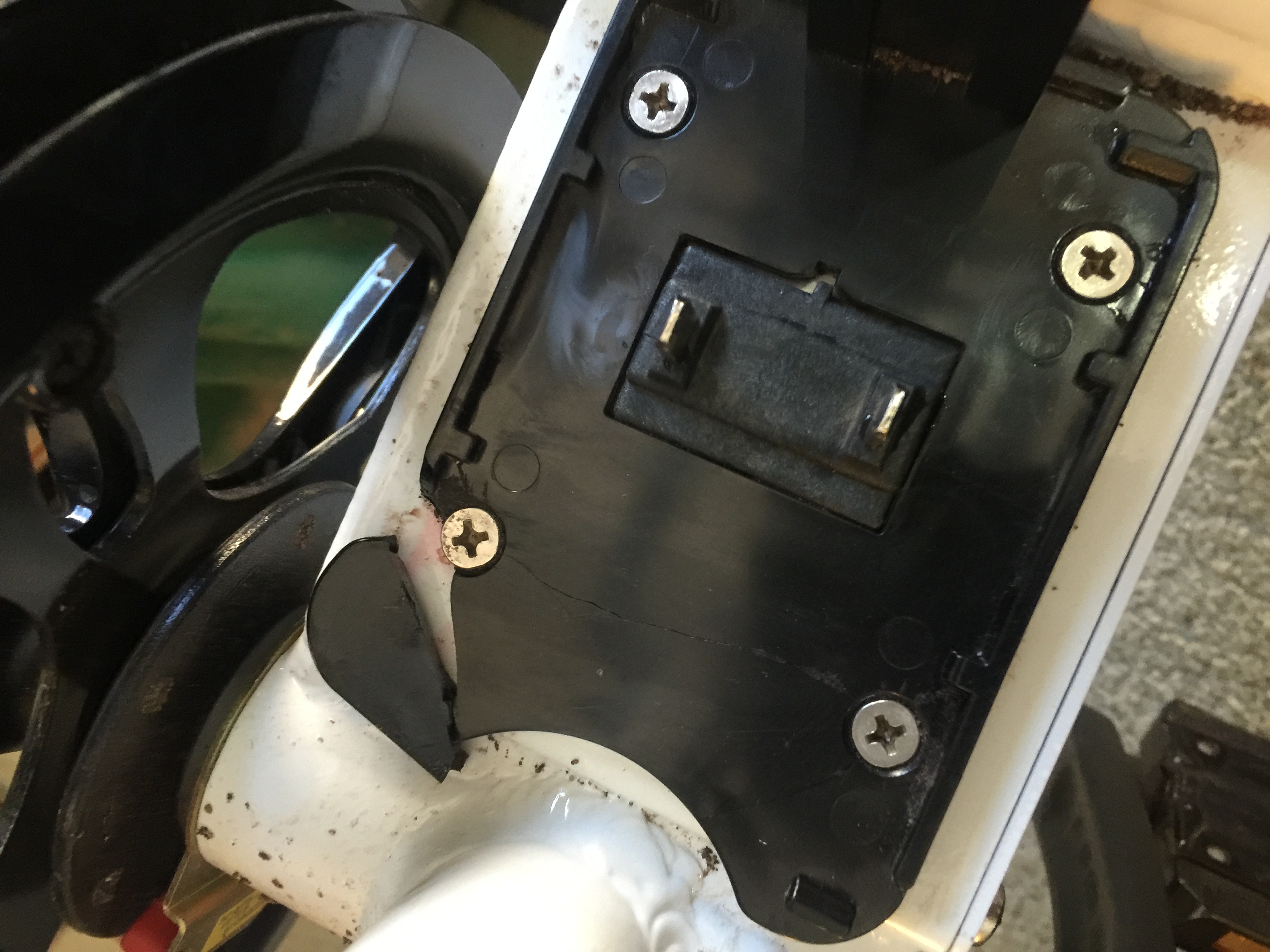

also the black plastic piece on the bottom cracked the first 10 minutes we rode it
anyone else having these issues?

View attachment 9488 View attachment 9491 View attachment 9494
@vincent any chance the female poles on the battery are shifted to one side? When I blow up the picture of the male end it looks like one side on one of the poles is worn. The battery probably has two sides like a close pin...the pole should slide between the sides on the battery. Just a thought??
You may also look for impact points on both the bike and the battery. There may be a worn spot on the plastic which would indicate a point of interference??
hey grench
just looked it over and it all looks right
cannot really tell where the problem is
can others tell me if their mini batteries fit flush on the bottom or have a gap like mine does?
in my mind the gap is the problem... that it is not seated properly but looking at the way it is made the metal piece the battery slides down etc all seems to be correct
nothing looks bent or messed up, the battery just sits high
the thing is in order to lock it at the top i have to lift it even higher which seems weird

interesting your battery sits WAY closer to the bottom than mine
mine was cracked the first 10 minutes or maybe it even came that way
i sent pics of the battery in the holder and out showing the cracking to rad power and no response on that yet
