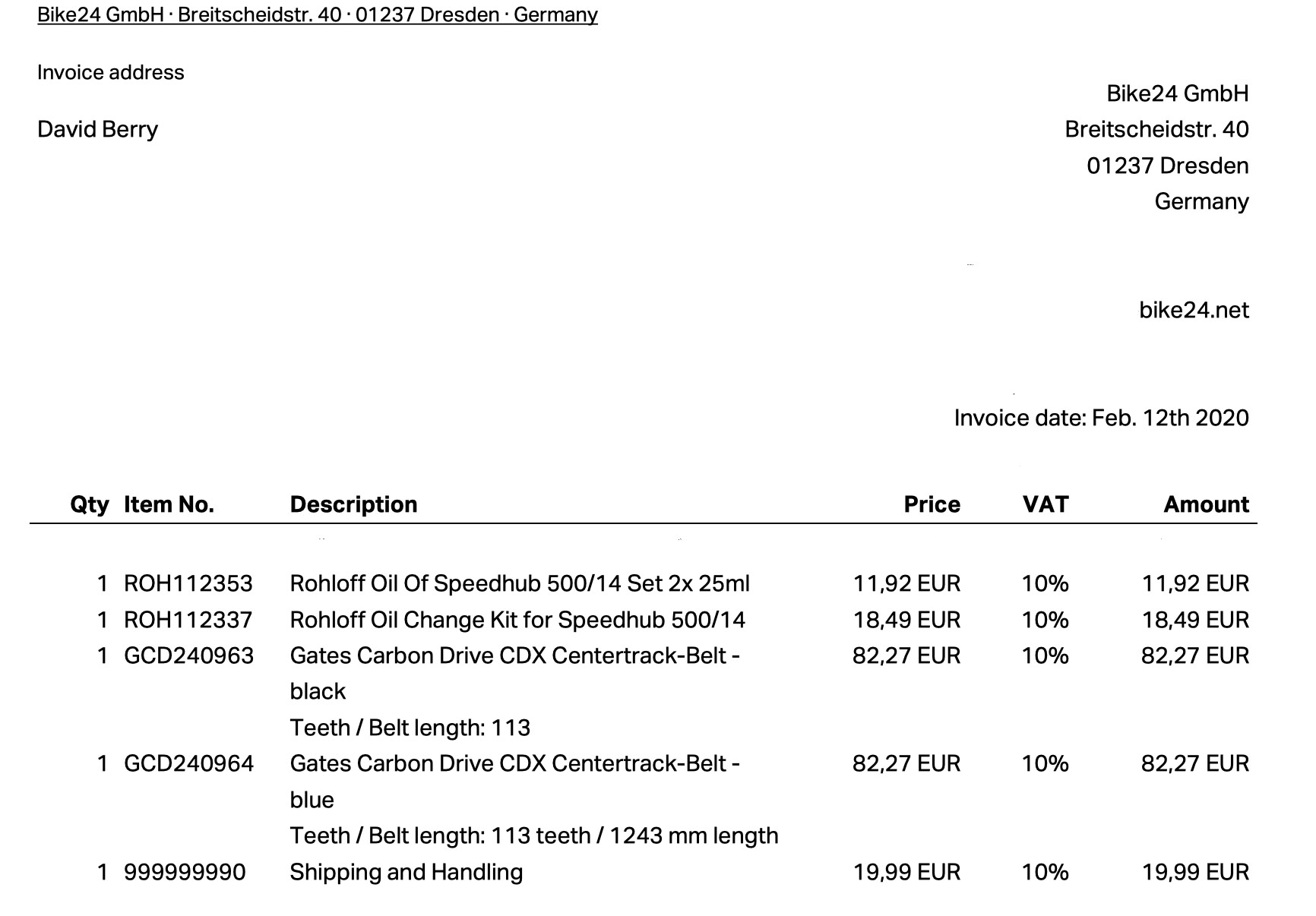

Timothy, I purchased two Gates belts from bike24.net. That was around two and a half years ago after the belt on my 2019 Homage failed at 15,000 km. Substitute your tax for the 10% Australian GST (shown as VAT) that I paid.
I suggest that you count the number of teeth on your present belt: use nail polish, paint pen or thread as a marker.
David
