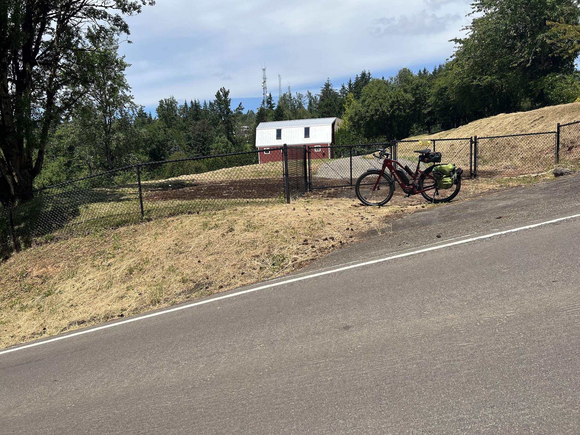

Ya the alant 8 I put out 540 watts. I maxed out what the bike did but you dont know what that is exactly since the 250 watts is nominal not peak. but man I worked my butt off doing that. I did that hill on my bulls bike with the gen 2 bosch motor too. but I could not get my cadence up to 60 for the most power. I can do 18% for a couple blocks now in eco I used to max out the bosch motor power doing that hill then the software upgrade now I have some left in the tank. I doubt you can overheat a bosch motor. only if you max it out maybe for a long time? but that took me able to put out 540 watts myself and that takes a really steep hill unless yo can go faster. You would need to be a really strong rider too maintain 500 or so watts long enough to test it.
I should explain how I tested the motor. first find a really steep hill around 18% worked. before I updated my motor going up the steep hill and putting out 450 watts (I have a nyon) and peddling from 70 to 80 rpms. I changed assist levels and could nto find any difference between them. when I got my motor updated. so far I only maxed out on there 22% hill I do a short 18% hill every day and I will see if I can get 540 watts out and go faster. but I cant always manage 540 watts. I ahve done a few 600 to 700 watt packs when starting out but that only lasts for a very short time. here is my test hill.
