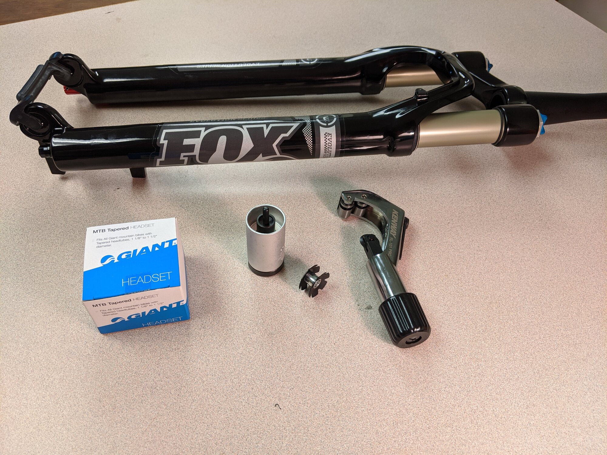

I change the (very lame) factory front suspension fork for a Fox suspension unit and its the single biggest improvement I've made to my 2020 Explore E+
Fox Flow 32 29".​

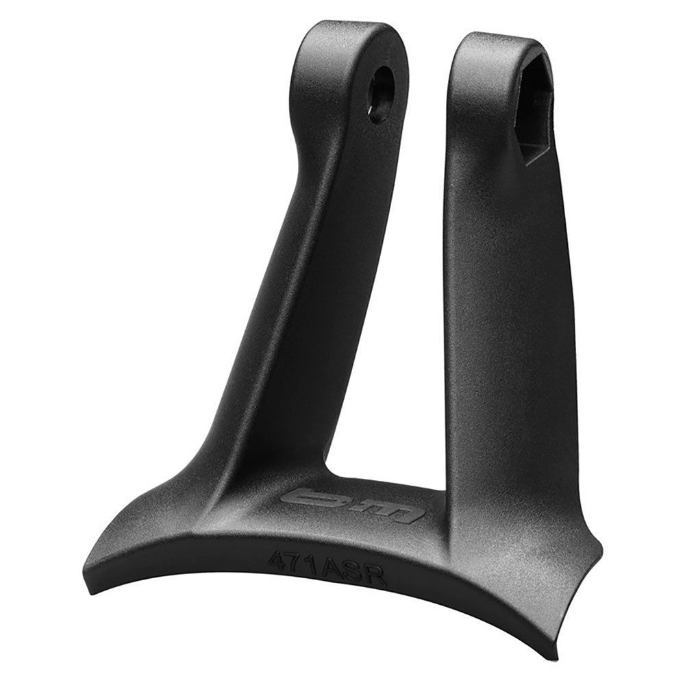

yes, QR 9x100 as the original fork. fender is also compatible, for the headlight there's a specific support to be bought separately
this one here, you can also mount it as it is on the NEX but this one looks better imho.

Make sure you have have a stem cutter, (2020 Explore had a tapered stem and all new forks need to be custom cut. I feel it was worth the cost but it wasn't cheap. I did everything myself and you can expect a budget of $300 - $400 USD
