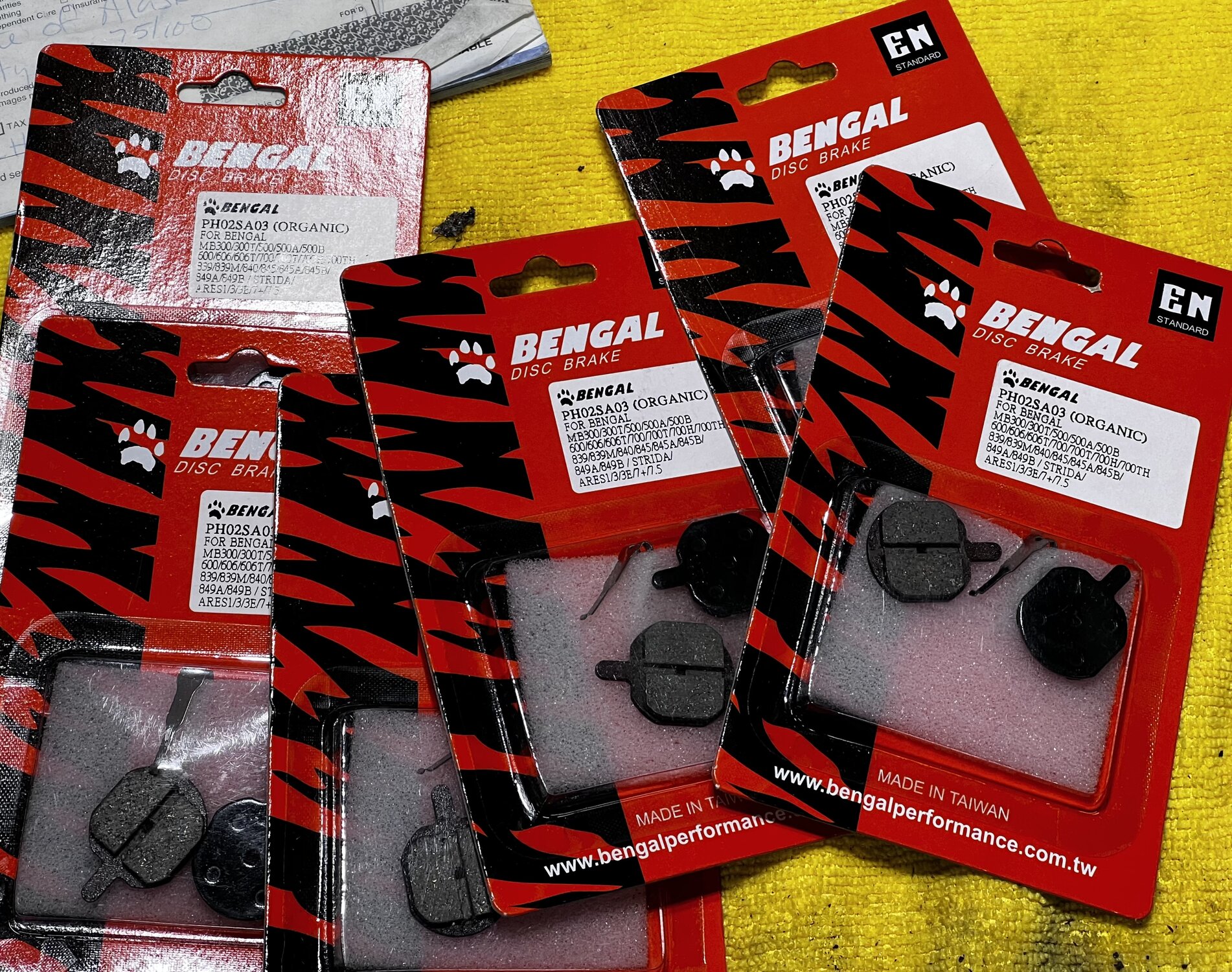

Found the right pads For Aventon Aventure
Bengal ARES 3. #PH02SA03
Avenue Cyclery 415-387-3155
He just got 110 sets in. I bought 8 sets myself. Quick service. Been back ordered 5 months. Get some extra as they are hard to get
