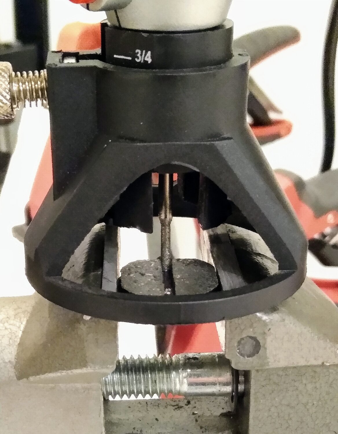

2. I decided to use a rotary tool with its simple router attachment and a flat-tipped diamond deburring bit matched in size to the width of the groove in the original Bengal pads. You can pick up a set of these bits on Amazon for under $5 (set of diamond grit deburring bits for rotary tool). The photo below shows the rotary tool with the router attachment and the diamond deburring bit. (NOTE: this photo was taken after I had cut the groove in the new pad). I used a portable vice to hold the pad, ensuring the top of it was flush with the tops of the vice's jaws which I would pull the router over to cut the groove. With the rotary tool's router attachment resting level on the tops of the vice's jaws, I set the cutting depth of the bit so it just touched the surface of the backing plate of the new pad. A black, fine point Sharpie was used to mark a line on the new pads for the groove cut. It's very helpful if you can get someone to shine a bright light on the pad as you cut the groove and occasionally blow off the excess, fine dust it will produce. I suggest wearing a mask (which we all probably have plenty of) and some safety glasses. I used a speed setting for the rotary tool of about 50-60% and easily cut a pretty smooth, straight groove all the way through the new pad in about 30-45 seconds.

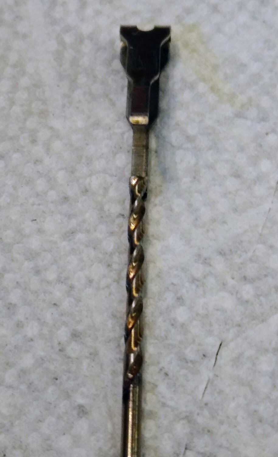

3. Next, I used a 3/32" drill bit (for metal) to drill the hole near the center of the backing plate (about midway through the newly cut groove) which the tip of the spring seats into. This took about 30 seconds. NOTE: You might need/want to debur the edges of the hole you drill for the spring's anchoring tips on the back side of the plate since it will be placed next to the tops of the pistons in the brake caliper.

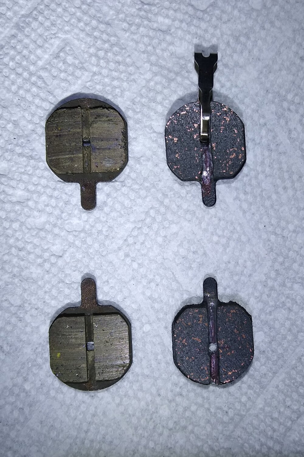

4. The next/final photo shows the end results with the old Bengal pads (with 4626 mi. wear) on the left and the new, modified pads on the right. NOTE: I used the springs from the original Bengal PH02SA03 pads that came installed on my Aventon Level. If your original springs are missing or damaged, I'm not certain of this, but it looks like the springs that come with the very affordable and easily found AVID BB5 pads might suffice.
