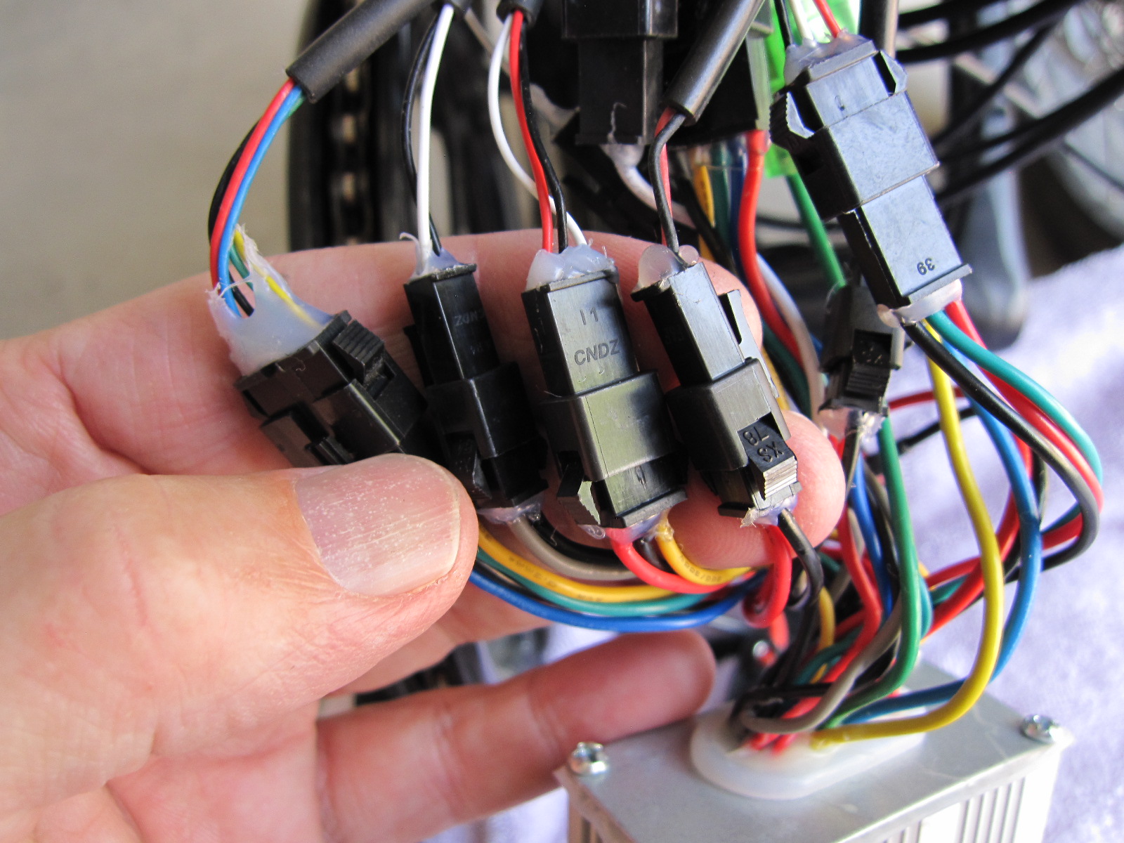

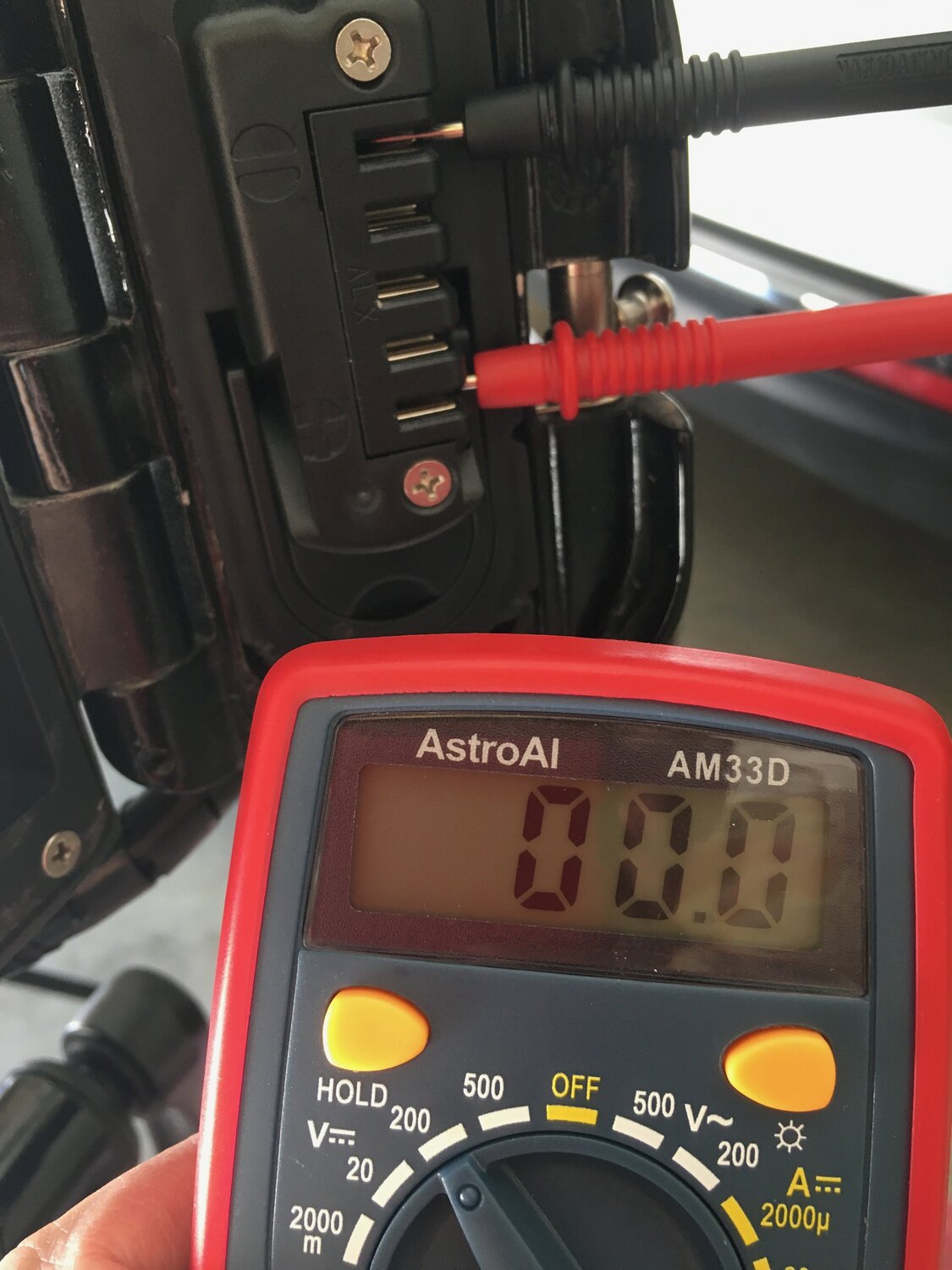

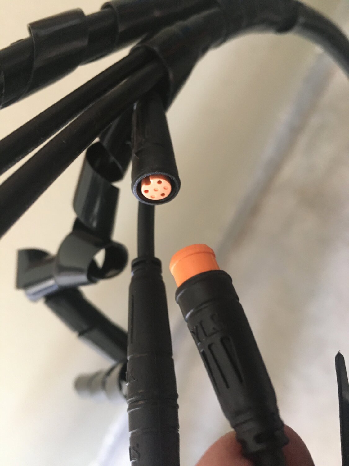

Hello are you riding many hills? My 2020 Lectric XP with 1500 miles has been in the "shop" aka my garage for months starting with PAS issues on hills that turned into the bike battery crashing losing all function. Resetting the key off / on brings it back to life but only until the next hill and the volts again drop to 41 or less (visible on the display). The support folks at Lectric sent a throttle cable and controller but neither the PAS nor battery issues improved. They asked me to buy a multimeter and test the battery just after the battery crashes on a hill. A fully charged battery reads zero volts with the multimeter until I reset with the key off / on again. It's a good lesson for those considering either a bike via dealer or direct from manufacturer. If you buy a lemon direct your bike will end up spending a lot of time in the garage. 👎
Hello are you riding many hills? My 2020 Lectric HP with 1500 miles has been in the "shop" aka my garage for months starting with PAS issues on hills that turned into the bike battery crashing losing all function. Resetting the key off / on brings it back to life but only until the next hill and the volts again drop to 41 or less (visible on the display). The support folks at Lectric sent a throttle cable and controller but neither the PAS nor battery issues improved. They asked me to buy a multimeter and test the battery just after the battery crashes on a hill. A fully charged battery reads zero volts with the multimeter until I reset with the key off / on again. It's a good lesson for those considering either a bike via dealer or direct from manufacturer. If you buy a lemon direct your bike will end up spending a lot of time in the garage. 👎
So you were told to spend your own money on a new multi-meter...to troubleshoot a problem for them? (i.e...we won't send you any more parts unless you do). I think most new Internet eBike buyers are willing to roll the dice and fork over their money (and sometimes waiting months to get it) just to get on the bandwagon. Frankly the local conventional bike dealers are playing right into their hands because (in my area anyway), if you call a local bike shop to help you with an eBike that they didn't sell to you...you will most likely get turned away especially if it has ANYTHING to do with the electronics. I seriously hope the local bike shops get their act together and put eBike sales as a priority even if its a new thing for them. They aren't going away and they are just missing out on the market that the Internet eBike companies have tapped into. Electronic problems are the #1 problem that eBike buyers fear the most...yet are pretty much left on their own once they happen because nobody is going to send an eBike back to get it serviced. I would agree that you if you are thinking about buying a new eBike and have no mechanical or electrical experience or know anybody who does...DON'T buy one on the Internet, even if you have to pay a couple of hundred dollars more or have to travel an hour to buy one. Looking long term, its a wash in terms of money spent (or saved). Peace of mind to some folks is even more important than saving a few bucks upfront. In your case no local bike shop is going to tell you to go out and buy a new multi-meter. Just bring it in.
