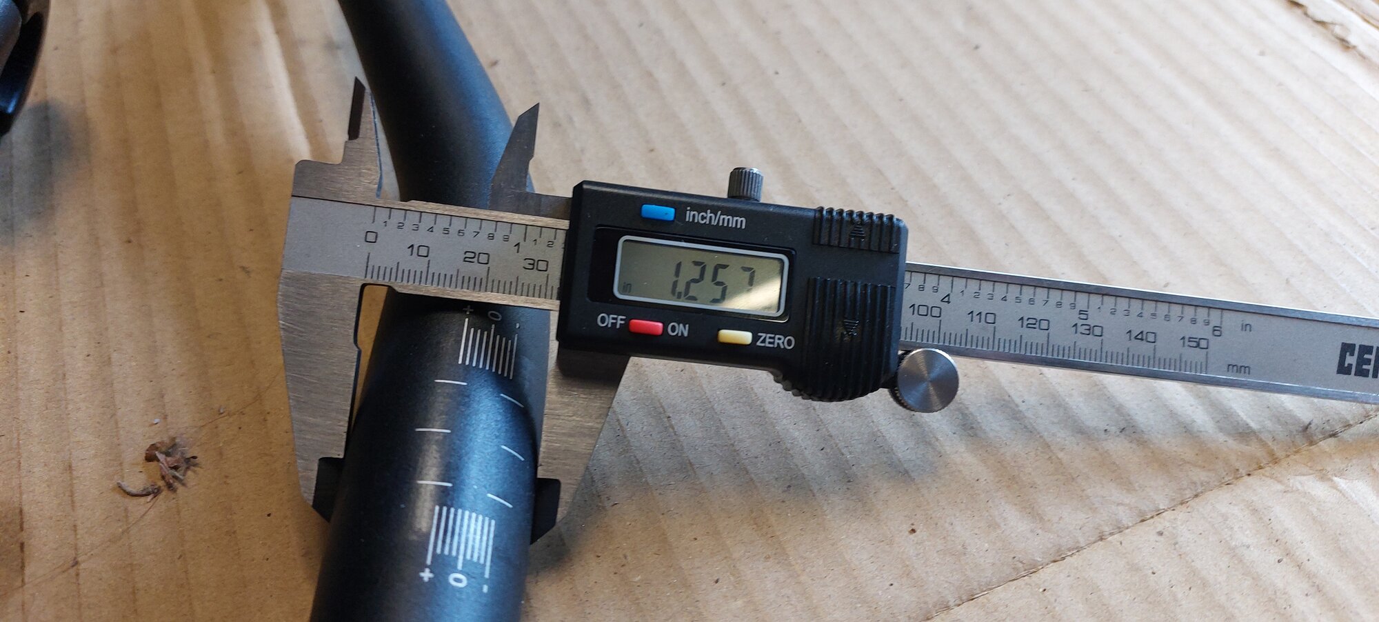

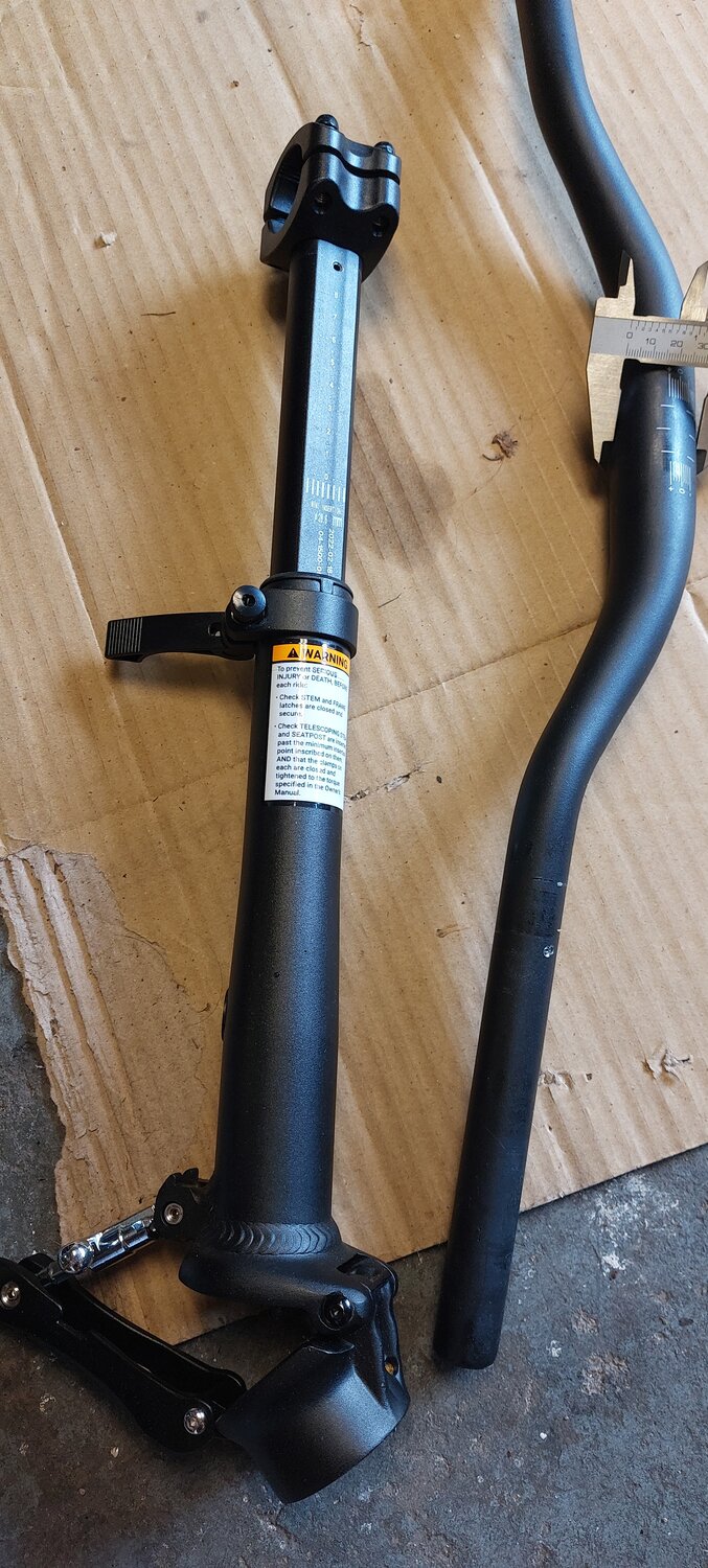

I don’t have the bike yet. But would like to know-Are the handle bars 1-1/8” or 1-1/4” diameter in center where the clamp goes. Also what is the diameter of the stem. Thinking of an adjustable neck, want to get the correct one. Thanks for your replies.

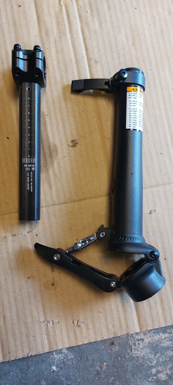

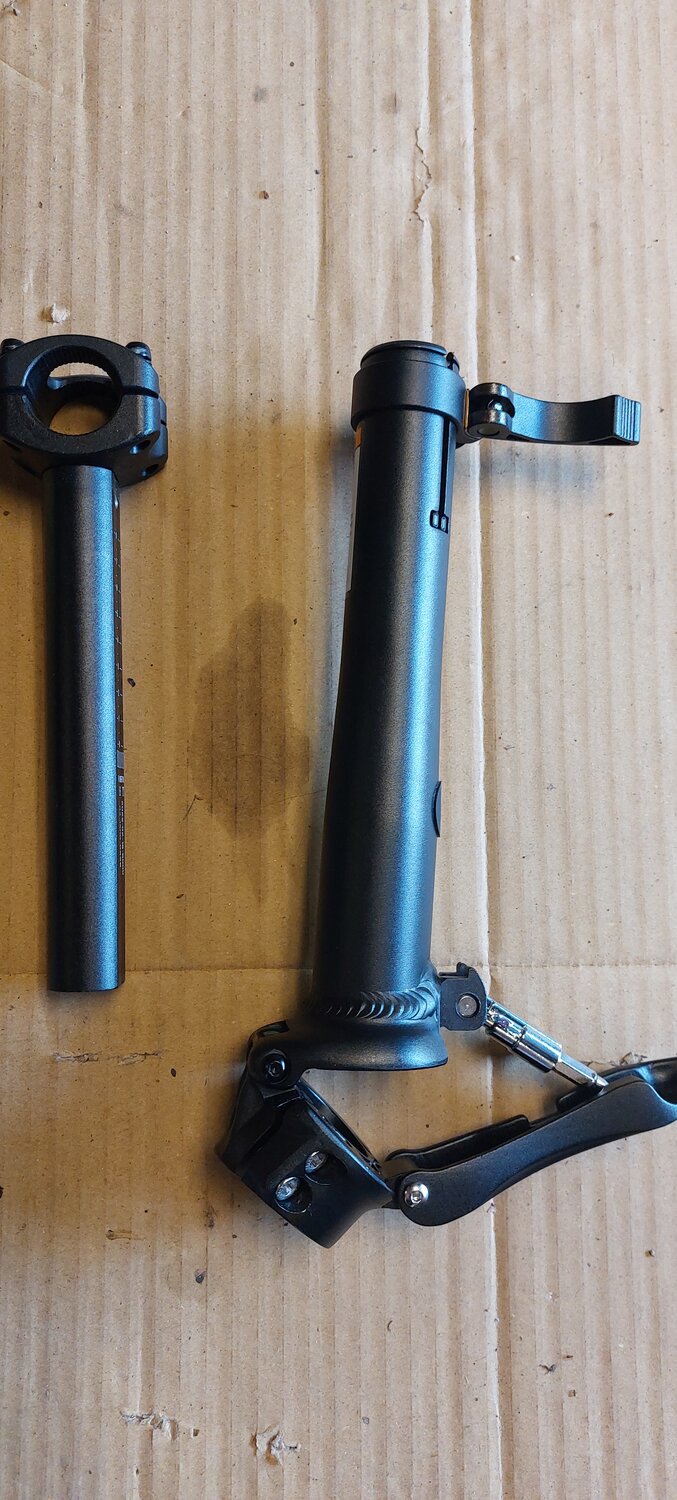

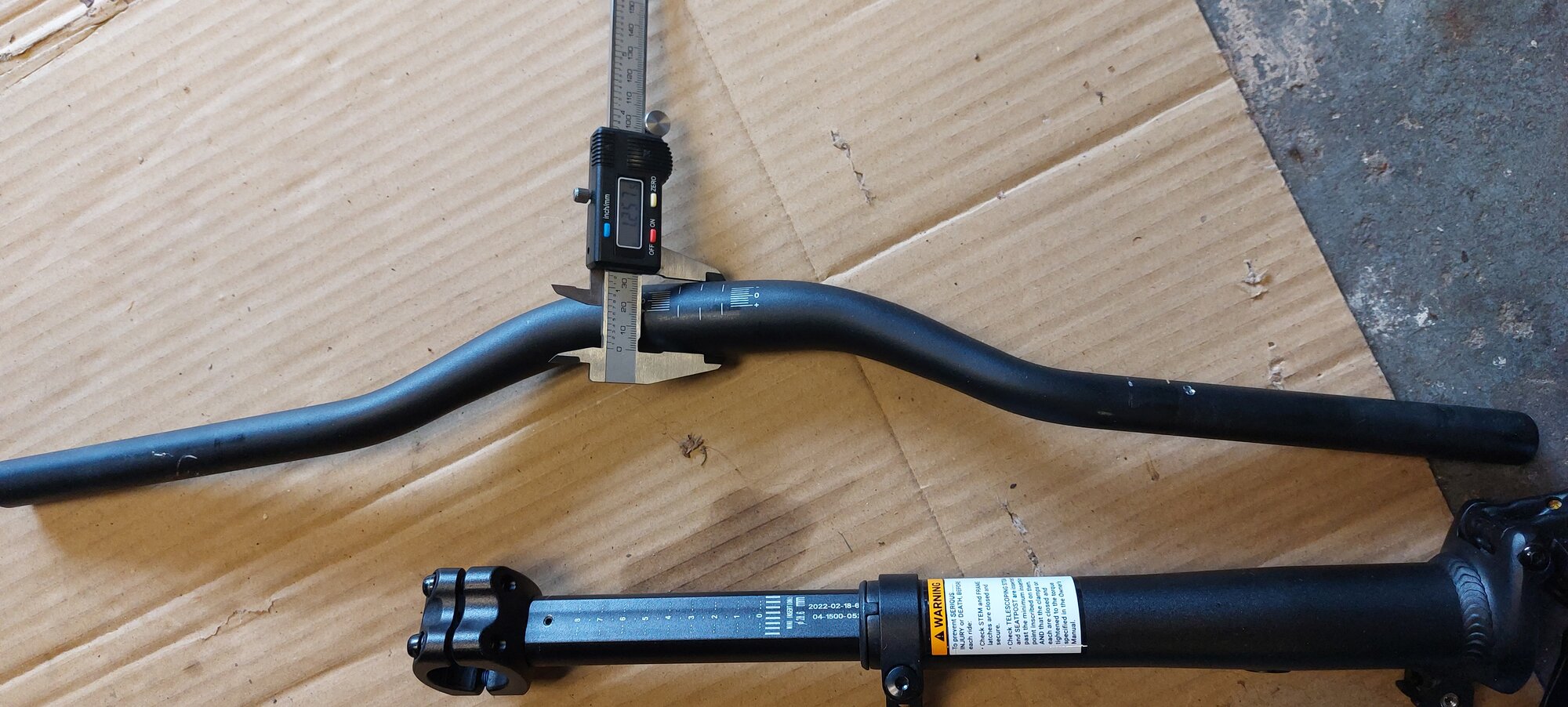

I don't fully understand you're question but these are the leftovers from my BMX bars conversion, thread below in the same section you posted.

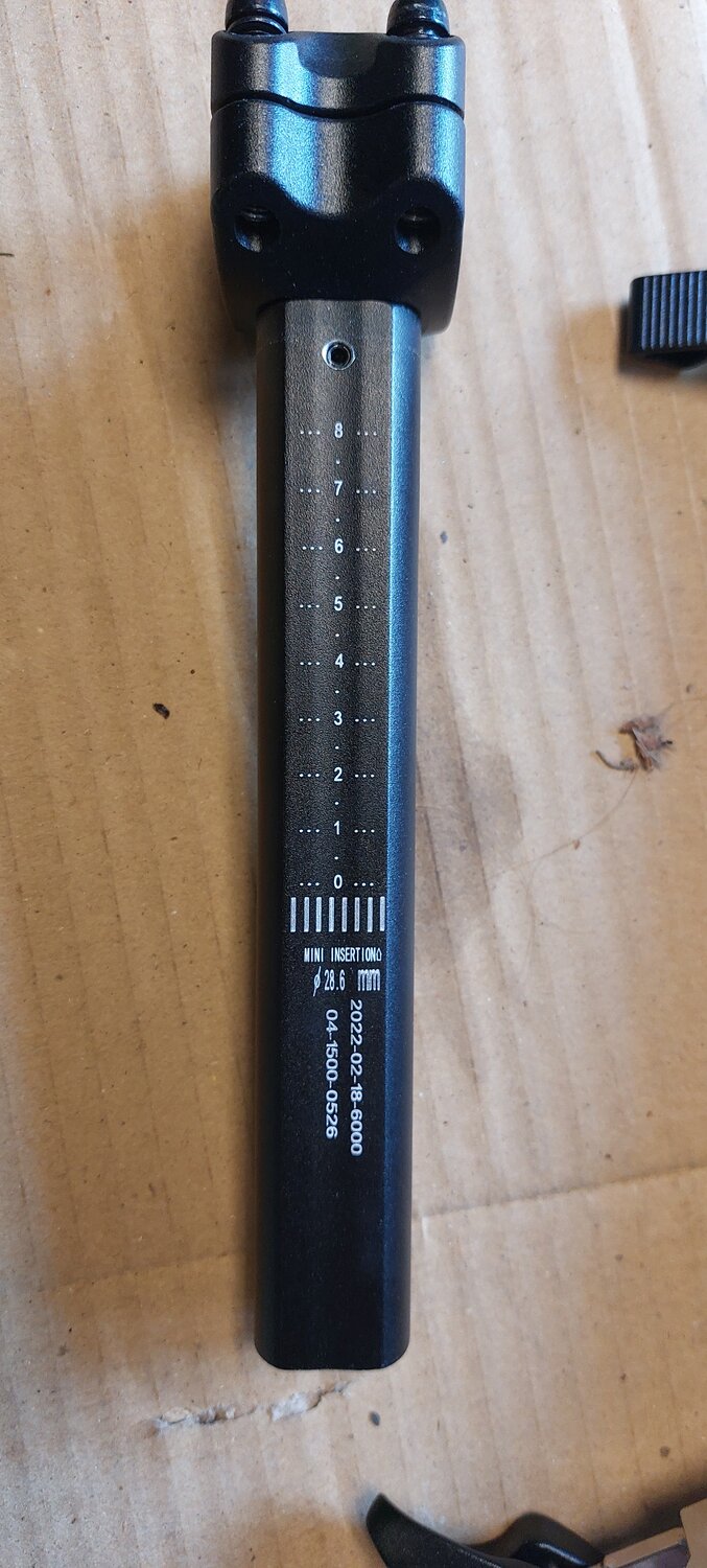

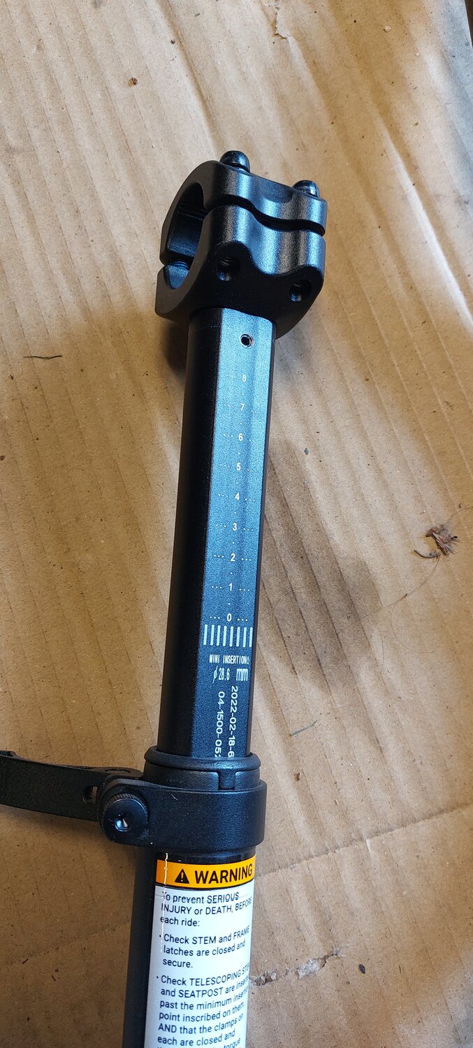

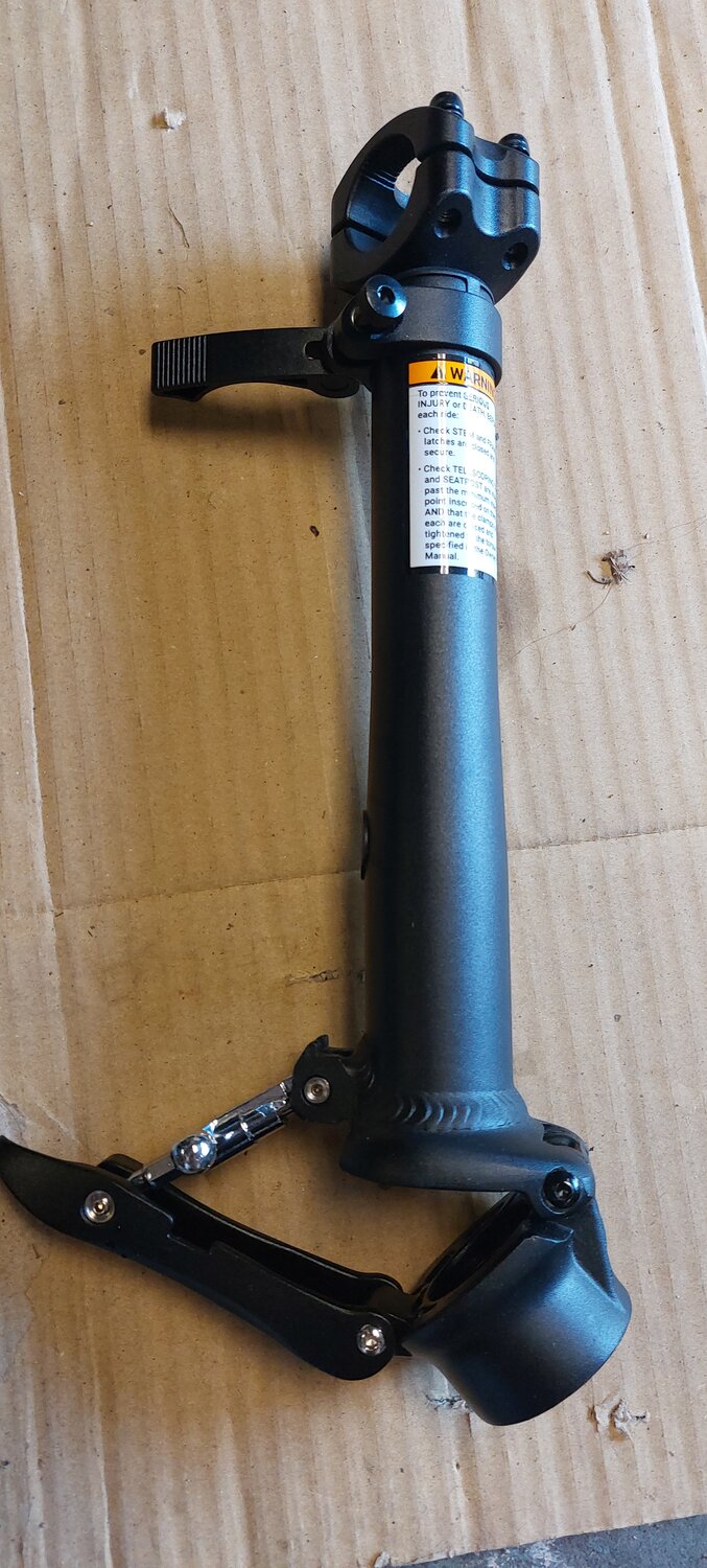

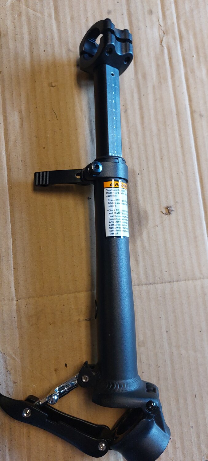

Your XP 3.0 will have the height adjustable stem like my 3.0 had. The picture I posted shows it beyond max. Give me a second......
Hope this helps.

Thanks for the replies. So the bar center diameter is 1.250” (1-1/4”). Great. I still need to know the diameter of the stem/ post itself as clamps come is various sizes. Thanks
Wait… I think I spotted 28.6 mm (1-1/8”) printed on the stem/post at the bottom . The post that sc00ter posted. Thanks
If you need anymore pictures or measurements just ask. I forgot to swap over to centimeters.
