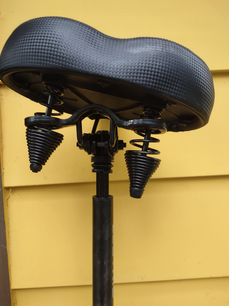

My daughter (all 130lbs) took the bike for a ride to test the PAS. The seat broke, tilted which jolted her into a telephone pole. 7 stitches later at urgent care we still have a non-function e-bike with a broken seat.
Similar thing happened to me, although I didn't crash. The seat spring is normally half above half below a flange, and if the spring is not rotated tightly enough then the spring above can pop out and go below the flange. It's easier to visualize than in words, but it means you need to get a wrench and rotate the spring until only the closely-spaced portion is below the flange. Or just get another seat.
Hope that makes sense. Sorry to hear about your incident, although when it happened to me the only effect was my right rear end dropped an inch or so.
