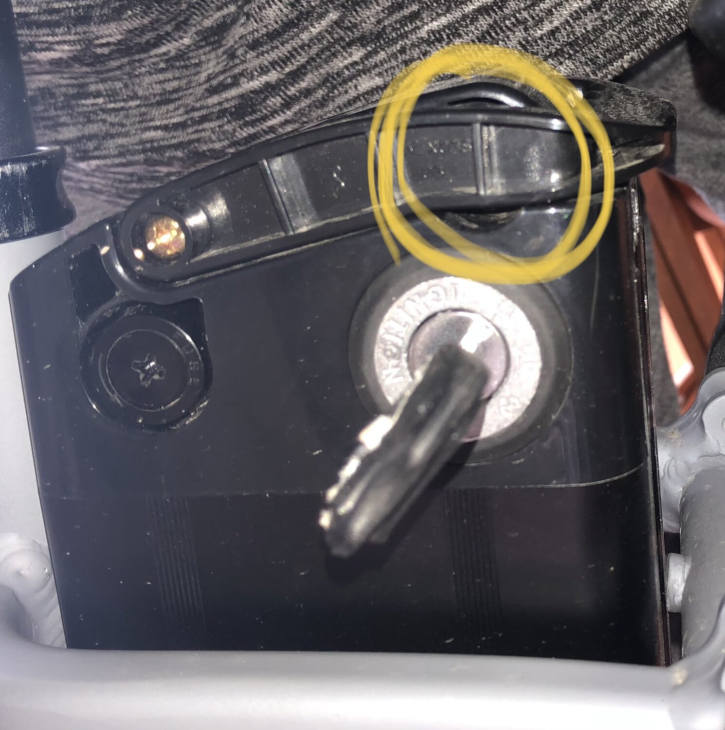

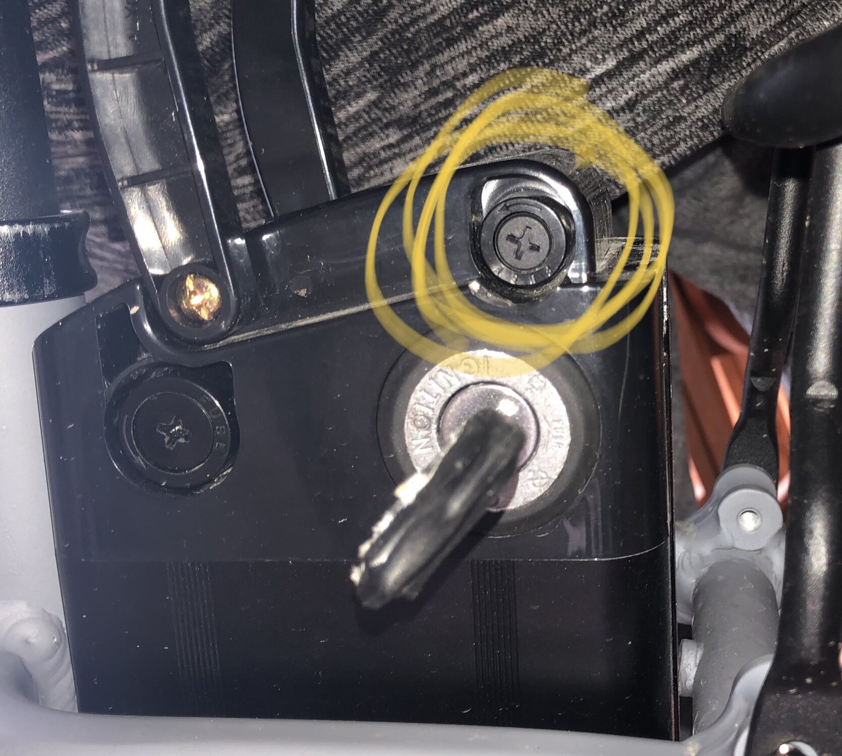

*Also - Taubik Bolt 2.0 owners, and those using the same battery as the Bolt, should know that there is a second, well-hidden fuse under the handle of the battery that you’ll need to change if you ever accidentally touch a key to the charging port. The Taubik dealer that sold my nephew the bike (EZ Rides in Belleville) didn’t know to check it when we brought the battery in and they kept it for over a week. They ‘offered’ us a replacement battery for $400. Thankfully, we declined and took the battery to a different bike shop that doesn’t even sell Taubik products. They found the second fuse that the dealer had overlooked. The battery didn’t need replacing at all. They had to search for quite some time but we’re so glad that they refused to give up. Below is a photo showing where that fuse is hidden. No literature is provided to the customer to inform them of it. They should include photos like the ones below to customers AND dealers so no one has to waste the time and money we had to.

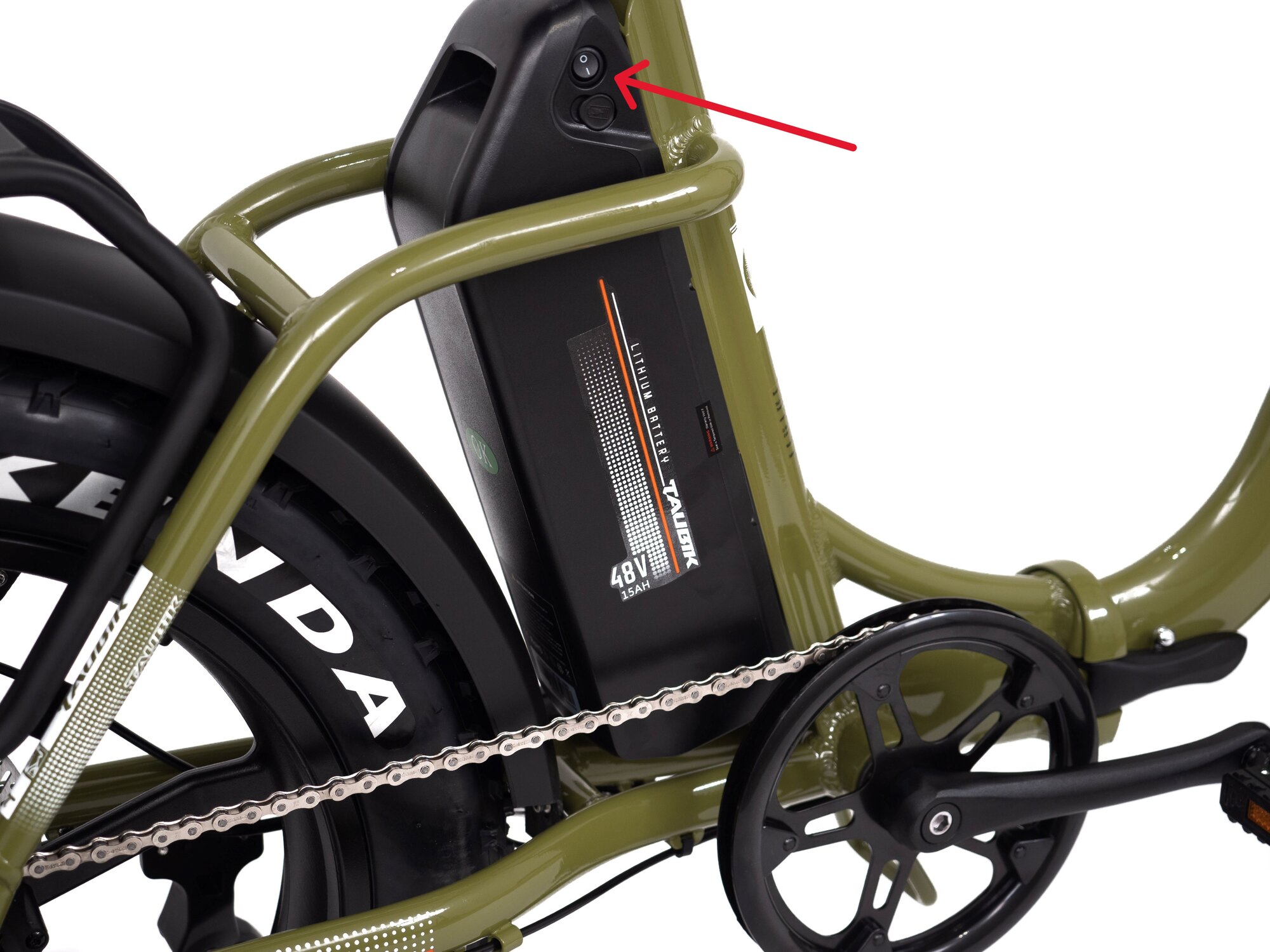

Your nephew reached out to me indicating he had placed his keys in the charge port and the battery no longer worked. I responded and said there is a fuse inside the charge port so that if something like this happens, the $2 fuse would blow and not the $800 battery. The battery was brought to the dealer where they informed me the fuse had not been blown. I could only assume that something inside the battery had been affected by the key being placed in the charge port, I wasn't aware both fuses had not been checked. Due to this exact incident, and the safety of our customers, we immediately went back to the factory to design something that would limit the chances of someone placing a metal key inside the electrical charging port. The new Escape which replaced the Bolt 2.0, does not require a key anywhere near the bike in order to operate. The battery is powered on by simply pressing an ON/OFF switch.
I will attach photos of this new design.
Hopefully this explains a little more in detail why some features are put in place on our bikes. It is difficult to design a bike that fits the individual preference of each customer, we try our best to listen to the customer, and build the best bike possible at an affordable price.

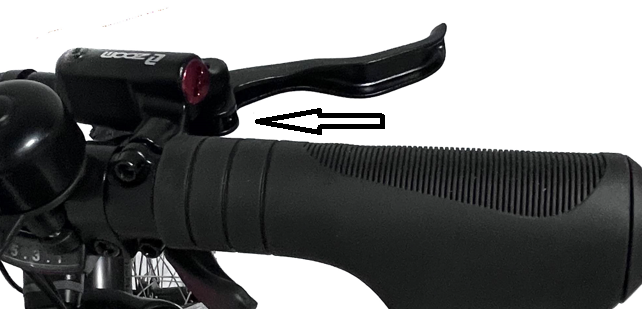

Off topic here . I have a soho 5 ...I need to relax the front brake handle . Where is the brake adjustment ....??..thanx...
Hey,
You can adjust the throw of the lever by backing off the Allen screw in the photo attached.
Thanks
