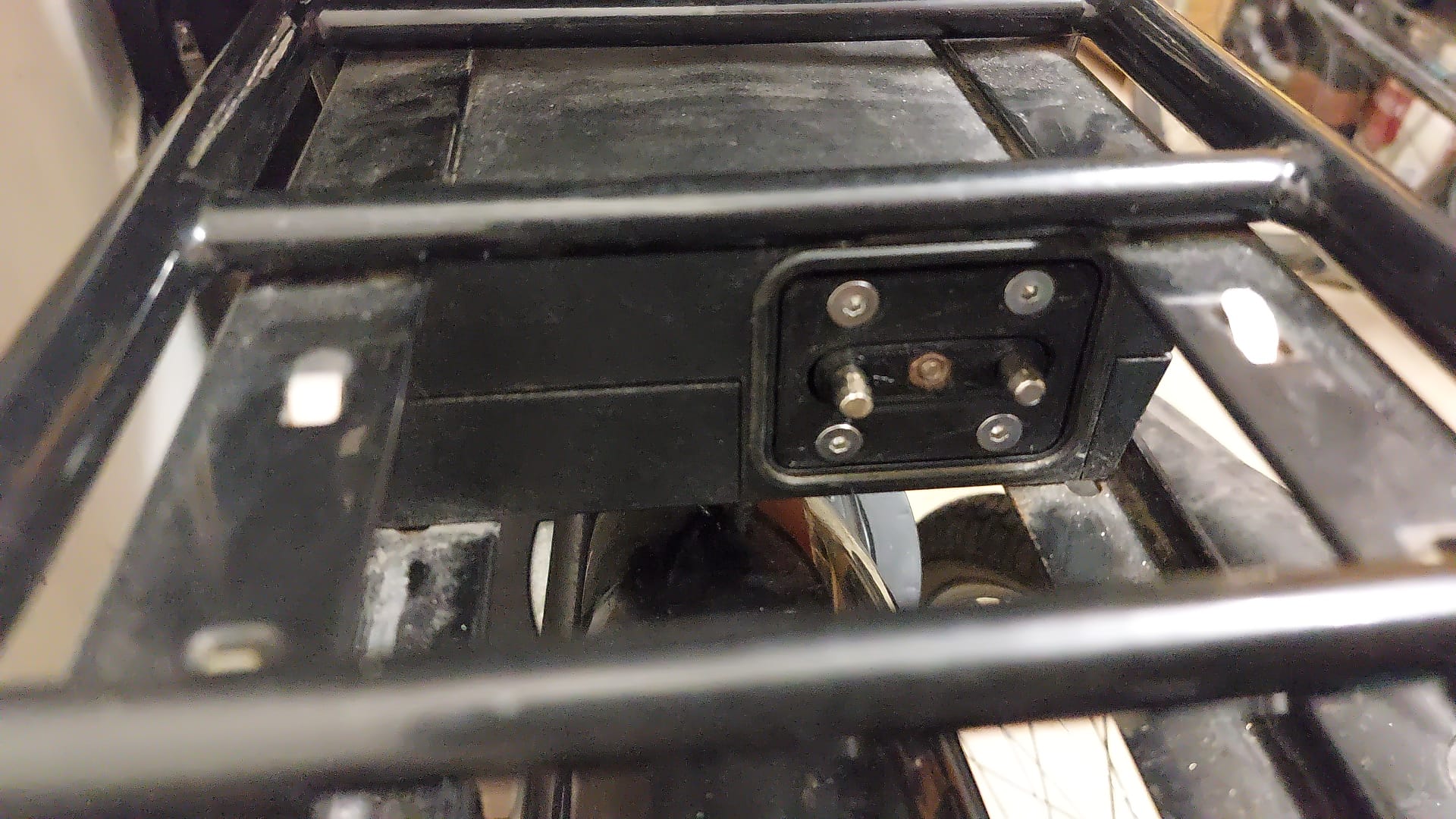

Overheated battery connector fix/spare part available.
I have a fix for a Babboe Big-E battery connector that overheated. It melted a spring loaded battery contact pin which stopped it from working. This spare part solves the problem.
