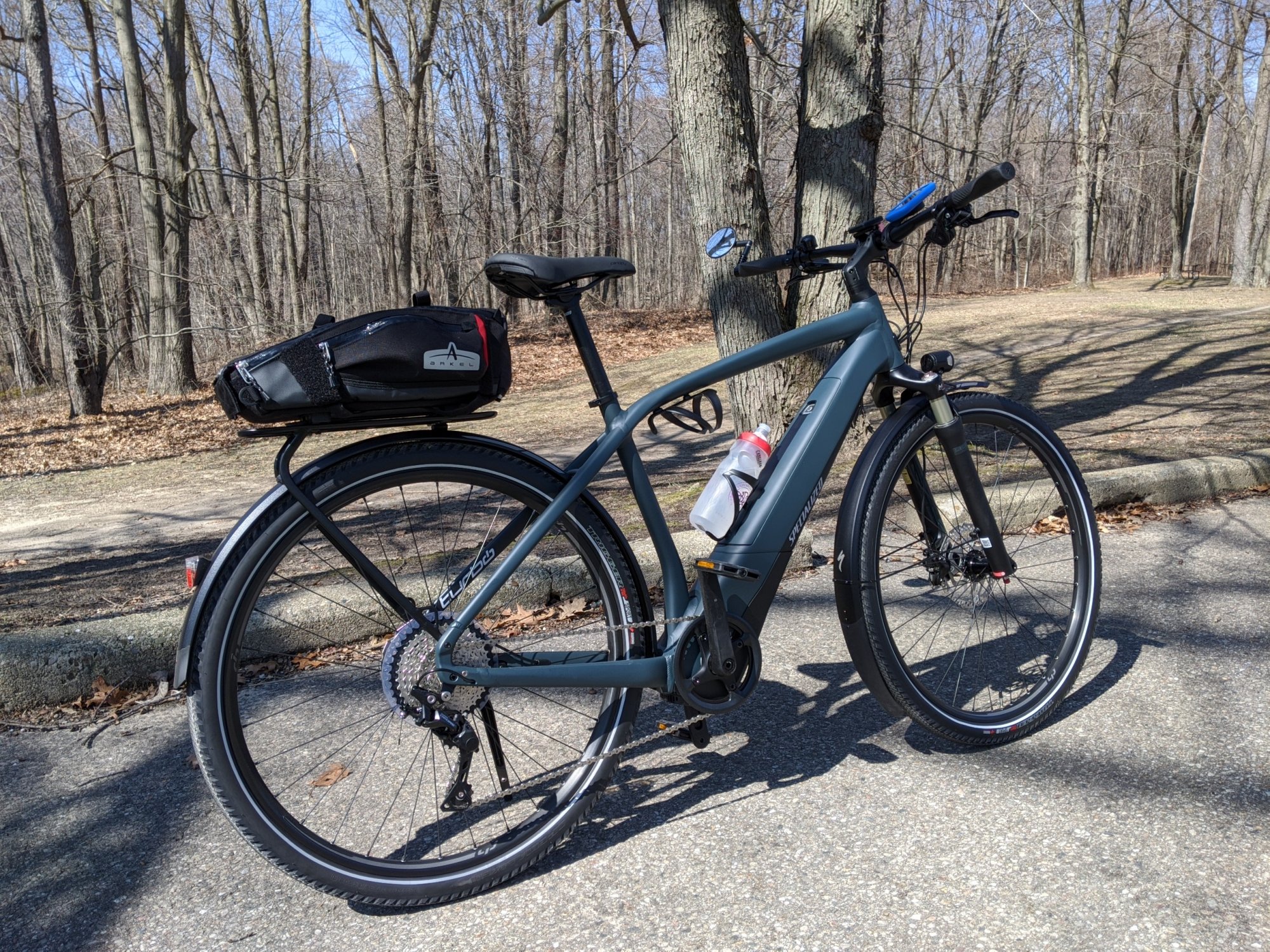

After installing my pedals today, my Vado 4.0 is fully "kitted out" for the time being. Here's a photo of it on a ride I took about a week ago (hard to keep track of time these days):

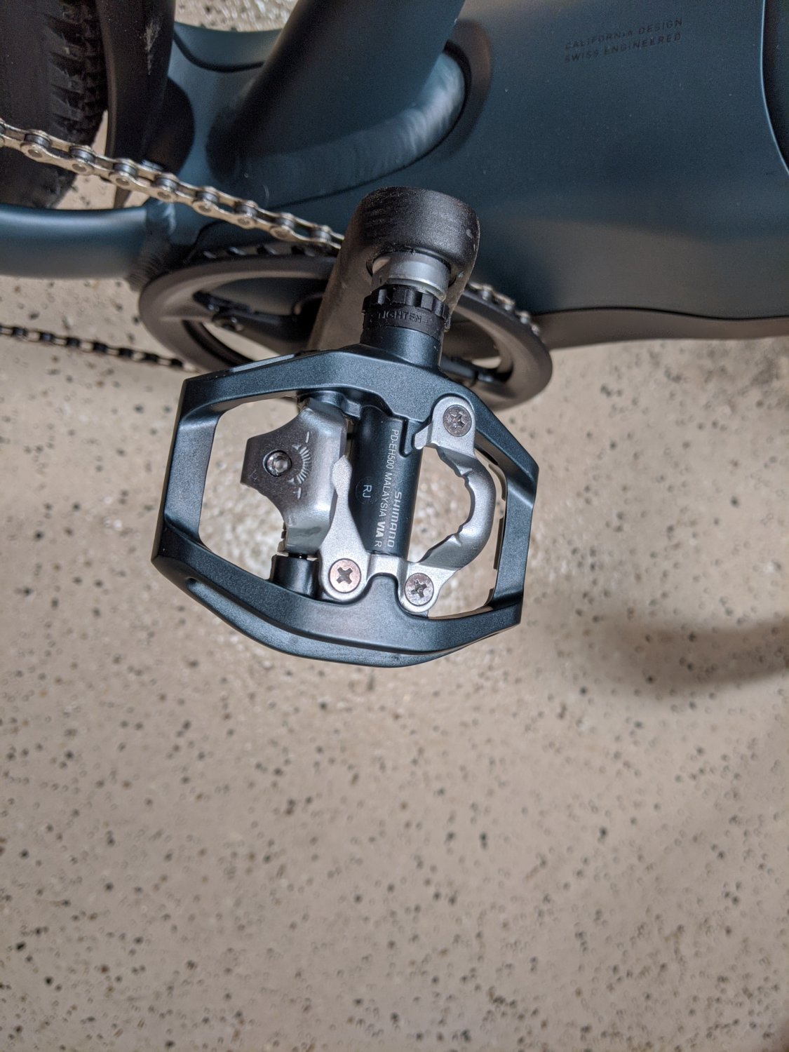

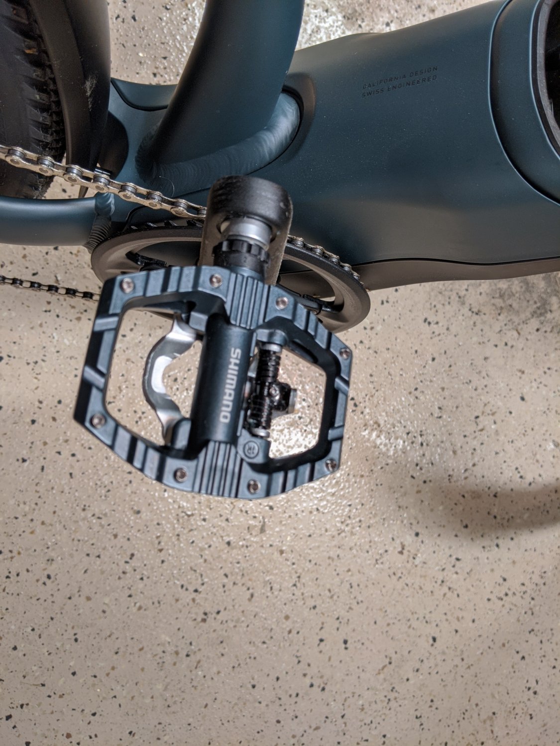

The bag is an Arkel "Tailrider" mounted to a Snap-It adapter for the Racktime rack. My pedals are now Shimano PD-EH500s with one side SPD and the other flat with pins installed:

I was all set to do battle with a pedal wrench, but the standard pedals can only be removed using a hex key from the back side of the crank arms (no flats for a pedal wrench). What surprised me was that they seemed to have been installed barely finger tight! Oh well, no harm done.
