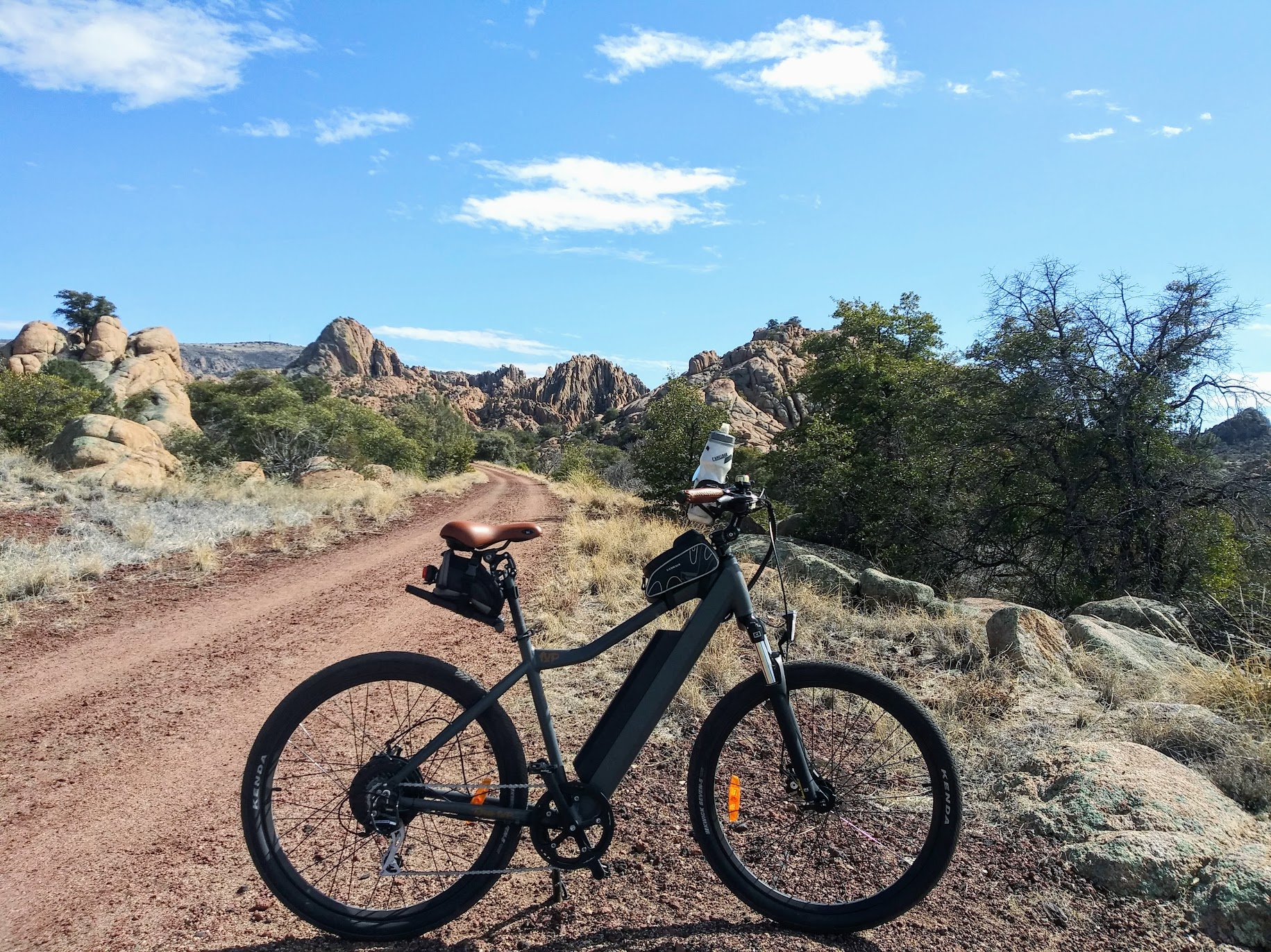

I've had a 500 for 7 months with 1600 trouble free miles. Good choice and happy riding. I've added a suspension seatpost, rack bag, seatpost rack and rear view mirror.
View attachment 82151View attachment 82152
View attachment 82153View attachment 82154
I love the look of that bike Andi want to buy one but I can't get a definitive answer about the size of it. I'm 5'5 with a 29 inseam and some people have said that it would be too big while others have said it would be perfect. I would hate to get it and have it be too big. It's really the perfect bike for me otherwise. What are your thoughts since you actually own one?

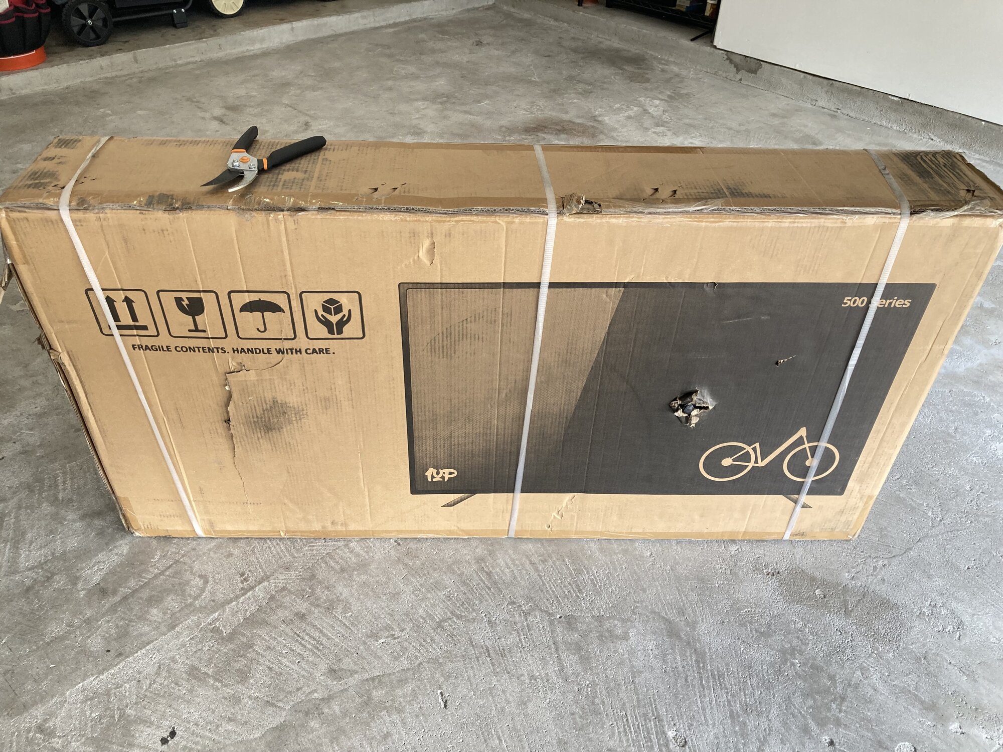

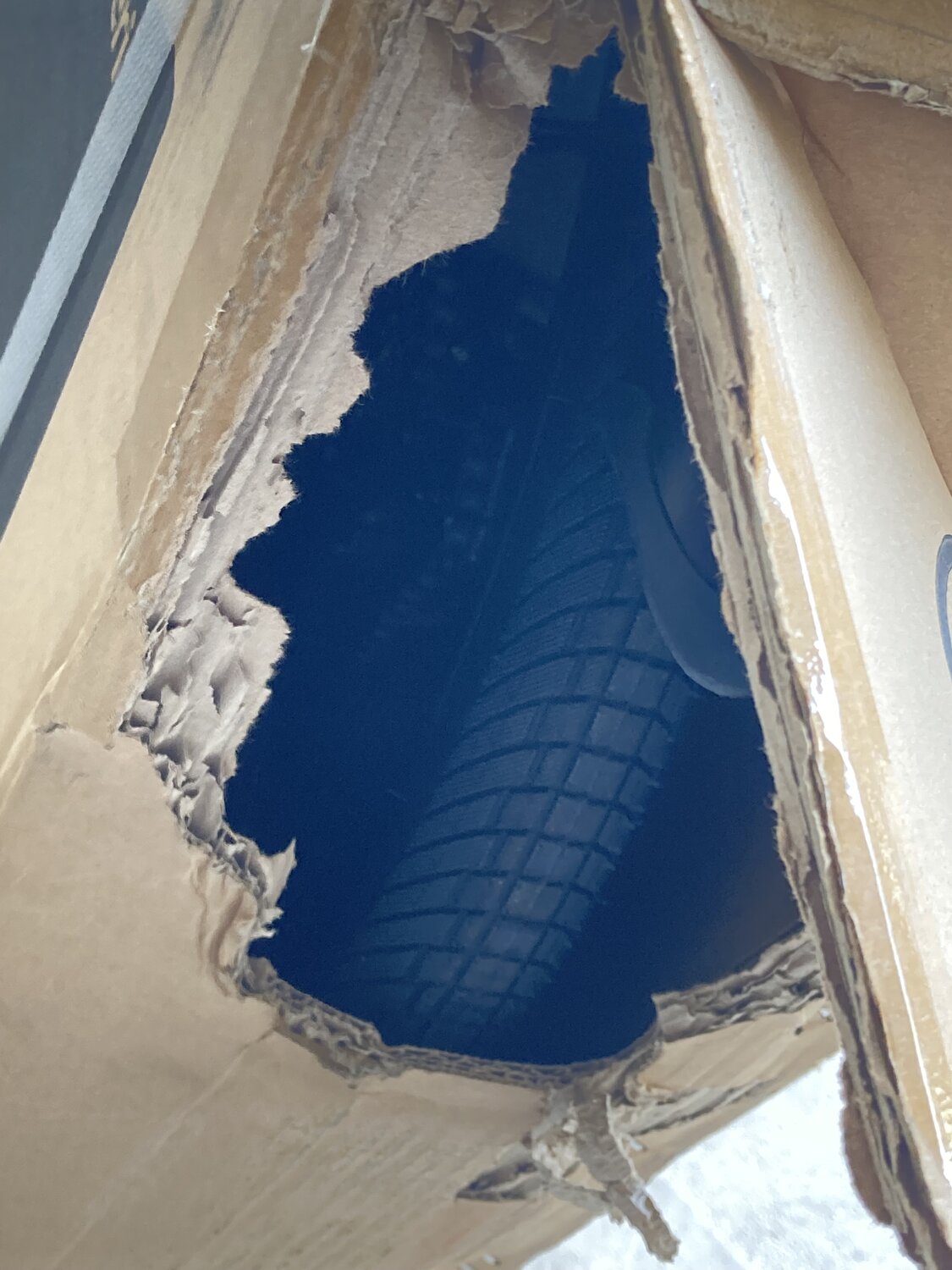

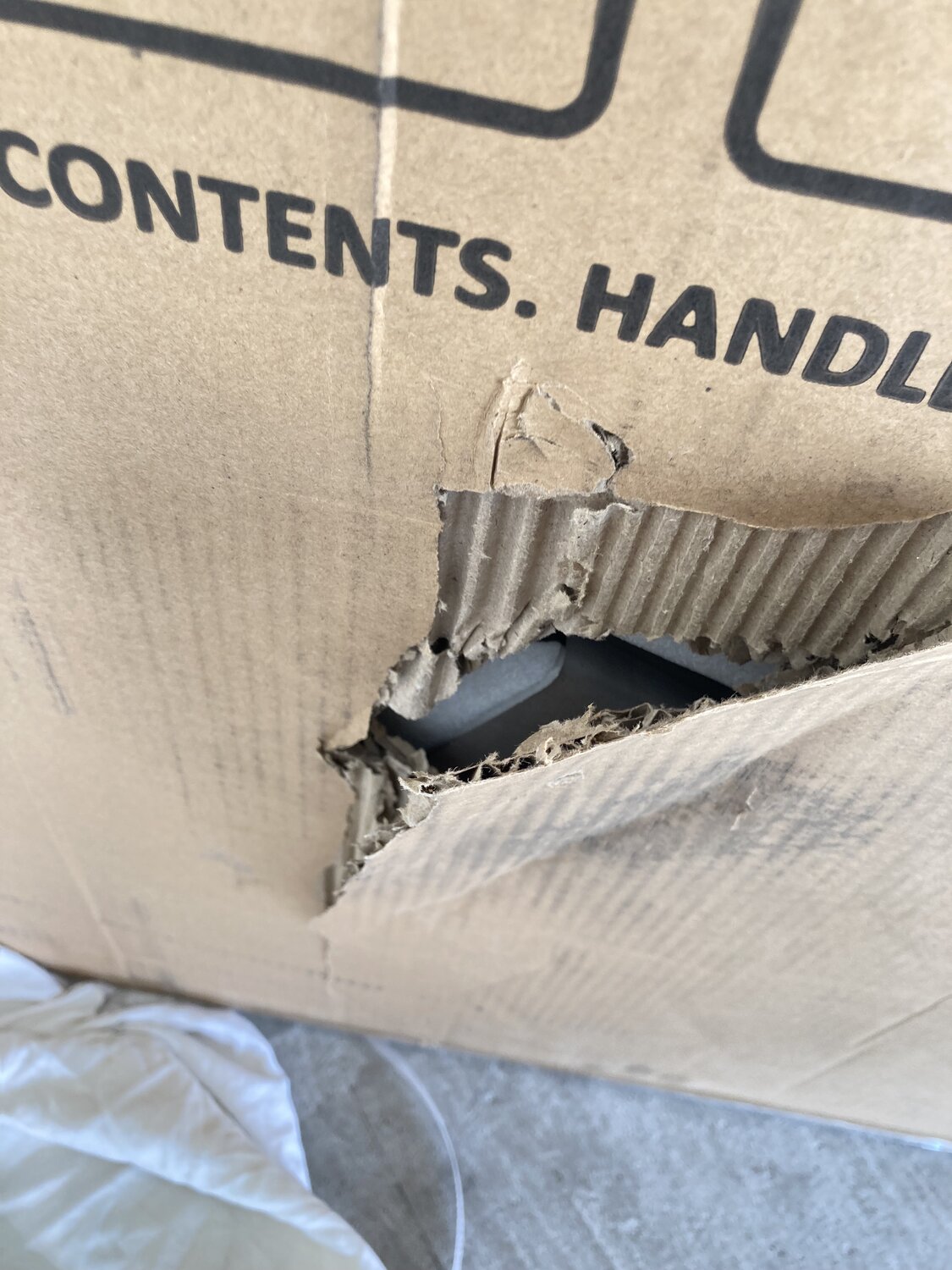

Received my 500 ST today. Fed/Ex delivered with box damage and upside down and lost hardware thru the box during transit for the rear cargo rack. The plastic bag holding the hardware was split open. Have an email out tonight to Ride1Up cs on my options and will report back. Haven't rode yet got late but will update.

R1U has stated they have sent me the hardware for the rear rack. I have had numerous issues with the bike including HUB motor whine and pulsing noise that rattles through the frame to the front headset and CS has been great always responded everyday trying to give me ideas to check and do. I think its the controller while riding with power on. When power is off nothing but normal sounds from the bike and its quiet. There are no brakes or fenders rubbing, In fact I removed them and sounds are still there. I have a rear tire that is fairly true but it spins like its oblong. I have checked and double checked everything I can to resolve the issues and the list too long of the things I have done. CS gave me setting changes to make and I did but the problems still there. Battery seems to deplete quicker than I would like using PAS levels1-3 according to other reviews. I'm not new to ebikes , but not a pro bike repair either. Ebikes should produce some noise but this cant be right. At age 60, I know my way around bikes. But as of now this is the loudest ebike I've ever owned and makes it to where I do not want to ride it. CS has been great and is still working with me. The box was so damaged upon delivery I can not or will not open up electronics to investigate. So I cant say what's going on inside the electronics. I like a challenge to repair and try to find an answer so I can help others, but I have spent days trying different things and my patience is about to run its course. I will update soon.
