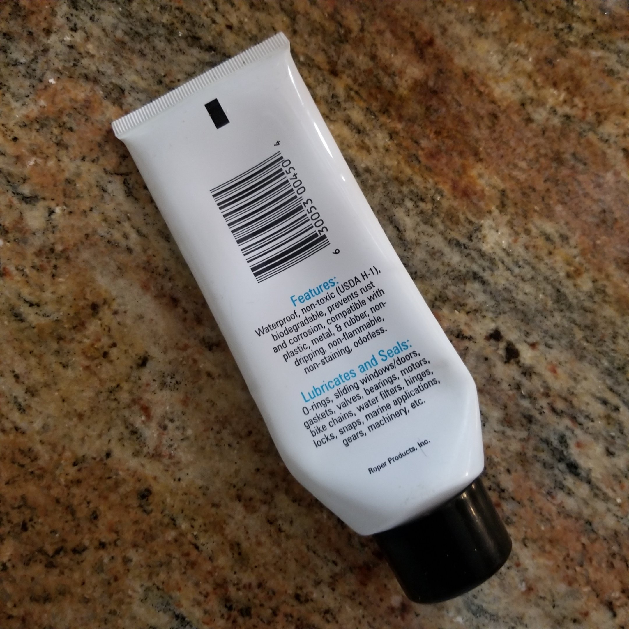

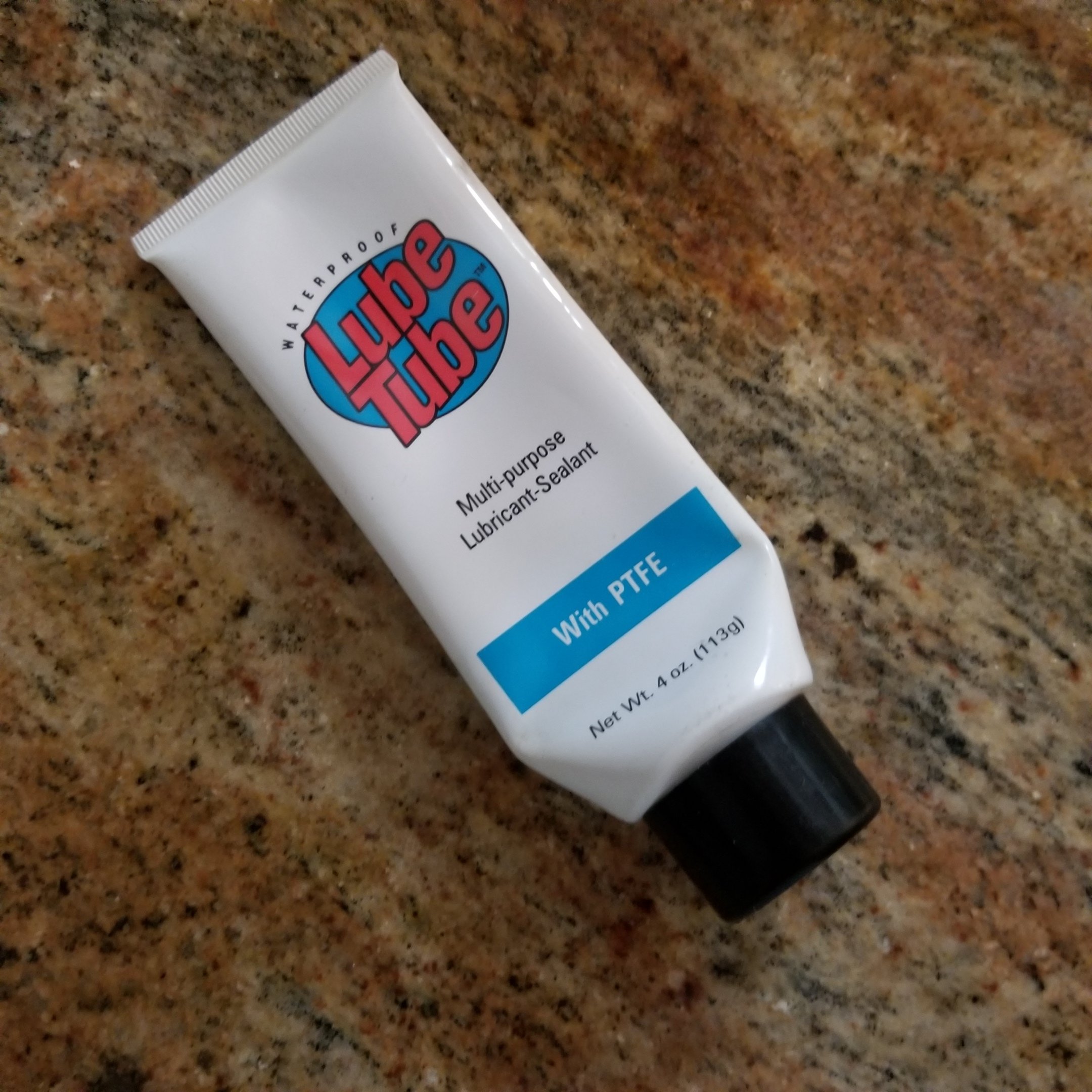

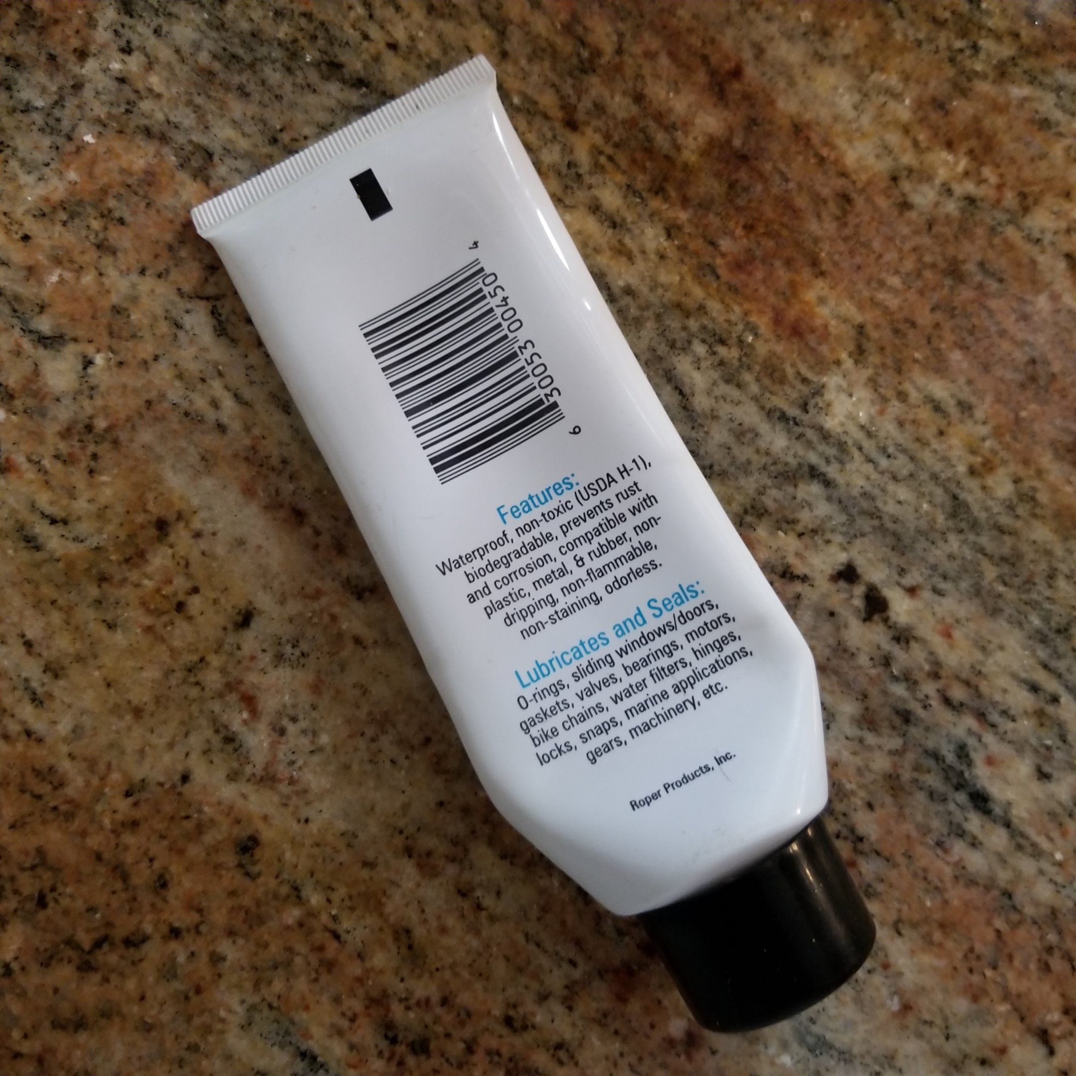

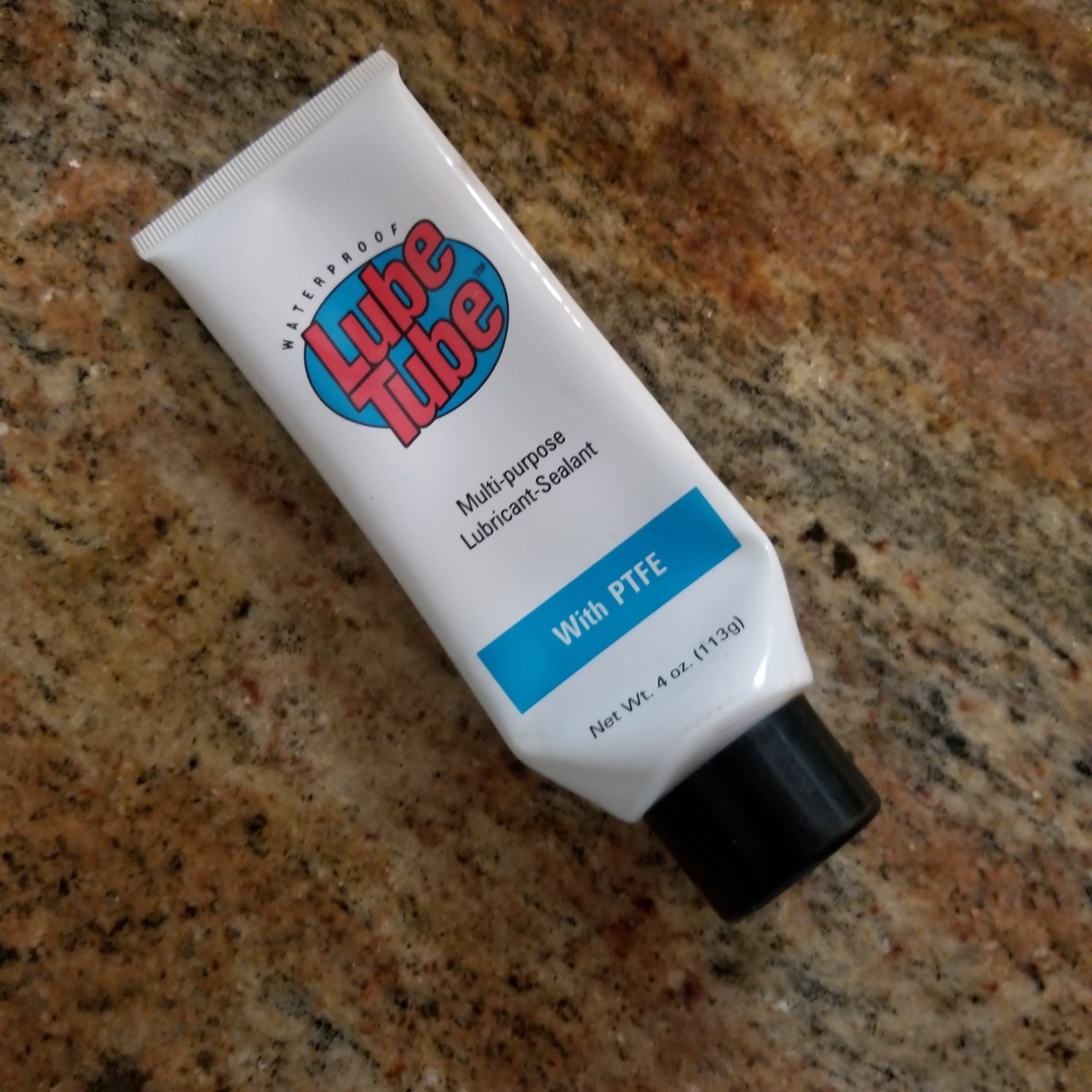

BTW, to folks who may be new to this stuff, all greases and oils are dielectric by nature, none conduct electricity.
However, metal to metal contact is made through any oil or grease if the metal parts are brought into contact with each other. Greasing an electrical joint is therefore harmless.
A preferred general purpose and electrical connector grease,
View attachment 22356View attachment 22357
It will not turn hard over time, separate or stain.
A silicone grease is also ideal for electrical connectors because it is absolutely inert and non-aging.
Both types available from Amazon
While using dielectric grease on an electrical joint is harmless when there's proper contact, it can possibly inhibit the connection when the contact is less than proper. After all, DG is a thick, gooey insulator that could easily get between these super cheap itty bitty pins and sockets on these Velveeta plastic bike connectors. The toy industry uses better connectors than these.
Anyway, I used Max Pro Electronic lubricant on my RCS's connectors which should keep the nasties out and will not likely help a less than perfect connection to fail. I'm sure DG will be fine too if you just put it where the male slips over the female end, and may even last longer. I've used Max Pro daily for 15 years on indoor and outdoor electronics. It's great stuff that everyone who does anything electrical should have.
Great point. An electrical connector grease should be
  • light bodied
  • non-aging
  • non-reactive with plastics and metal
The stuff I referenced meets these requirements and so will a liquid like Max Pro. (Is that the exact lubricant you use, Guitartec?)
