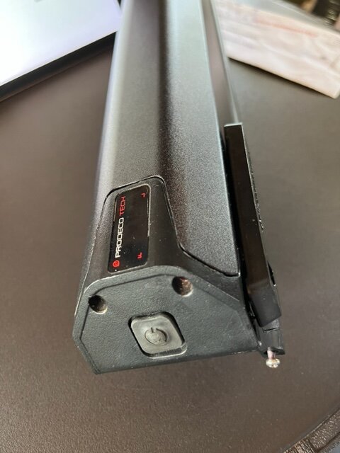

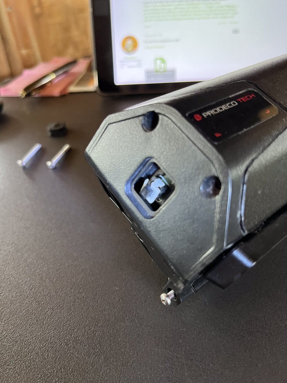

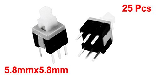

Reention Dorado replacement switch. The rubber button cover has the number PLA0095 molded on the inside but no switch matches. I believe I found the type of switch available most places, it’s a
5.8mm x 5.8mm Self-Locking DPDT Mini Push Button Switch.​
Just google the above sentence.​

So, that's a latching switch? One push for on, and another for off?

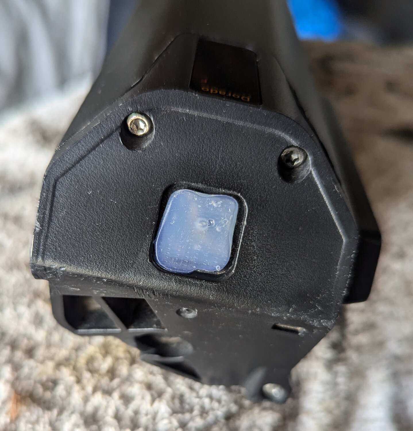

I've just bought a Benelli e-Misano which has a similar Dorado battery, and that rubber-membraned switch looks as tho' it's been glued over. Could you explain what this switch does, please - is it just to activate the power level lights? Or the USB port?
Mine outputs the full ~42V from its connection socket, but the level light doesn't come on, nor any power out the USB. I should add, tho', that the whole bike needs sorting out, and I haven't actually fitted the battery to it yet!
Thanks.
EDIT: Took end cap off - there's no circuit board inside! No LED display, no switch, no PCB. I guess it was removed at some point as faulty. The battery does work, tho', and outputs via the normal socket, and has an inline fuse. What did this switch actually do? When would the LCD power display come on? Thanks.
