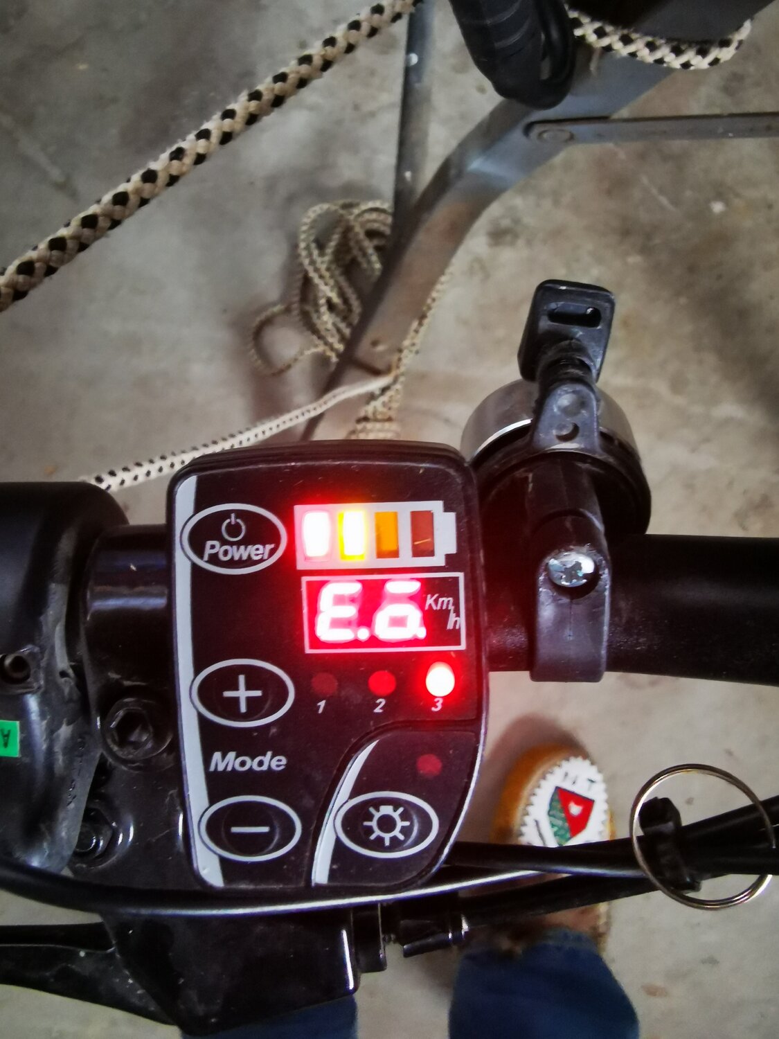

Juggernaut D1 AWD 36v shows Code E6 I think
bonessk01
Canada
I say that I think its an E6 because it actually shows up as E with a horizontal bar over a small o.
Wondering if this is a low battery voltage code because when it happens I can push button on battery and it still shows full charge.
if I power off bike and turn back on code is gone but returns after riding for various lengths of time. motors shut down once code apears. only other thing I have seen is Speed fluctuates downwards to zero even though bike is running at top speed shortly after hitting zero , control panel shows code.
Anyone have any ideas.
