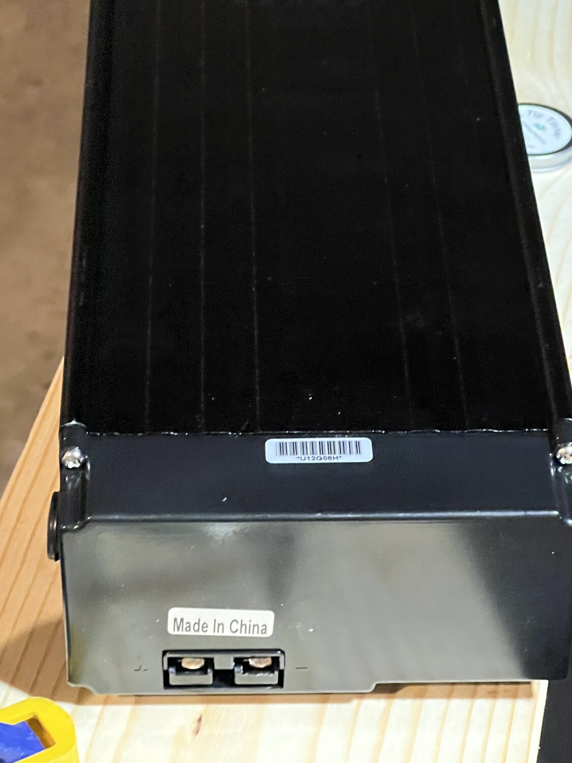

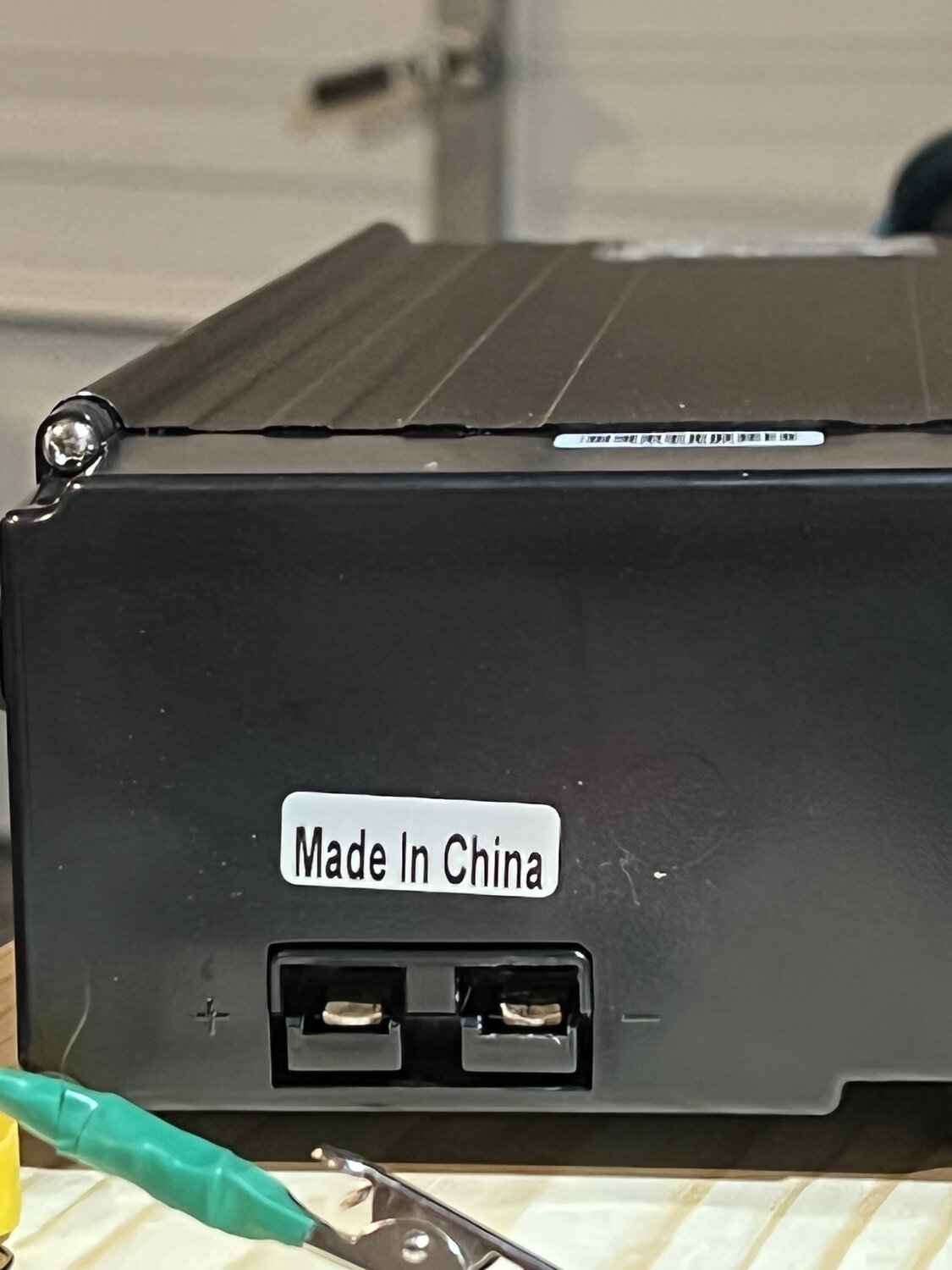

I need help: what is the best way to solder wires to the battery terminals of a Joyisi 52V battery? (See photos)
In the 1980s and 1990's the computer industry was marked by a lack of standards among hardware manufacturers. Seems the ebike thing is in the same phase. Someday it will improve but until then... I bought (very recently, it just arrived today) a 'Joyisi' 52 volt battery, aluminum case, mounting rack etc. No joy here - the damn thing arrived with bare terminals. I need a functioning battery and don't want to wait Why is this an okay thing for the seller to do? I've sent my questions to the seller but don't expect much. I'm mostly angry with myself because, once again, I made a stupid purchase and have to suffer the consequences of my own stupidity.

You mean, like speakers? The terminals do not appear to have this function (I've tried to push them down buy there is no space for a wire at all.
Oh - the alligator c;lip? Earlier I tinned the tips of the X-60 connectors

That's a socket for Anderson SB50 connector.
Did a quick comparison and, that is an Anderson socket.
Very strange set up, as now you need to know what size Anderson to plug into it.

Would it be possible that they just forgot to include the Anderson SB50?
Looks like they would normally include the SB50 connector.
It would be much easier to ask them to send the SB50, instead of returning the whole battery.
Also, what do you mean by what size?
I doubt it's an SB120, SB175 or even SB350. I know it's hard to tell by the picture, but I would imagine most ebike battery will be equipped with SB50?

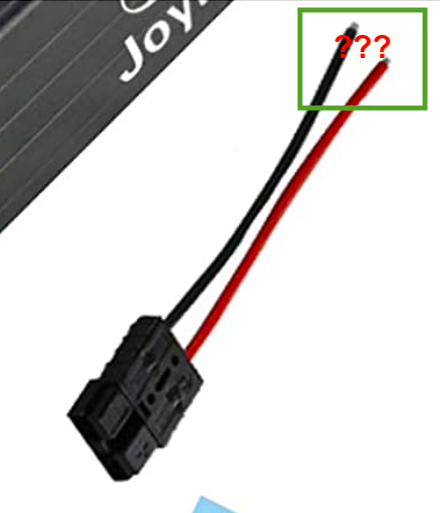

Amazon.com : Joyisi Ebike Battery 52V 48V 36V 20AH Electric Bike Battery  for 200W to 1800W Bike Motor, Lithium Ion Ebike Battery Pack for Bafang  Voilamart AW and Other Motor Bicycle :

Or Some blade connections in a larger awg (or Gauge wire) that will slip over the blades.. I did that with another batttery I did a retro on with another bike.. worked great.. Just makes sure its tight and wont vibrate loose... You can use a screw driver to adjust size a little and plyers to pinch the ends back down a little..

Really easily solved. Timpo opened the door, now the OP simply needs the seller to step up or make an Amazon order that will arrive in a day or two. Aftermarket batteries and kit building very often require changing connectors. eBike 101? or more like eBike 5th grade...
The pictured pigtail will STILL need connectors to match the motor input.
