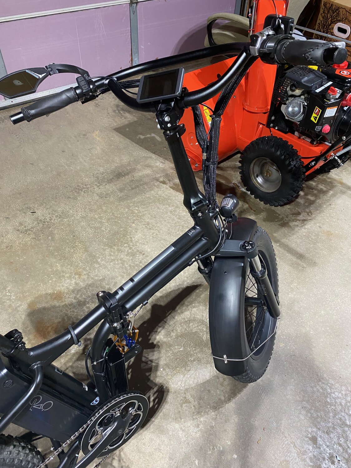

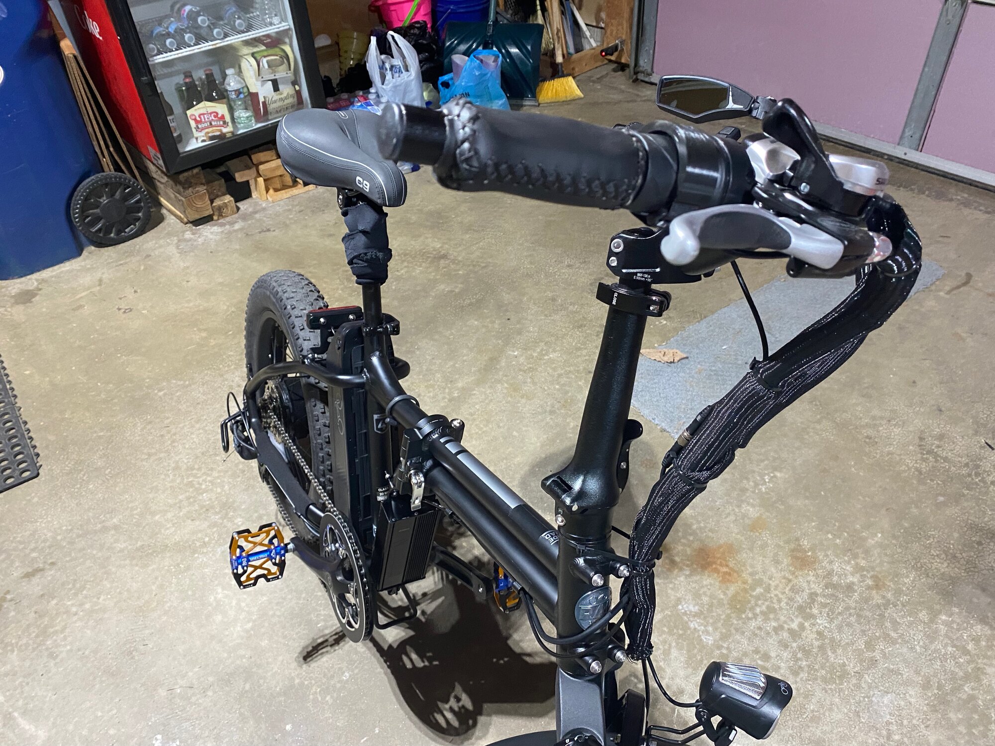

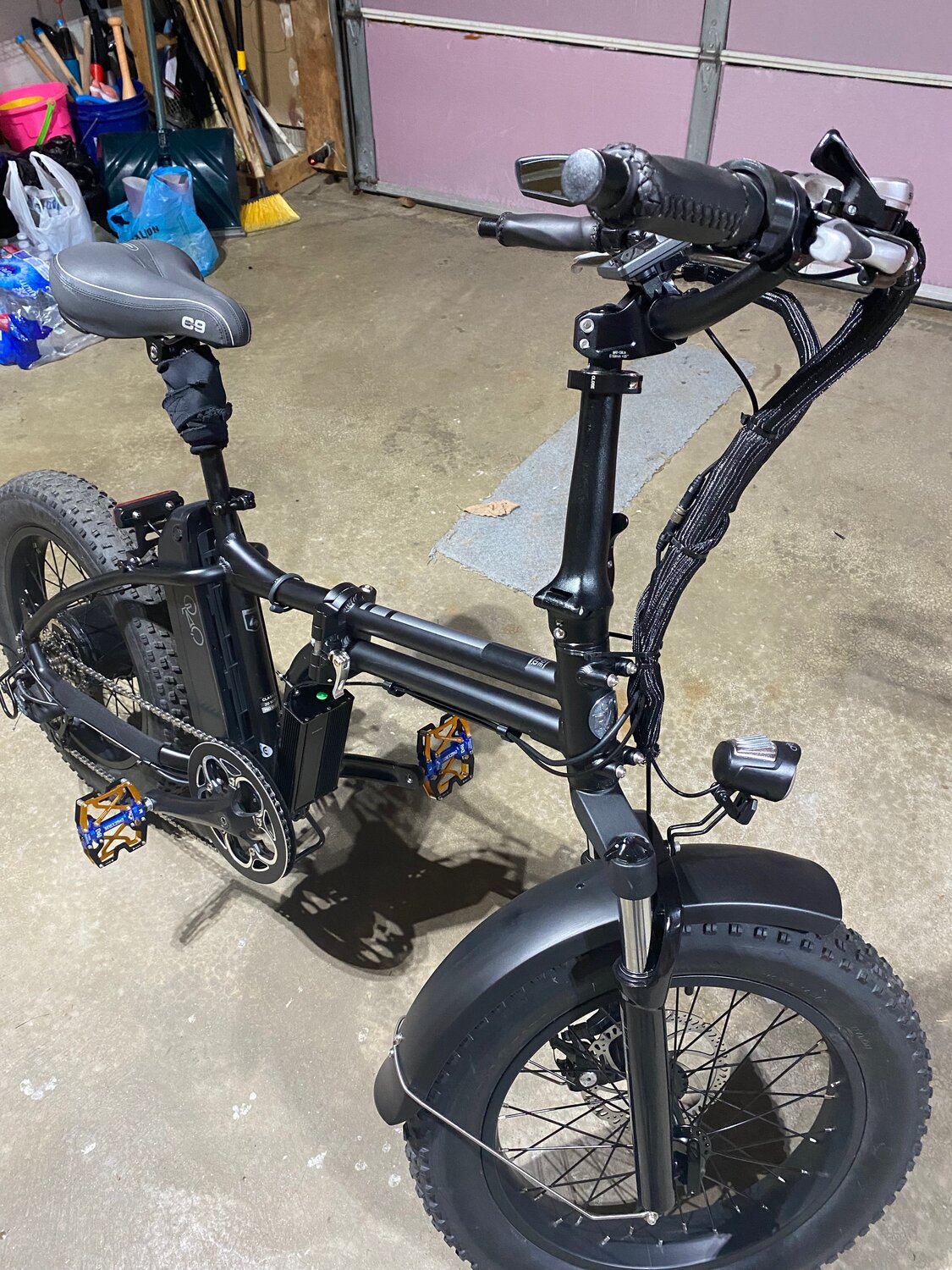

I'm using this on a folding fat tire bike with a stem riser already included. Meant to mention that. It's not too high, but I've got a very slight feeling of riding a laid back motorcycle with raised handlebars....very slight. I got the longer 710mm bar (vs 660) and am considering cutting the ends a bit. But I want to get some more experience with it when I focus on the ride and not the freezing. lol

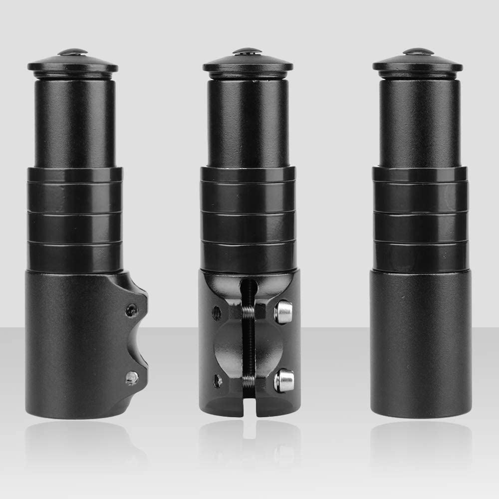

I personally would get rid of that stem riser first. Those things are a menace. I'm assuming you mean one of these:

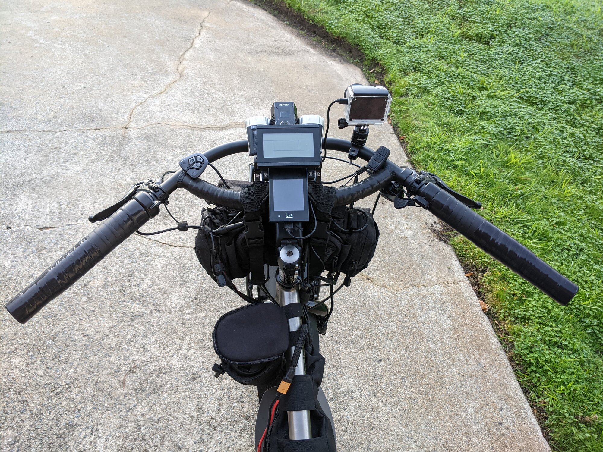

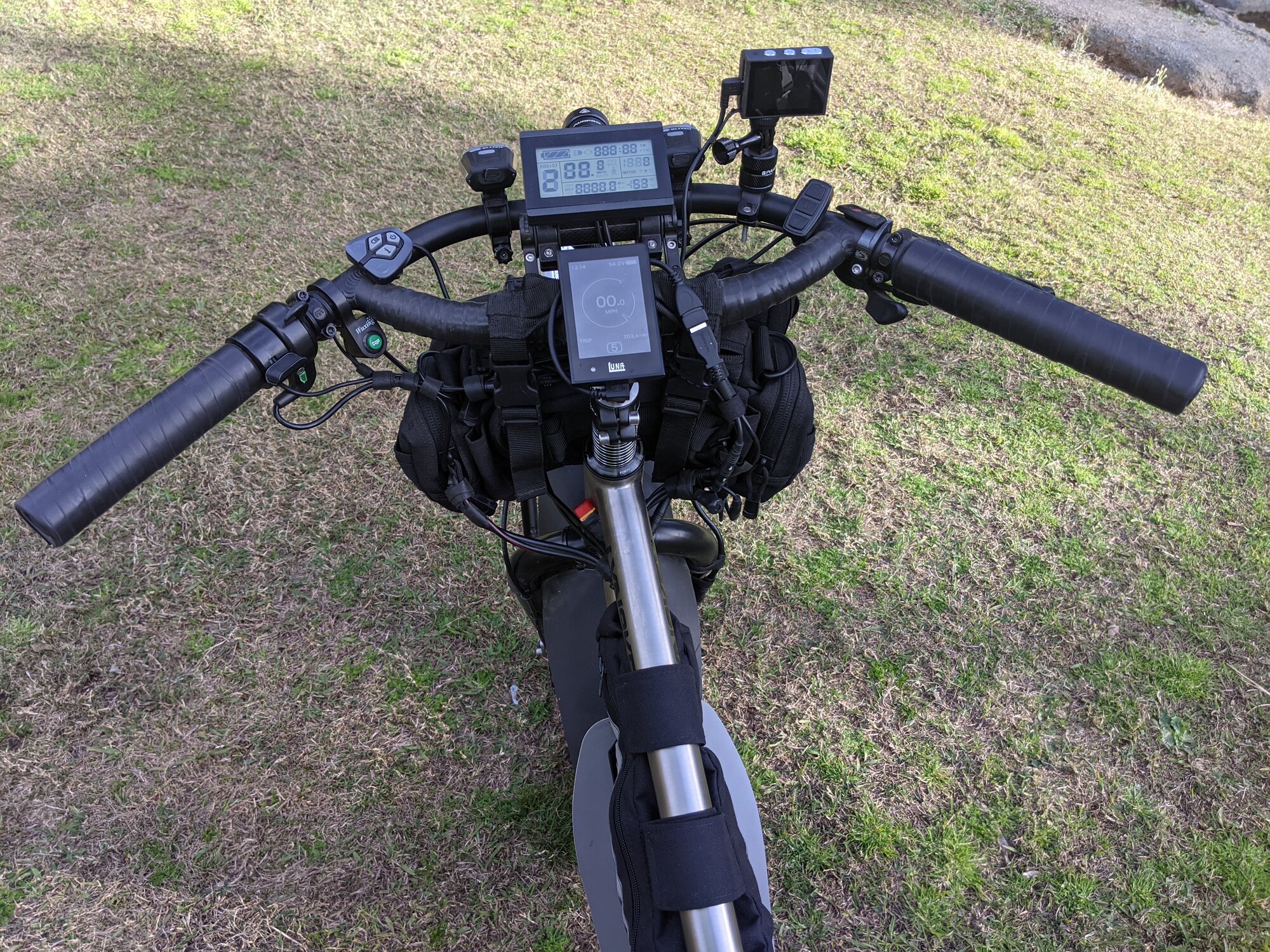

I have all of mine at the wider width. In fact I have recently found I very much like extending them to roughly 800mm. Not something everyone would do by any means. the extra length provides a nice sit-up-and-back option for the times you are cruising and for sure won't be needing the brakes in an instant. I use thick aluminum tubing cut to fit within the available length of straight gauge alloy in the bars, affixed VERY firmly with a silicone wrap over the inner tube, then covered with Wolf Tooth Mega Paw (my choice for that extra diameter) grips, two per side and sealed together with the same silicone tape used as a grip wrap.
Even if I didn't extend the bars, I do something very similar with the grips. the silicone grips wrapped in silicone tape are very survivable over time and if you take a divot out of them, the self-adhesive silicone tape sticks to itself so you can just do another wrap and ... instant repair.
I have been using a 710mm Jones H-Bar with 2.5-inch rise plus a stem riser for several years on my 2016 Haibike AllMtn ebike. If anything, I found the Jones H-Bar provides more control, not less. I also like the extra real estate for cockpit gadgets. Just like @m@Robertson, I put a lot of stuff on them: bell, lights, GoPro, iPhone, etc.

Stem: I'm stuck with the stem rise on this bike. It's a hybrid\campground use bike for a couple years while I heal and hopefully get back to some mt biking before too long.
Width: I like the feel of the 710 when cruising, but things get tight for me often enough that my ends will snag. I might take as little as 12-15mm of each end.
Test: I bundled up and took a 10 minute test ride today. I raised the seat higher the way I've always sat on my mt bike, so my legs are close to straight on the down stroke. It's an improvement over how I felt with my previous test, but I still feel like I'd have better control with a flat. Would be great if there was a way a perform a quick change for different types of rides. I'll plan on testing or purchasing a flat soon.
