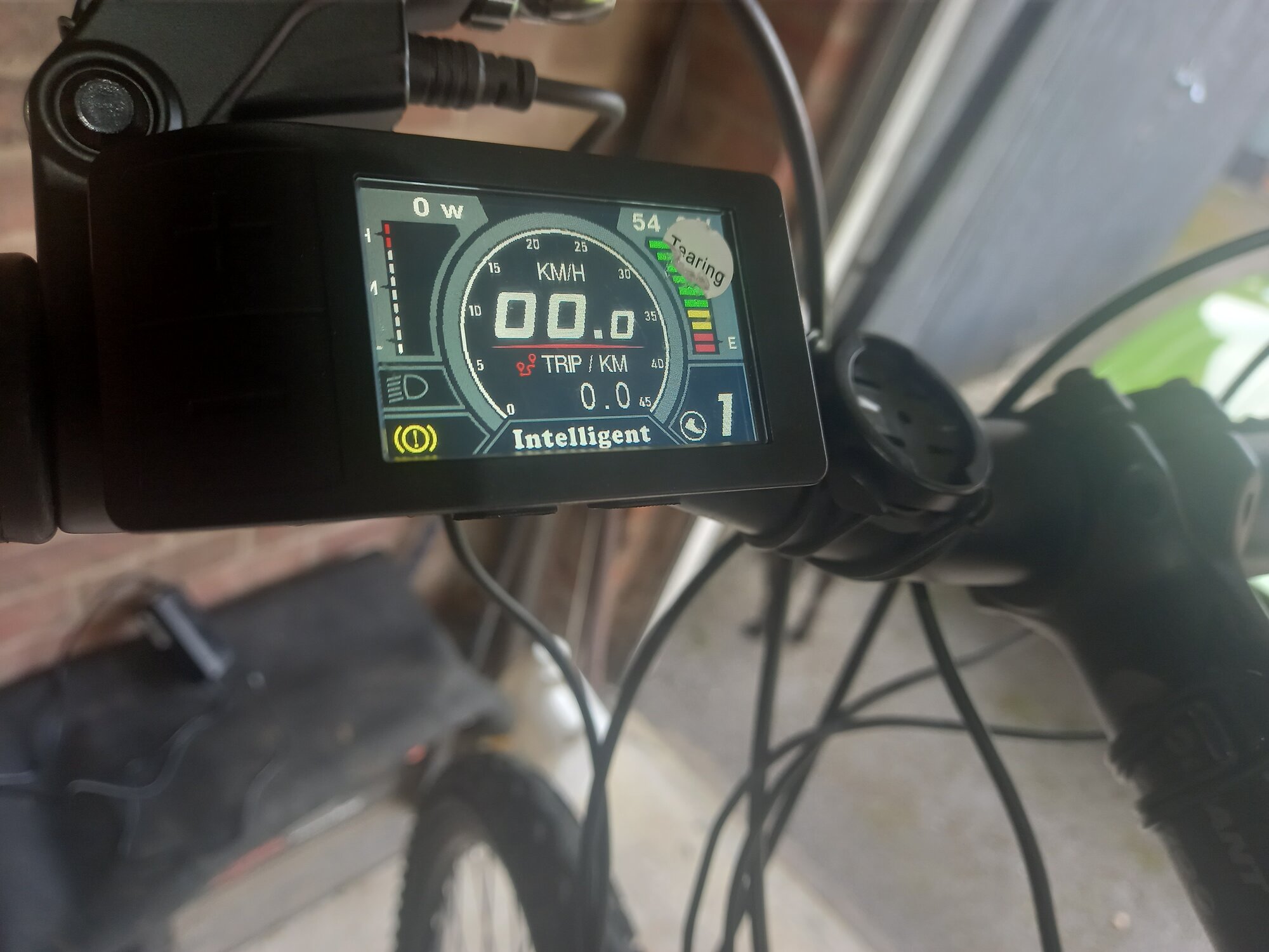

I've just installed Bafang package to my bike
Smac
United Kingdom
I've just installed Bafang to my bike, getting power to the screen and all the connections are good but I can't power to the electric motor, how do I do that, any help would appreciated
Do you have a multimeter device? For checking connections?
I am unfamiliar with your display, but the lower left hand corner yellow brake indicator may indicate your brake (motor cutoff) is engaged and therefore no power to the motor. It should not be Yellow. Somewhere your brake cutoff switch is engaged. Disconnect your bake HIGO plugs. If the light goes out, you have found the source of your problem. From there it should be an easy fix. It goes without saying, but I must say it, be careful operating your bike with brake motor cutoffs disengaged.

DO YOU HAVE A MULTIMETER?
When you say "can't get power to electric motor" what do you mean?
A: The throttle does not work.
B: When I ride and pedal the, there is no pedal assist.
Try a couple of things: 1) Disconnect the brake lever cutouts. Then, 2) Try Walk Assist whilst in the stand. If that works then check the brake lever pins with a toothpick to gently straighten a bent one. Now try riding the bike pedal before throttle. Many these days are setup so that you cannot throttle from a stop - to prevent accidently bumping the throttle while not intending to go at an intersection or when walking through glass doors with a bike.
Some firmware will not let the motor run if the brak3 cutouts aren’t installed, OR a bad cutout May be stopping the motor. Do a continuity test on the brake cutouts.

THat did the trick I kept thinking it was something simple Ive got a brake disconnected awaiting a new cable barrel, thank you so muchI was going potty trying to sort it out.
