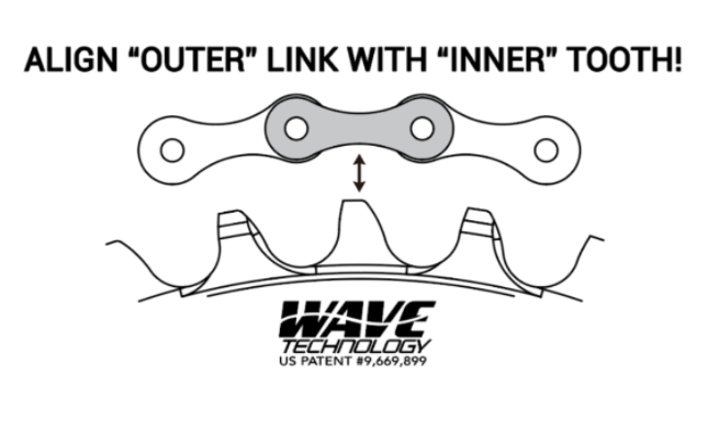

I think that I have had it with this finicky WAVE technology need to align a chain's outer plate with a certain tooth pattern. Once again on a steep hill my chain jumped off to the inside of the chainring on my Creo, wedging between that ring and the motor housing. And then it did it again. And after tackling the hill, it did it later in the ride, again and again and again and again and AGAIN! I presume that ripping the wedged chain out probably kinked it and it would no longer stay on the ring. Gave up the ride and called for help. Called AAA and I would probably still be out there and certainly after sunset. Finally reached a friend and was bailed and thoroughly frozen.
So, is there really any advantage to the "patent 89,669,899" WAVE tech? The bike shop opens at 10 and I will have them add that small chain protector thingie from Specialized and probably have to replace the chain and/or chainring. But I think I will opt out of PATENTED chainrings.

  • First of all, I sympathize with you.
  • Secondly, the WAVE technology is one of chainring solutions as good as the Shimano Narrow-Wide technology. Now fancy that you ride a traditional chainring with no features helping the chain stay on the ring. Would it be better?
  • Thirdly, there must be something fundamentally wrong about either your e-bike or your style of riding. You have got the most modern technologies widely used in MTB: the Wave chainring, and the Shadow clutch on your GRX derailleur. And your chain still continues jumping off the chainring? It has never happened to any of my e-bikes, was it a cheap Shimano Alivio groupset or Deore XT/SLX and two of e-bikes are equipped with either WAVE or Narrow-Wide chainrings (the fourth e-bike had Narrow-Wide pattern chainring).

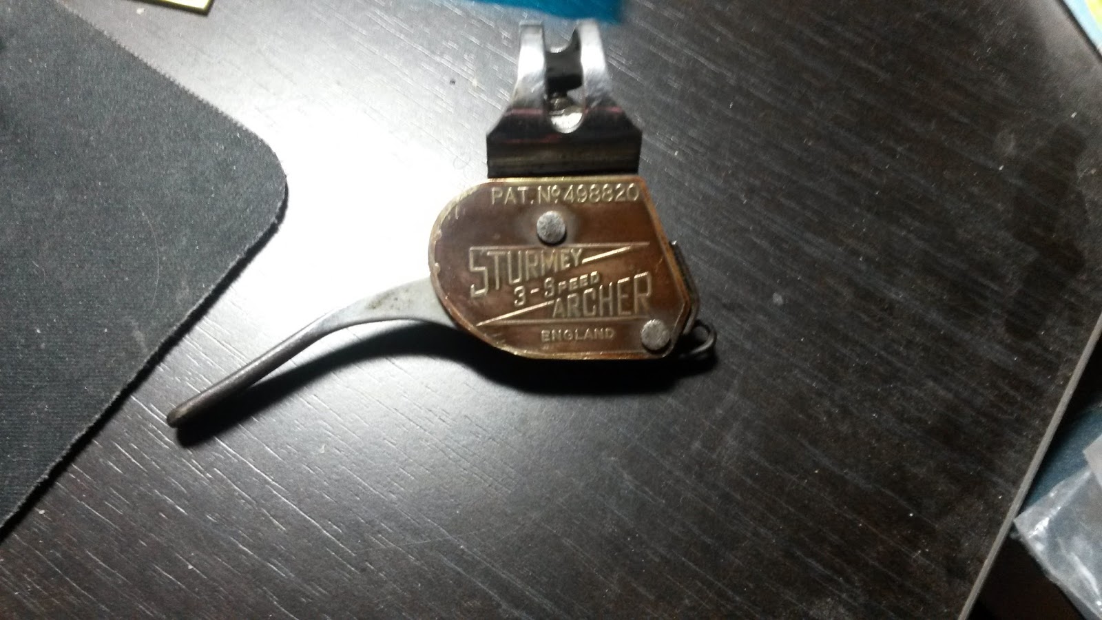

There is still something fishy about having to align a chain's outside plate with an inside tooth or whatever!!! I mean, a chain, is a chain is a chain and a chainring is a ... You get the point. You are dealing with someone who had a three-speed bike 60 plus years ago. And the first shift lever I used was much like:
Ah, the good old days.
This is not any different to a Narrow-Wide pattern. The manufacturers take care of you and you just bend a derailleur hanger...

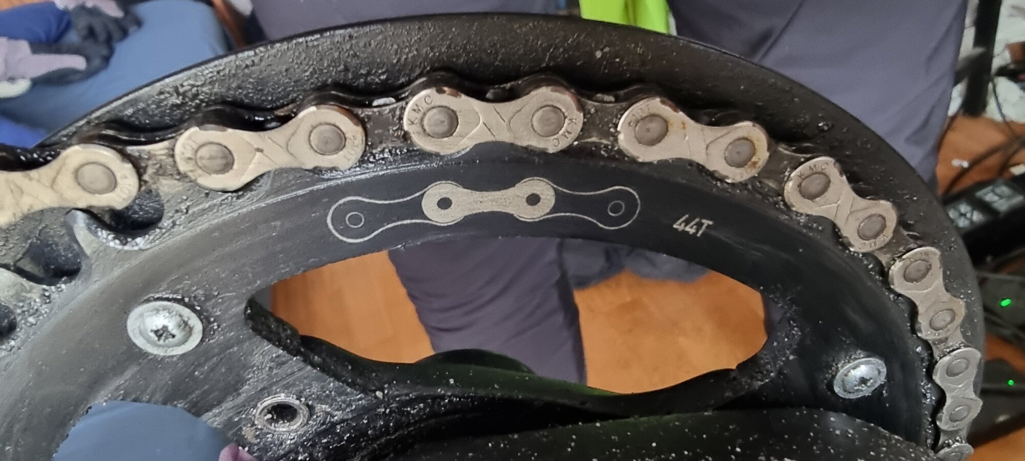

Nowadays, I need to invert my Vado SL pretty often to clean and lube the chain. It gave me the chance to actually look at the Praxis chainring, and find the diagram. Perhaps it is just the matter of experience but I do not need the diagram to orientate the chain properly now. I just look at the chain and the ring from the top, voila, done properly :) I was even surprised to see the diagram matched my chain placing there! :)

I've found and seen it. But seriously, why did they emboss it on the frame side of the ring where it is well hidden. I would think it would be easier to see if it were on the crank side of the ring. Since I deal with the chain's orientation on the rare (hopefully, from now on) occasion it jumps off, I don't necessarily recall the correct alignment. But I now carry its cute baby photo on my phone.
It is on the crank side of my Vado SL but on the frame side of Vado 5.0 (EU)!
I was wrong!!! The diagram is on the frame side! Otherwise it would be obscured by the chainguard. And that's why I could spot it when I turned the bike upside-down.
