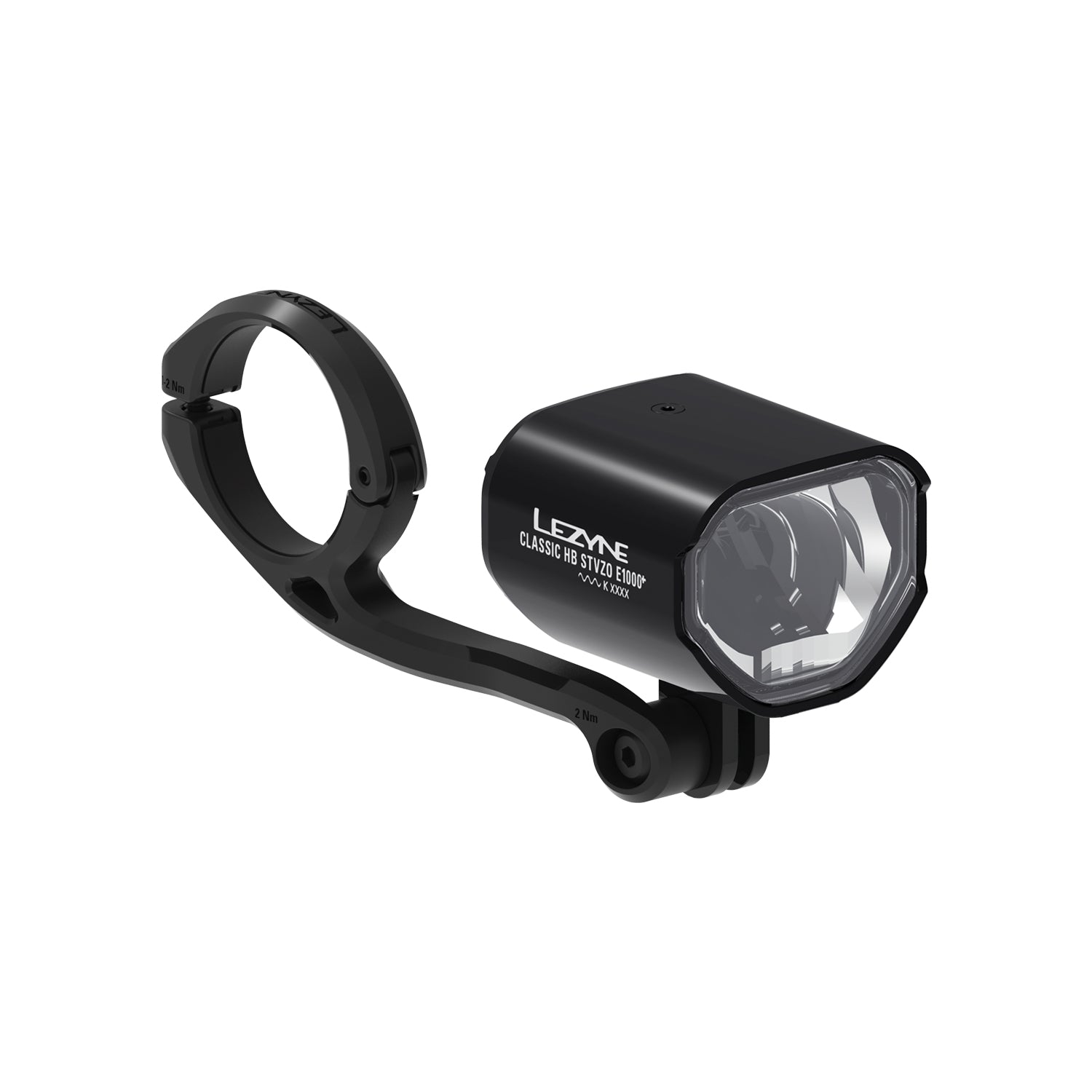

I'm considering this one from Lezyne:
It has a remote switch, which will save me the trouble of rigging a relay to use the display. It uses 12V and I can power it with the 12V buck converter I already have on the bike. Big $$ though, but might be worth it for the near plug & play setup.
