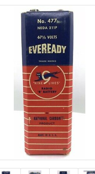

Sixty years ago, we kids would build or own tube radios that were powered by 67 to 90 volt batteries. One mean kid once jabbed me with a 90 volter. Yow, did it bite.
That old battery reminds me of this
LMAO
