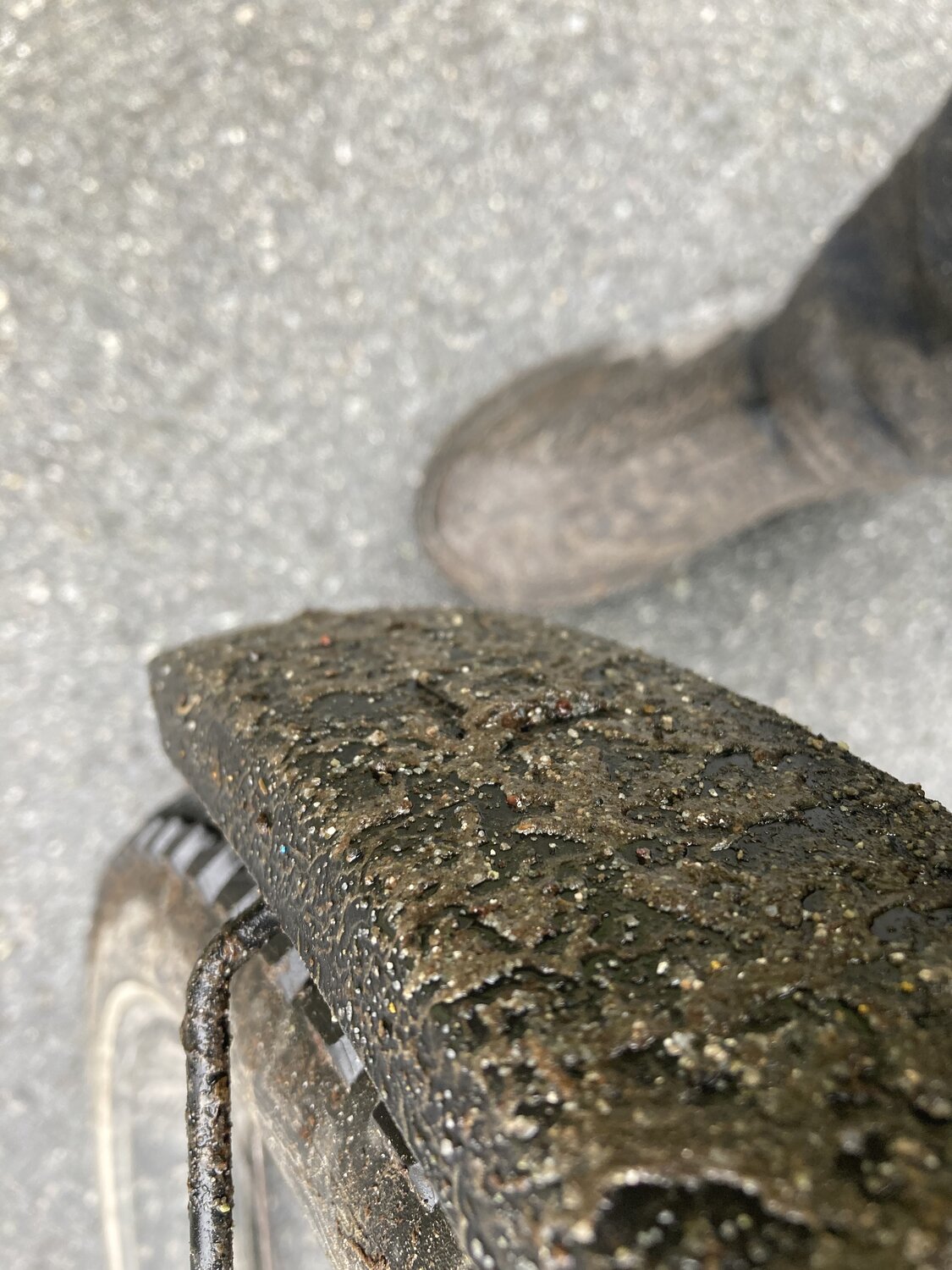

I rode for four hours yesterday on a lot of wet gravel trails which act like a grinding paste. It rained all day. The road shoulders are still covered in sand from the Winter. My point is there is no way I could make one chain last a year in these conditions no matter what type of motor I had or how cautiously I shifted gears. Maybe if I only rode in Summer on nice clean roads I could. I clean and lube my chain almost daily or every 100 km but I go through at least 3 or even 4 chains a year. This is buildup from todays' ride for example.
