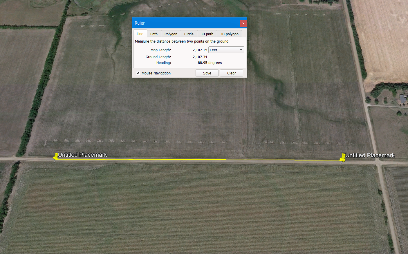

I appreciate that the distance travelled is not too accurate, but just how accurate or not is the distance travelled as shown on the e bike screen
Thanks
With my wheel diameter set to 29" (actual is 28.8"), my speedometer and odometer are approximately 97% accurate compared to a GPS speed app on my tablet and also my phone.
For the most accurate wheel diameter selection, you need to measure your rear tire's actual circumference in inches, then divide that value by 3.14159 to get the correct wheel diameter for the most accurate speedometer calibration.
Lay out a tape measure up to approximately 100", then rotate your rear tire until the valve stem is directly at the bottom (6'Oclock position), align the tape measure end with the valve stem, then sit on your bike (tire deflection from your weight will affect the diameter slightly) now roll forward one full revolution, until the rear tire valve stem is back at 6'Oclock, and note the corresponding value in inches on the tape measure. My 27.5" x 3" tires circumference measured 90.5" which calculated to 28.8" diameter.

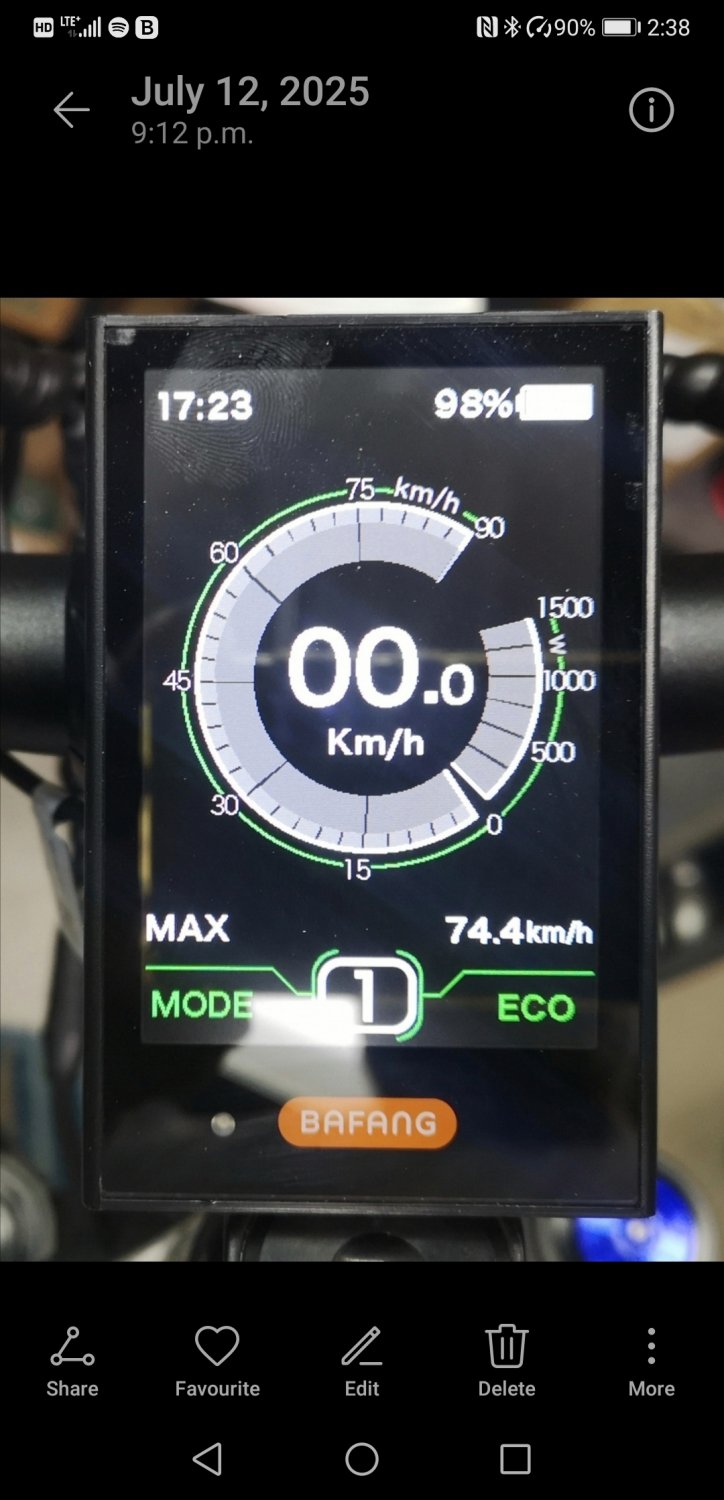

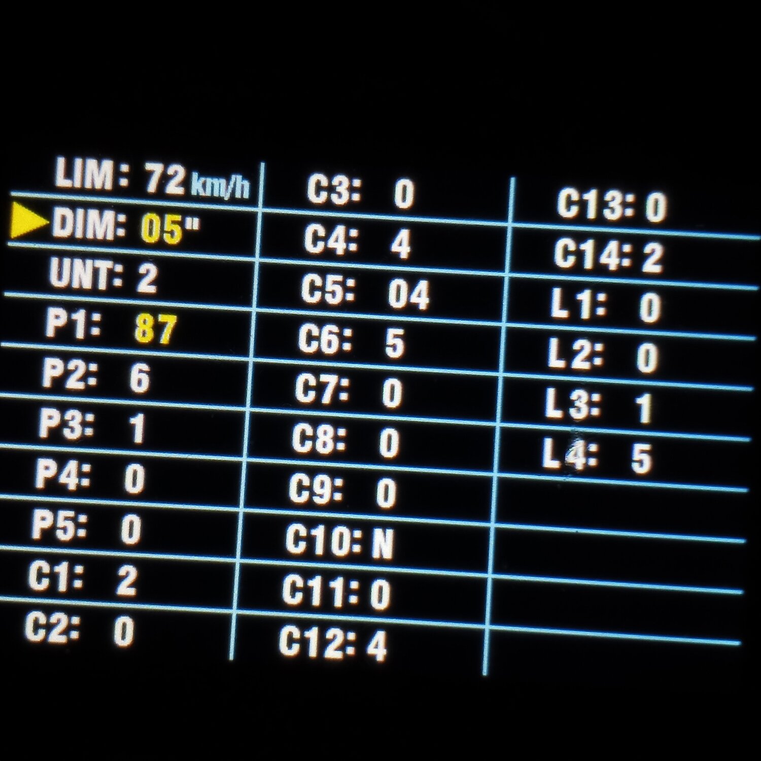

In your controller programming settings, on the "Basic page" where you set the wheel diameter, try changing "SpdMeter Signal" (# of speed sensors) from 1 to 2. That should trick the software into calculating 2 wheel rotations as a single wheel rotation, which will trick it into interpreting the calculated speed as 1/2 of the actual speed. Your speedometer will likely be reading 50% of actual speed as well, but you should be able to have assist up to 64km/h.
I ordered my bike and selected "off road use only" vs 20 or 32 km/h speed limit. The display speed limit came set to 90km/h and the only speed limit in the software was on the "Throttle page" where speed limited was set to 40km/h for the throttle only. All the assist levels speed % were 100% and the pedal assist speed limited was set to "by displays command", so the display speed limit has priority for pedal assist. I set my wheel diameter correctly in the display and software by measuring the actual distance travelled from one tire revolution (wheel circumference 90.5") then dividing the result by 3.14159 to get the wheel diameter of 28.8" (set to 29" in display and software). I changed the "Throttle page" speed limited to "by displays command" and set the display speed limit to 72km/h. I am able to get up to 60-65km/h on flat roads and nearly 75km/h on short downhill descents where the pedal assist and throttle assist remain active.
