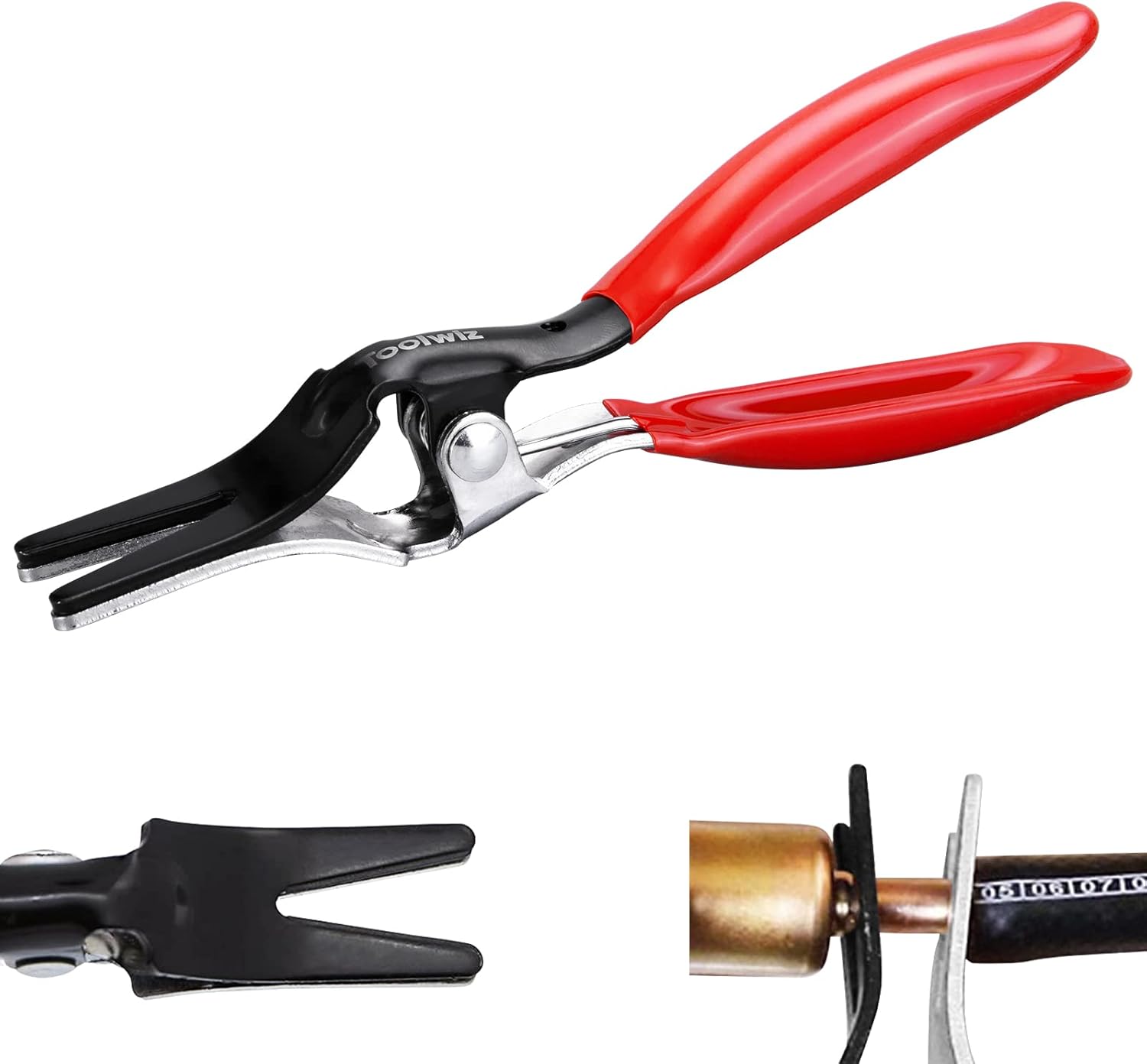

I replaced the controller on my Aventon Abound. Generally, I find e-bike connectors difficult to disconnect, and this was especially bad. Vaguely I remembered a tool. Later I remembered what it was: my hose removal pliers. Using them might require me to put some sort of hose clamp on each half of a connection for the pliers to pry against. Besides, putting connectors together can also be difficult.

I have used silicone grease on e-bike connectors, primarily so I can make and break connections a little better, and also to help keep them weather tight. There's still plenty of friction. Is it a good idea?
