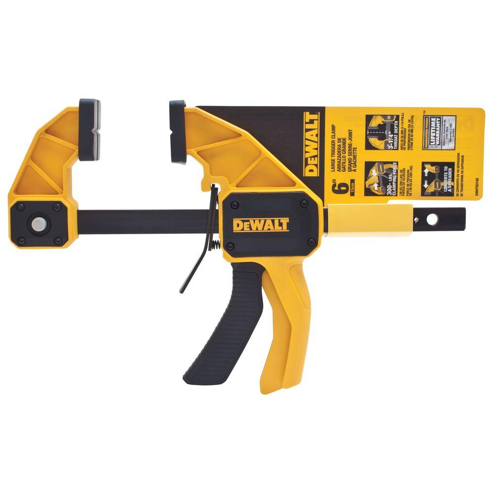

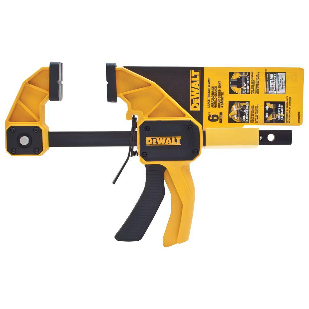

I've also learned since that the trash can trick can also make installing difficult tires a bit easier. The key is pinching the tire's beads into the center of the rim on the opposite side from the last part you're trying to slip on. This can give you a few extra millimeters of room to slip the bead of the rim's edge.
