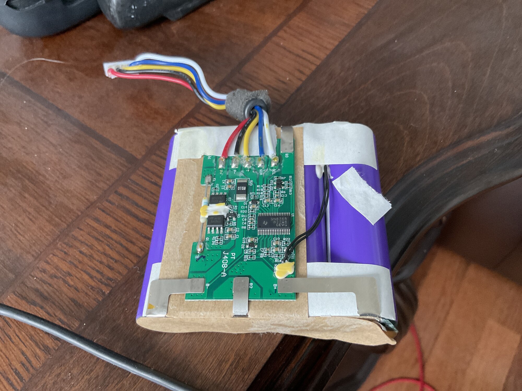

Hi,
I have a 14.4 battery pack for 1 of my blue tooth speakers. The cells are old and no longer useable. I would like to replace them. I do not have the ability to do so. What kind of assistance can I get ? Someone I can ship this to to do this ? I don’t have any special tools for the welding/ soldering. Could I do this myself anyway? What can I do to help make this happen

Not an ebike battery just 4 cells . It could be carry on like a laptop battery. But the cells are attached to the board, maybe replace the individual cells ?
You need electrical skills to replace the cells. If these are 18650 cells (18mm in diameter and 65mm long), they can be purchased with nickel tabs already attached. Then the existing cells could be snipped out of the battery, and the new ones soldered in place.

Not trying to set a fire , not even wanting to do this myself , happy to pay just don’t know how to get it done. Only way to make it portable again is to replace this battery pack that is no longer made or get this repaired/replaced cells.
I have 2 , both need new cells at least I assume.
I am happy to get it done correctly/legally if I can . Next choice is find someone with the ability to get this done correctly anyway I can
They have 4 cell 14.4 v packs that end in 2 wires but need the small board attached, not a simple task (for me). Is it easier to replace the individual cells? Again both choices above my level…

Note that the connector has 5 connections
That is most likely because the charging circuit monitors the battery pack, including the temperature. The two black wires going between the cells on the right is very likely a thermocouple to measure temperature. Good systems monitor for both high and low temperature. The replacement cells need to be the same chemistry and physical size. It shouldn't matter if they are higher capacity. Hopefully you can find someone to do the work for you.
