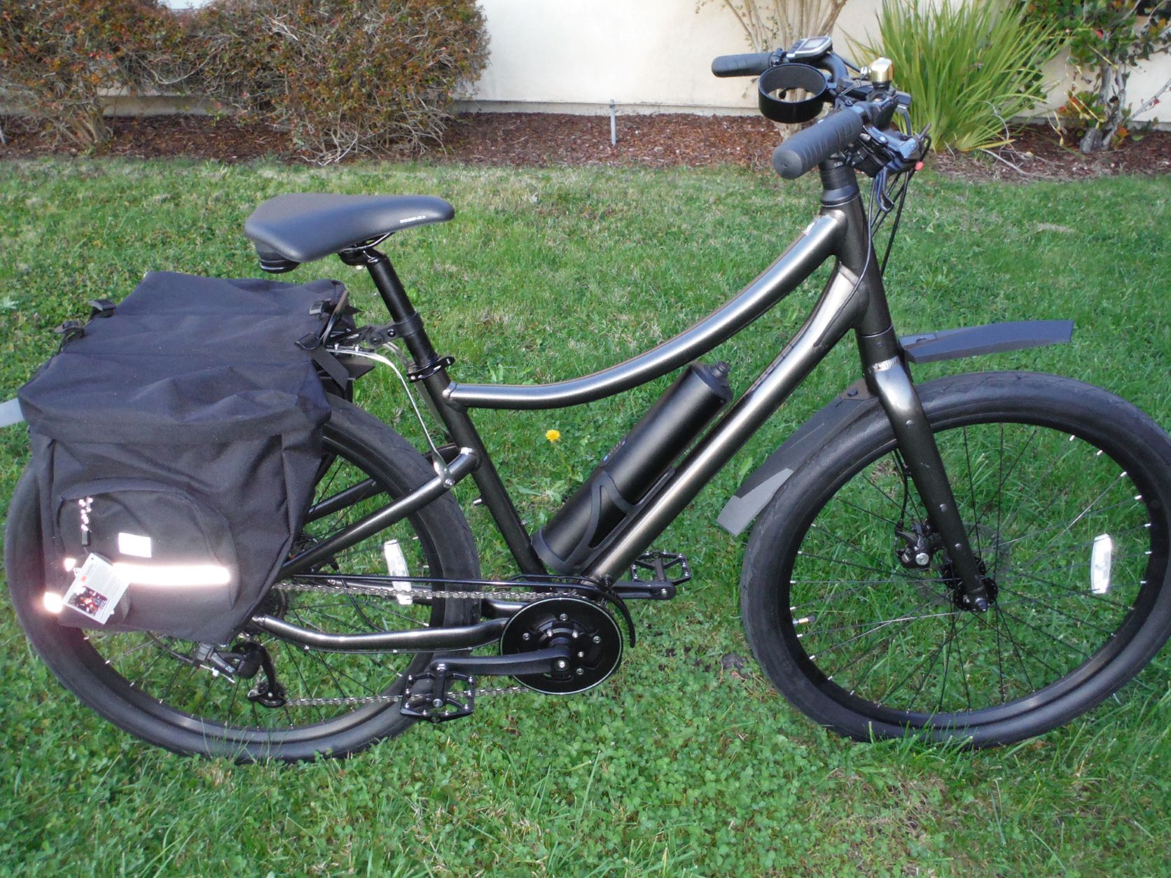

I expect that there is a short in the wire to the controller from the display and maybe the thin wire to a light. Inspect the connections closely and also the wire to the speed sensor, oh, what is the voltage to the speed sensor, 4.9? The wires to the lights come from a splitter to the speed sensor. For the most part I quit using light kits and speed sensors years ago and brake cutouts. I use USB rechargeable lights. Here are two builds form last week. I like to dispose of wires and connectors to the extent I can. The voltage drop and the quick discharge are good clues. You may even feel a warm spot at the short.
