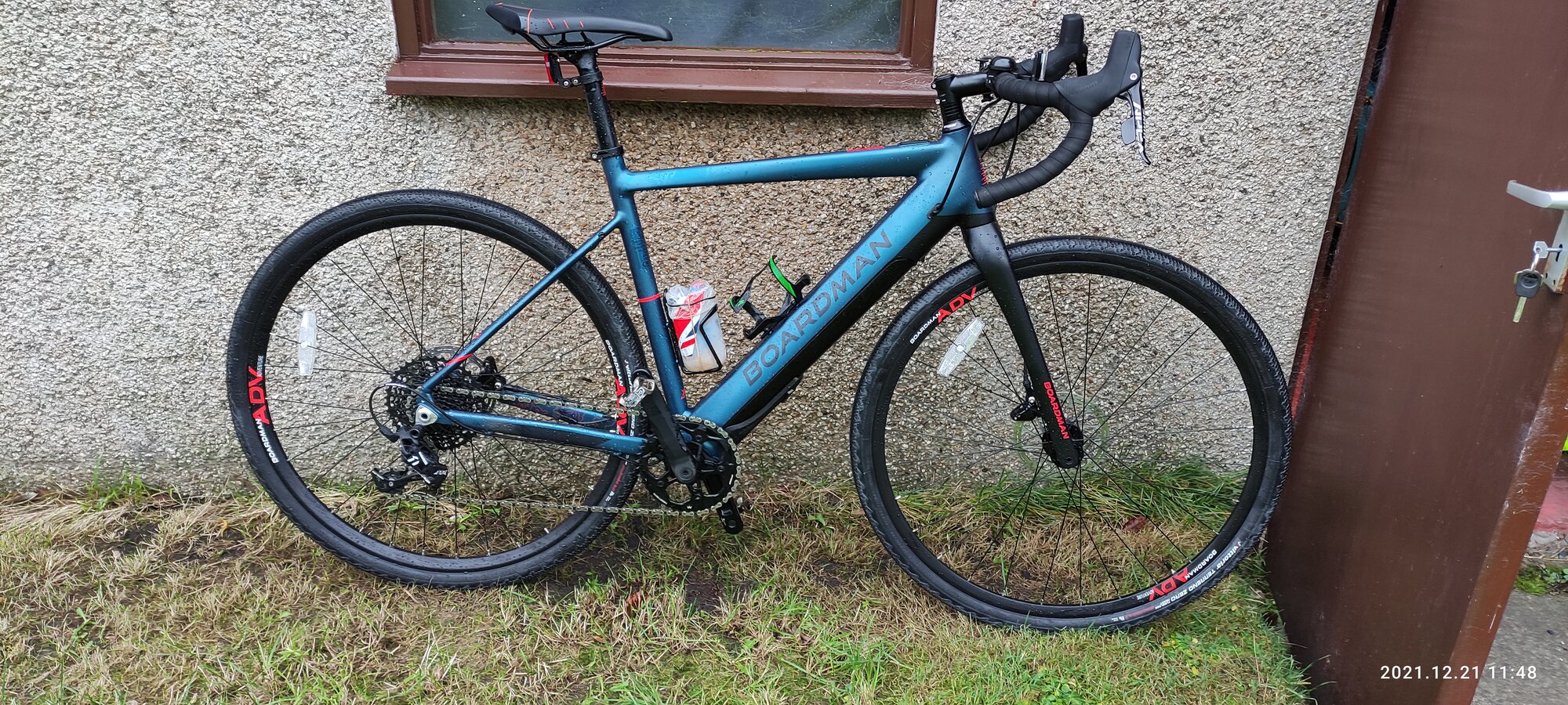

Short Version:
Just to round this off after a longer test ride of the Bosch motored Cannondale Synapse and an Orbea Gain – neither of which felt right, I bought a Boardman ADV 8.9e! with the Fazua motor :)
Long Version:
The Cannondale did well on the climbs, but motor felt quite draggy and the weight of the bike was really noticeable once above its cut-off. It could build up and maintain speed on the flat (and downhill), but was hard work slightest rise and was slower over my the half of my commute I tried it on(compared to an average day), despite being a few seconds faster than my best time up the hills. It is also a long bike for a medium, which I really felt when pedalling standing up.
The Gain was a bit of a nightmare: the motor was just not working on the Gain and I got a double pinch flat! The bike itself rode OK, not too much drag, but with the motor apparently AWOL I only had my short ride on the Vibe as a comparison, which did not feel like it was helping much at all – it was, but it was barely noticeable. The other downside was that there is no option for having a second set of wheels if I wanted swap between sets of tyres – commuting and winter studded tyres.
At this point I was not getting an e-bike, but had still to try a Fazua equipped bike…
Cue visit to Halfords as they were able to order up said Boardman ADV 8.9e in for me – the test ride was going to be shorter so found a slope nearby and rode up it on my commuter as a baseline, trying to put a perceived average effort in. Then I tried the Boardman with no assistance, minimum, medium then max, followed by a couple of mixed settings. My legs had clearly had warmed up a bit as with no assistance I was a little bit quicker than my commuter, so not a lot of motor drag. The other 3 modes saw me progressively faster with the last one maintaining 15mph up the slope and you can definitely feel it helping in all modes.
It still wasn’t a done deal but after much umming and ahhing I bought the Boardman – I like the fact the battery and motor could be removed and replaced by a blanking piece that double up as storage as this is the bike I’ll use for bike touring, as well as liking their whole system concept.
Took the bike out for a trial commute: The hill straight from my door was dispatched with so much less effort it was great and I completed my out and back “commute” (36 miles) in about 5-10 minutes faster (each way) than the previous week and still with 25% battery left – that was mostly done in medium, switching to max about 2/3rds of the way home as I was starting to feel some of the effort. Bike got me home in good time again, despite lack of energy on my part, so will definitely work on the days where I just can’t be bothered and I’ll still pedal rather than take the motorbike. The only thing I wasn’t sure about was that it felt like that there was a bit of drag from the motor when it initially disengaged, but that could be just that my legs are needing to get used to the switch over to providing all the effort and that I was possibly a bit fatigued, there was no problems when going that little bit faster.
Only change on the cards is a bigger front sprocket, the 42 tooth at the front was running out on the flat and never troubled the upper half of the cassette on the climbs. Throwing a 50 in as that still gives a reasonable climbing gear (better than current commuter) as well as better speed gear (Again better than the commuter) – this is also an advantage with the Fazua system, it does not need a firmware update to cope with the change.
