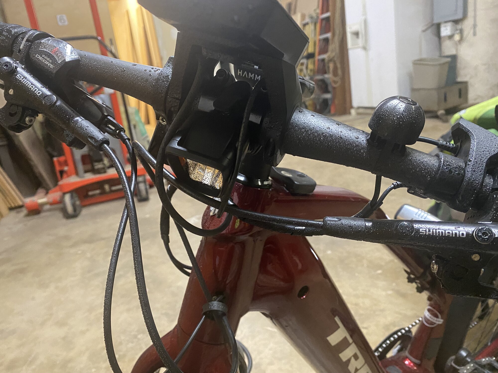

the nyon straddles the riser so there may be plenty of room. here is my Trek with its light and the nyon.
Thanks, that might just work.

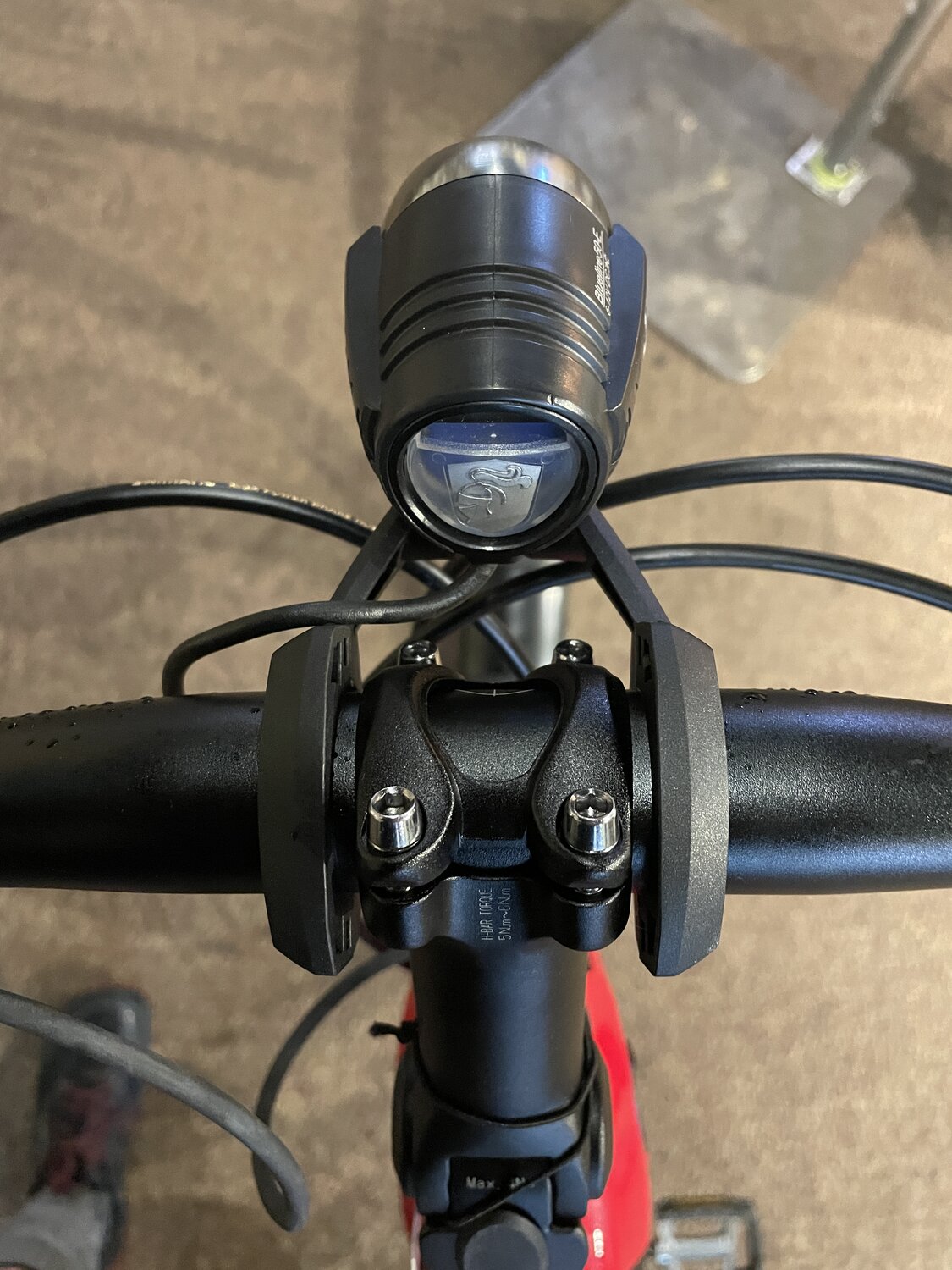

here’s a picture of my bracket now.

Not sure with one leg off the Nyon mount if it will be strong enough to support it properly.

outside its 3.1 and inside 2.4" but the light looks almost the same size. no I meant take one leg off the light mount and mount it the outside of the nyon mount. if it does not feel strong enough you can put a screw through one to the other easily.
I have the kit here now, still waiting for the bike to be delivered to my LBS.
I will be mounting the Nyon outside of the headlight bracket.
the headlight bracket is 64cm and the Nyon is 60cm. I will have to trim the outside of the headlight bracket 2 cm on the outside of each side. Should work fine.
