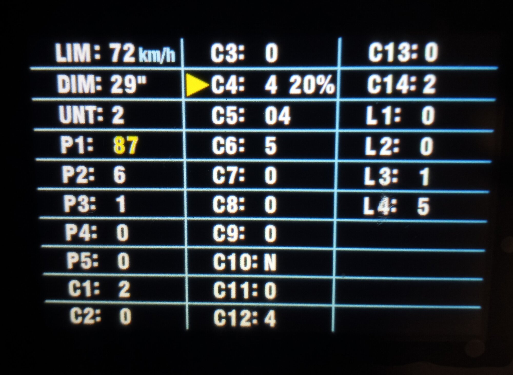

On my LCD3's, P4=1 and C4=4 give me throttle always on. I've only got that set on one bike. I prefer it off in peda; assist 0.

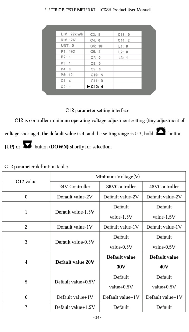

now having a range issue where the display rapidly goes from 52vish to 40v and shuts off after only a few min of riding, yet if i reseat the battery it reads 48v ish on screen and on battery indicator still full 1red 3green !!! and does same again and again cutting off and reseat says still above 40v !!! after maybe 6 times n iv come home, battery still says 1red 2green at least.
is there a way to permanently disable the lcd8h displays cutoff (iv tried real time and smart V settings) on the lcd8h, or is there a cheap display like lcd880 i can fit that doesnt do the low v cutoff, but allows spped setting over 15mph ?
thanks for assistance hoping to ride more once fixed.
You can turn down the low voltage cutoff to 38 volts using C12=0

I have my 25 amp controller turned down to half and also have C4=4 and turned down to 20% for throttle gear 1, so only 2.5 amps in first gear.
Even with everything turned way down, my controller starts cutting out when I hit 42 volts because of voltage sag bringing down the voltage down to 40 volts.

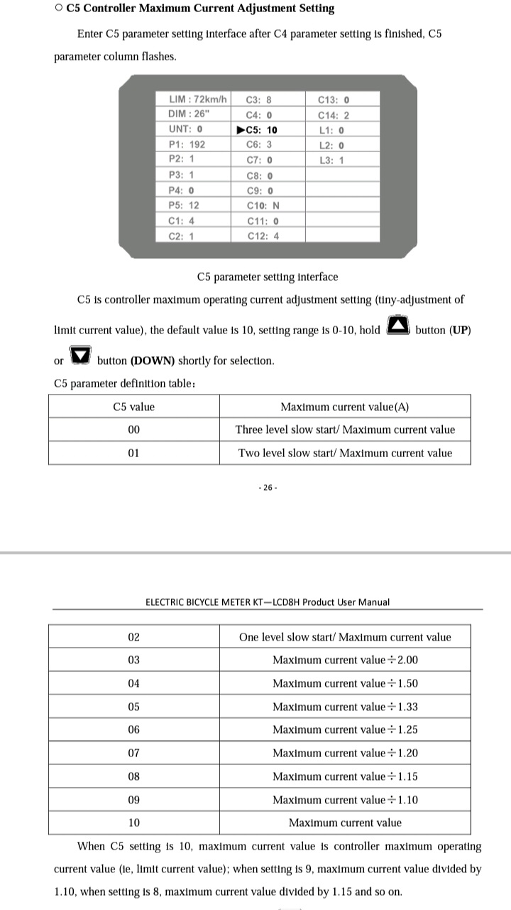

what setting is for turning down controller ?
C5=3 cuts the power in half.
Limiting your power output will help keep your controller from cutting out, but you'll be slower with less acceleration.
