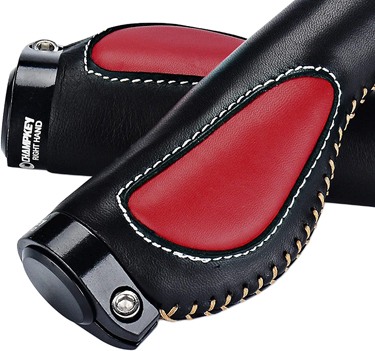

Or ditch the old grips and buy cool new leather clamp down style ones.
They are easy peasy on and off.
Buy a whole bunch of clamp down grips.
Now you can choose & change your grips to
suit your mood, diversion or scenario.
My right hand grip is shorter (because of the throttle). Can you shorten one grip easily?
They exist in short version for that purpose
