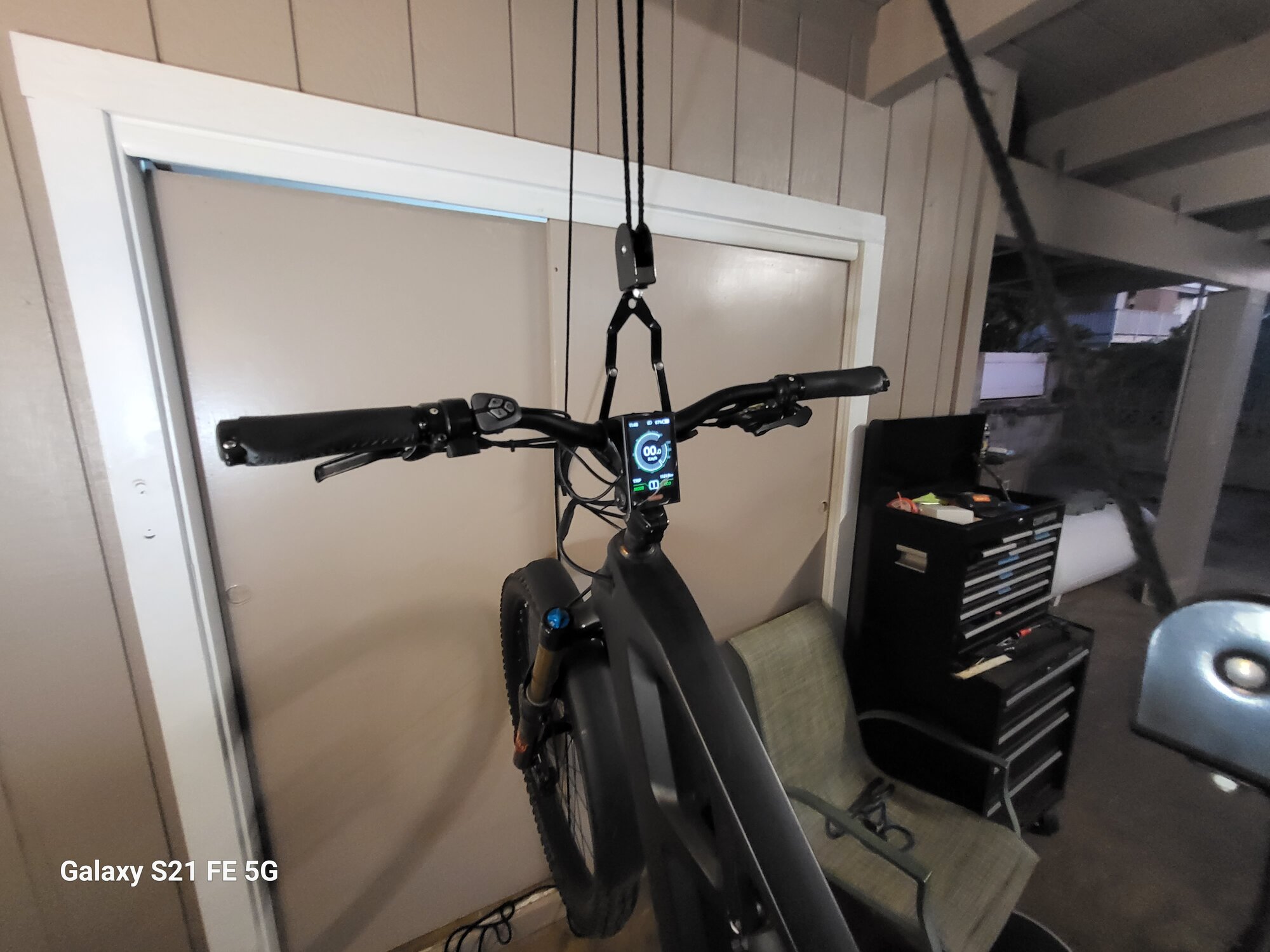

My bike's handle bar.
It does not drop it's glued and bolted.
Grips are $30 Brooks knock off genuine Tamaraw leather.
