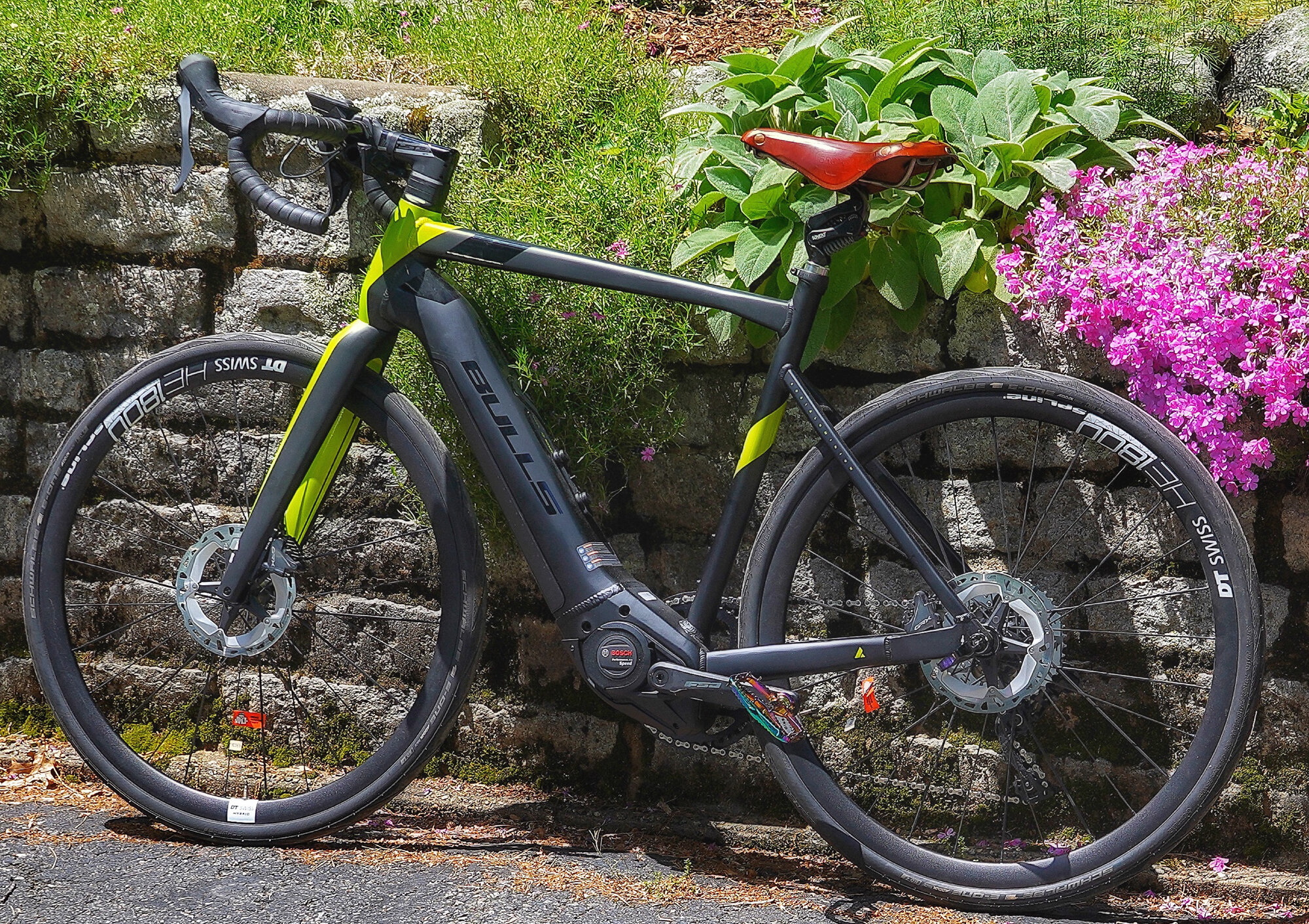

You might want to look at the Bulls Desert Falcon EVO . I have it….I love it.
I have a thread on the review in the Bulls forum….versatile class 3 with Di2 electric
That’s a pretty bike!
