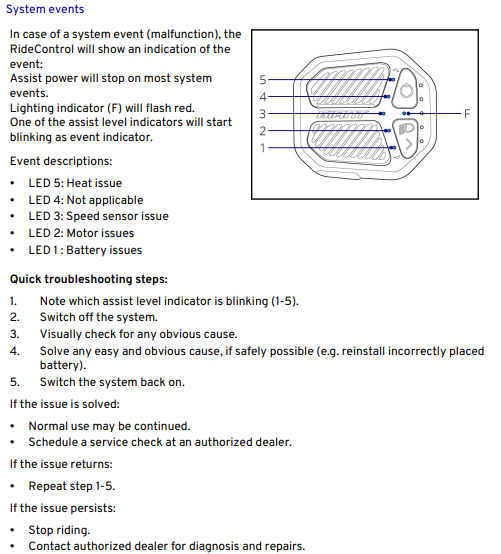

You should still get fault codes on the RideControl One:

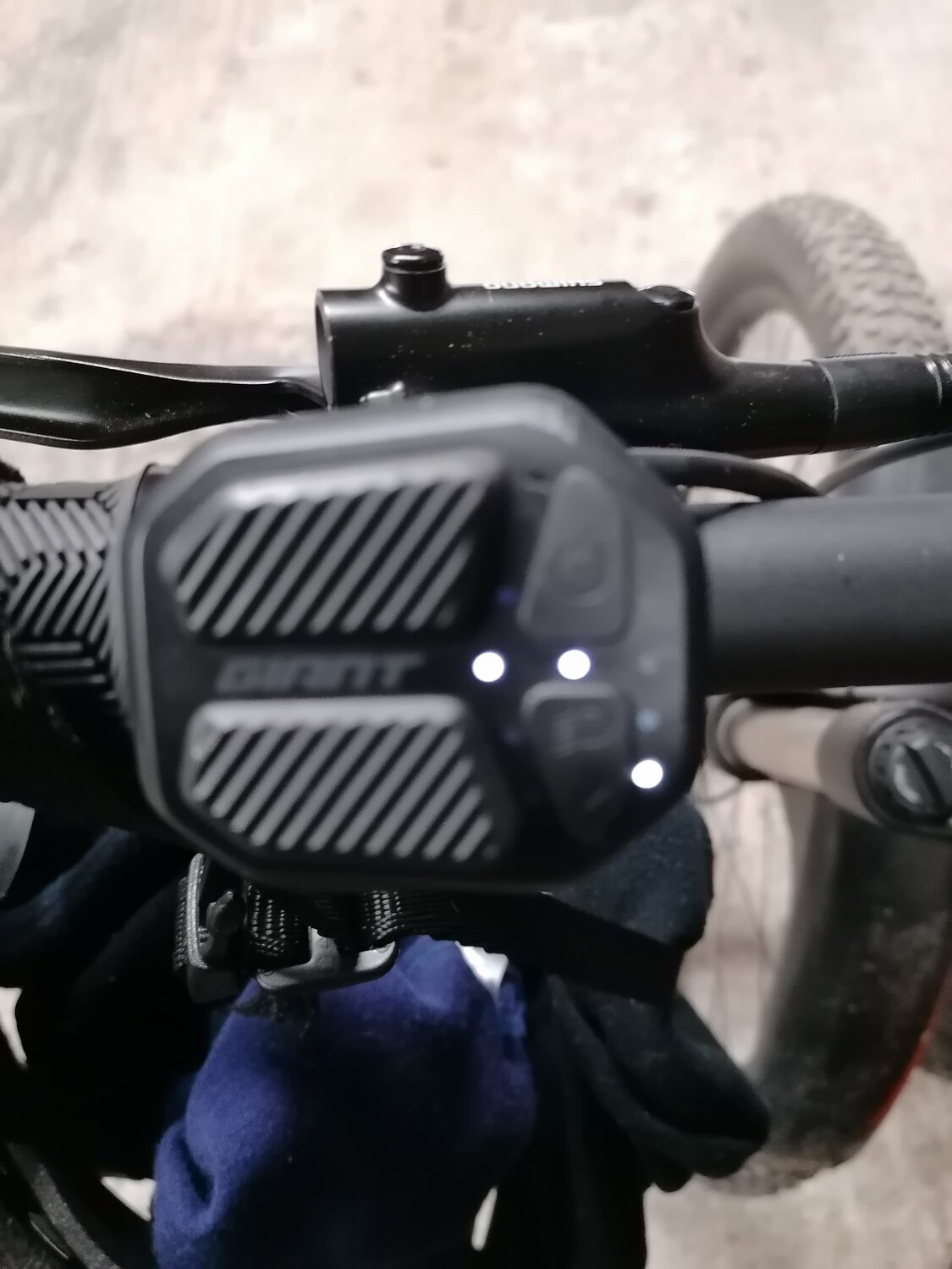

I read the instructions to confirm I have no red light fault. I have noticed the light button is lit when I switch it on. I switch it off and it comes back on with the next power up.
I have always ridden the bike in manual mode. Tomorrow will try auto mode to see if its any different. I have attached a pici of my display when I switch it on. I recognise me battery is low on charge. Its charging up now.
