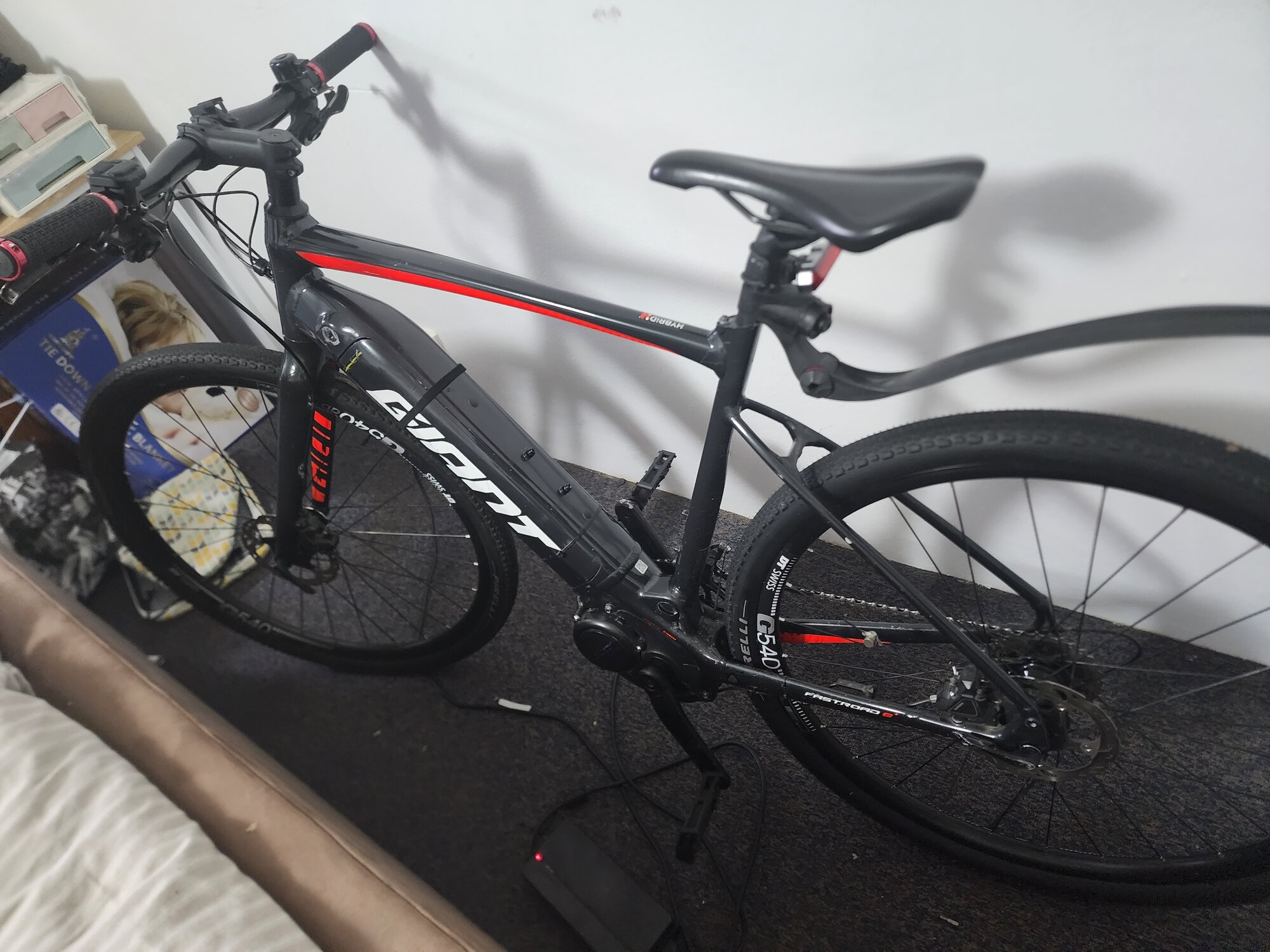

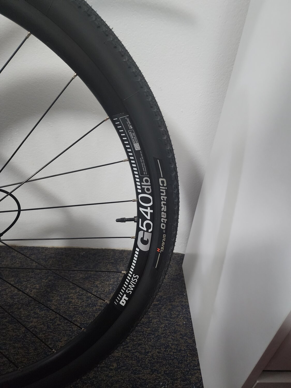

My gx rim cracked and a broken spoke replaced with swiss rim tubless 45mm perrelli gravel H on the back and same but 40mm on the front what a difference smooth ride lots of grip all my riding is done on the road

Oh it's a fastroad e plus2 2020 came with gx rims and 32mm tyres very harsh ride
